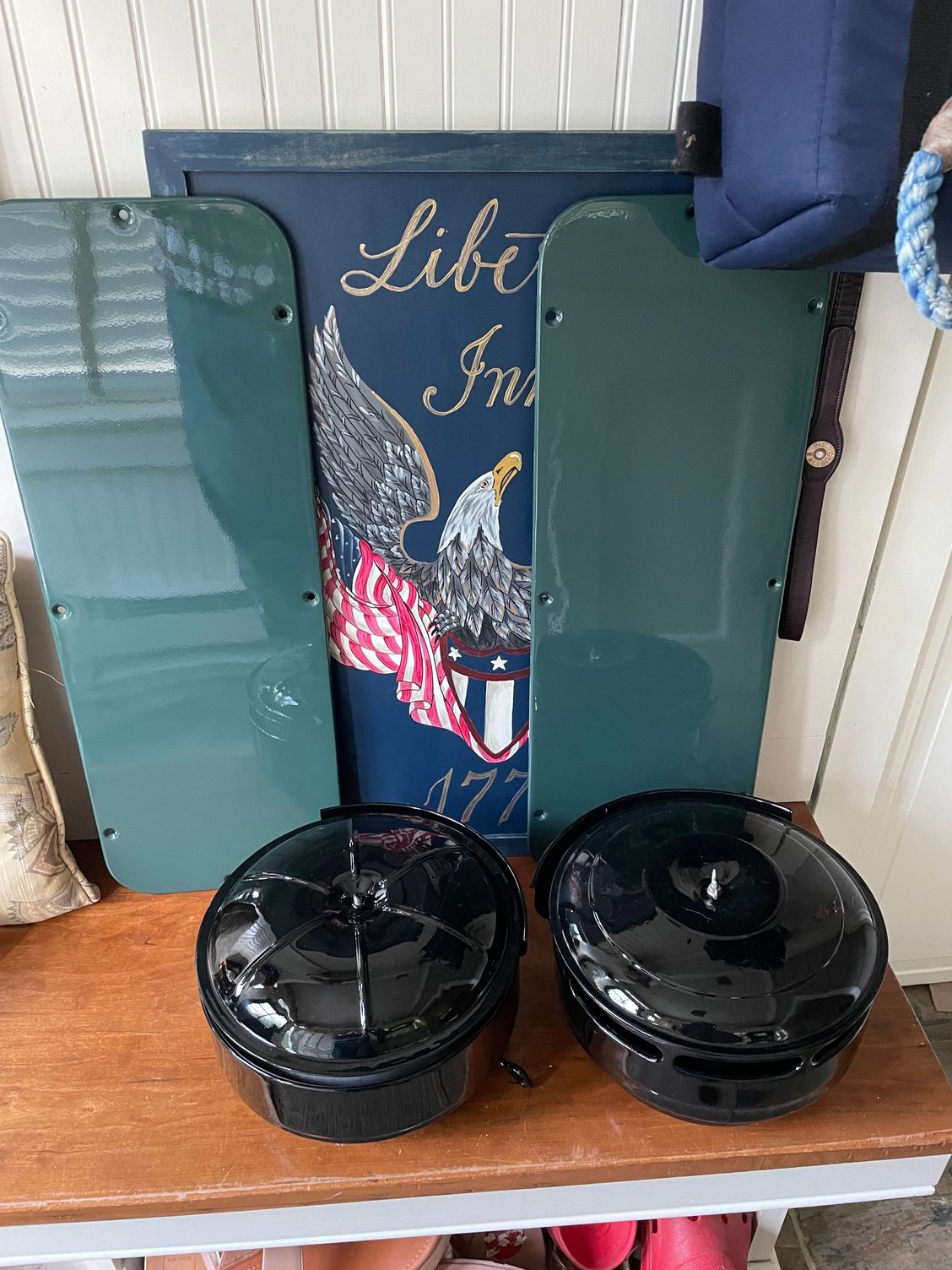

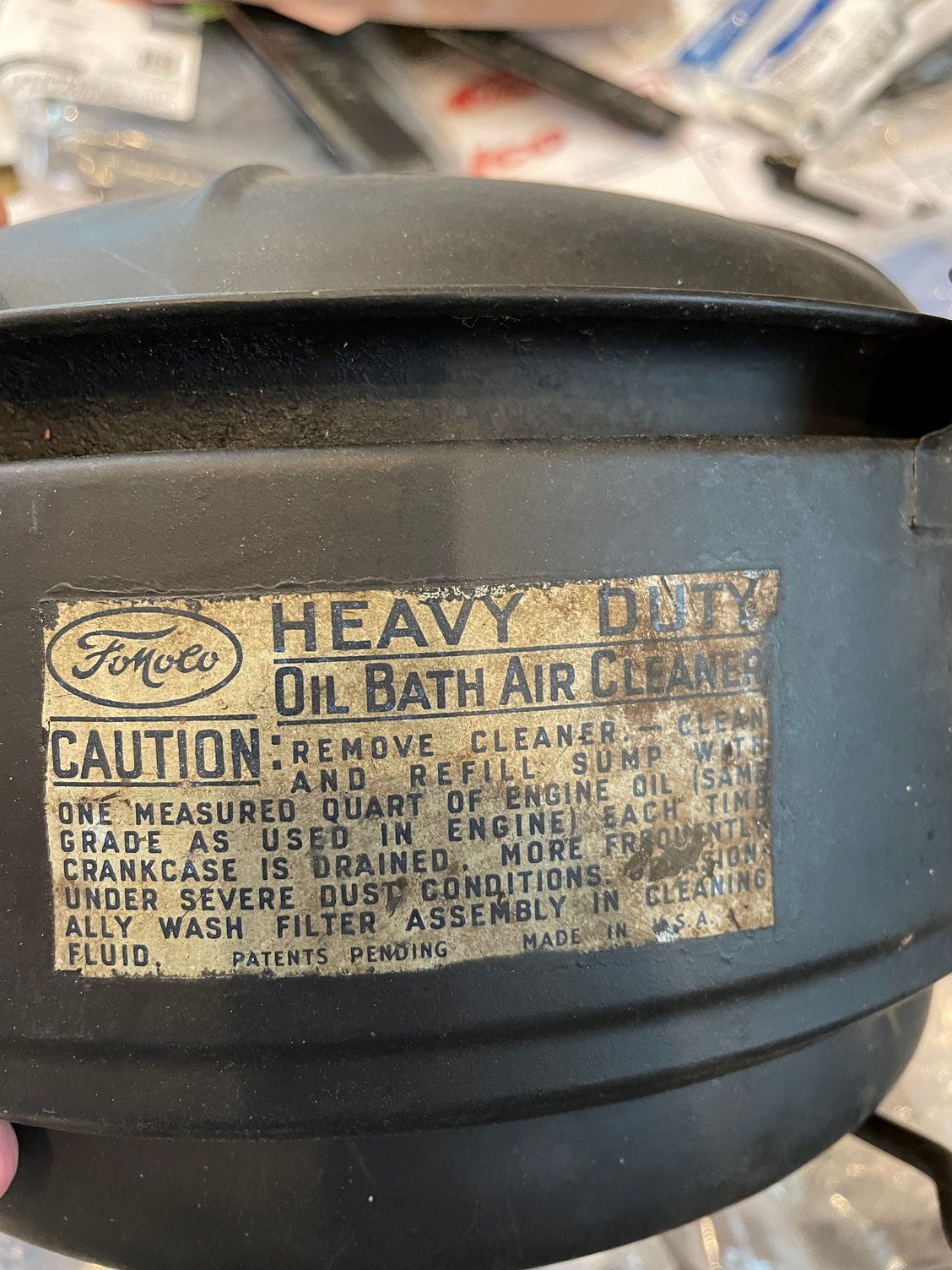

I know the later version to left in the picture are usually 52’s earlier ones are the concentric circle design were in trucks even up to 51. The one to the right is fairly easy to find on eBay as I think they were produced longer.
Concentric circle one

It looks like they all had wind breaks. If I follow you correctly the one on the right in the 2nd photo is what I need. Yes?

Yes, I believe that is the “style” that is correct. eBay usually has a few sellers that list them as “truck” air cleaners. I’ve found all of mine on eBay. Or try Chuck’s.
I think the later ones are just more closed up from dust, thus the Heavy Duty label?

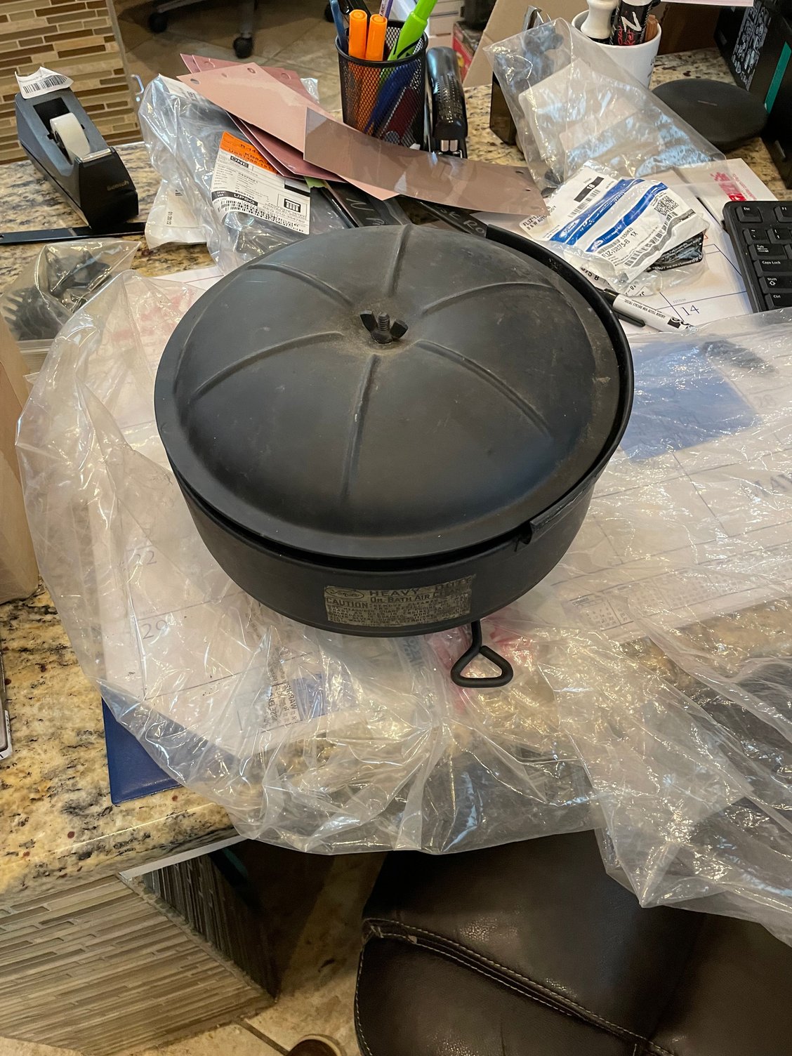

This is the one you want although the price is very steep it has been cleaned/ primed.
https://www.ebay.com/itm/11643111756...mis&media=COPY

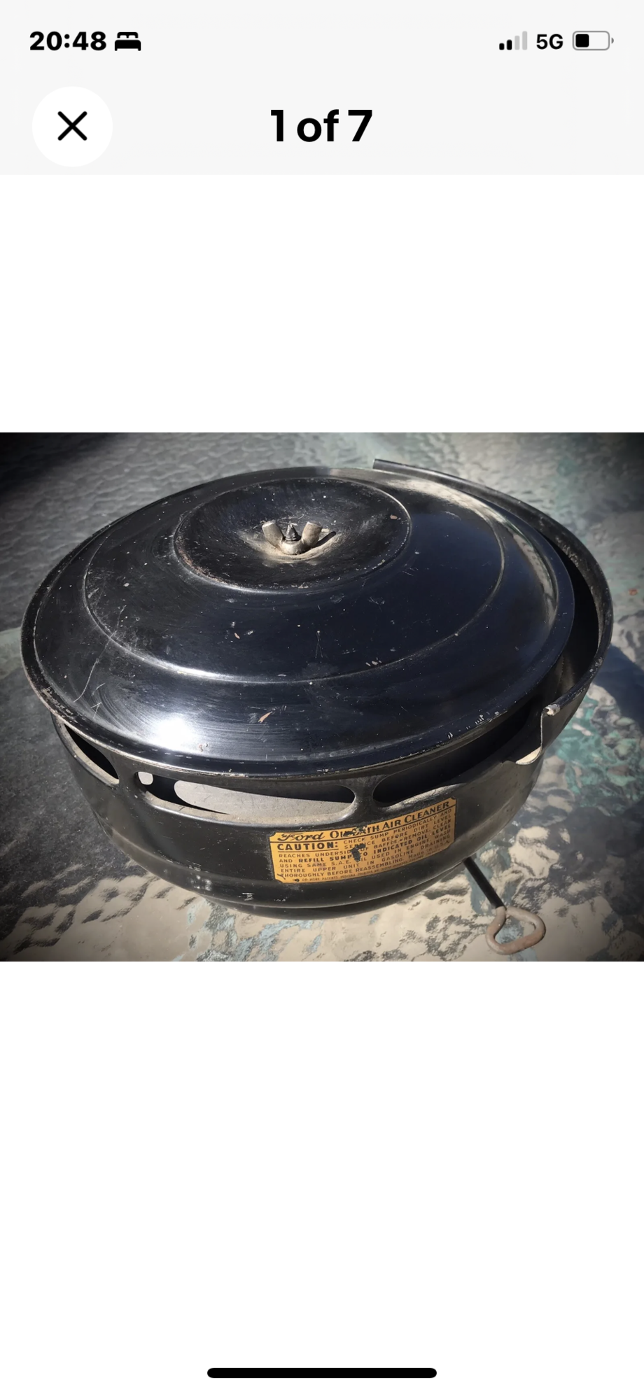

The later 1952 HD FOMOCO
https://www.ebay.com/itm/14635186595...mis&media=COPY

Double check the carb opening on those cleaners. The one with the spider lid looks like a 6 cylinder and the bee hive style is V8. The 6's use a smaller carb neck and won't work on a V8.
good idea I always ask the sellers to measure. I think one of those listings has a tape measure on the opening.
