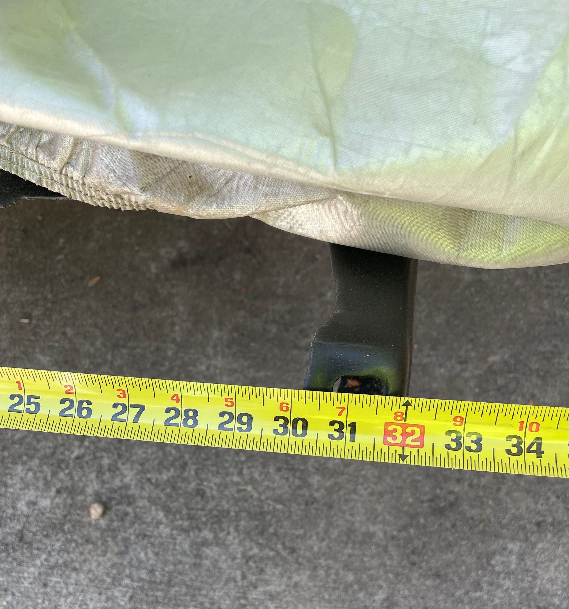

My 1975 f100
1/4"

Looks like specification for the radiator core support mounts (those big holes) is 32.04 inches apart center to center, 30" sounds about right if measuring inside between frame rails.

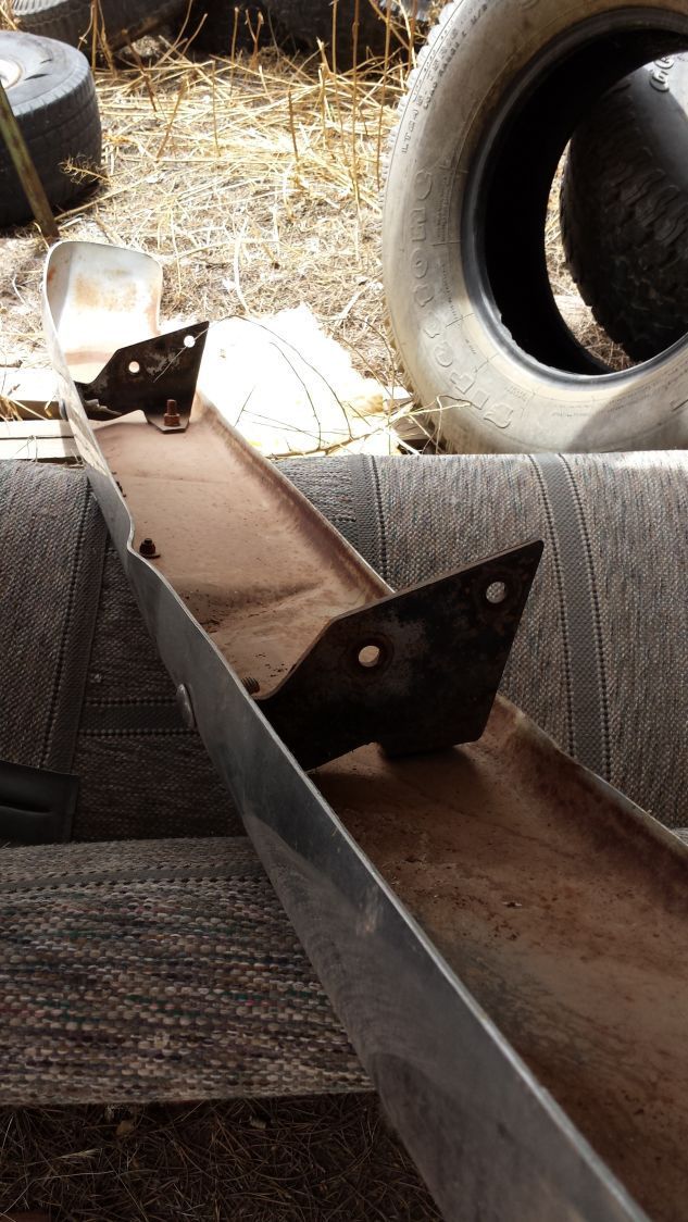

As I understand it a 67-77.5 4wd F250 High Boy front bumper, uses these brackets.

Mine is a lowboy.
Old Apr 15, 2025 | 09:47 PM
77&79F250's Avatar
77&79F250
Moderator & parts slinger
Posts: 50,247
Likes: 5,815
Yes NO brackets used on a LB.

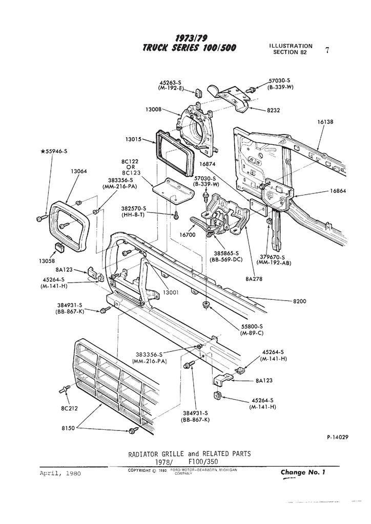

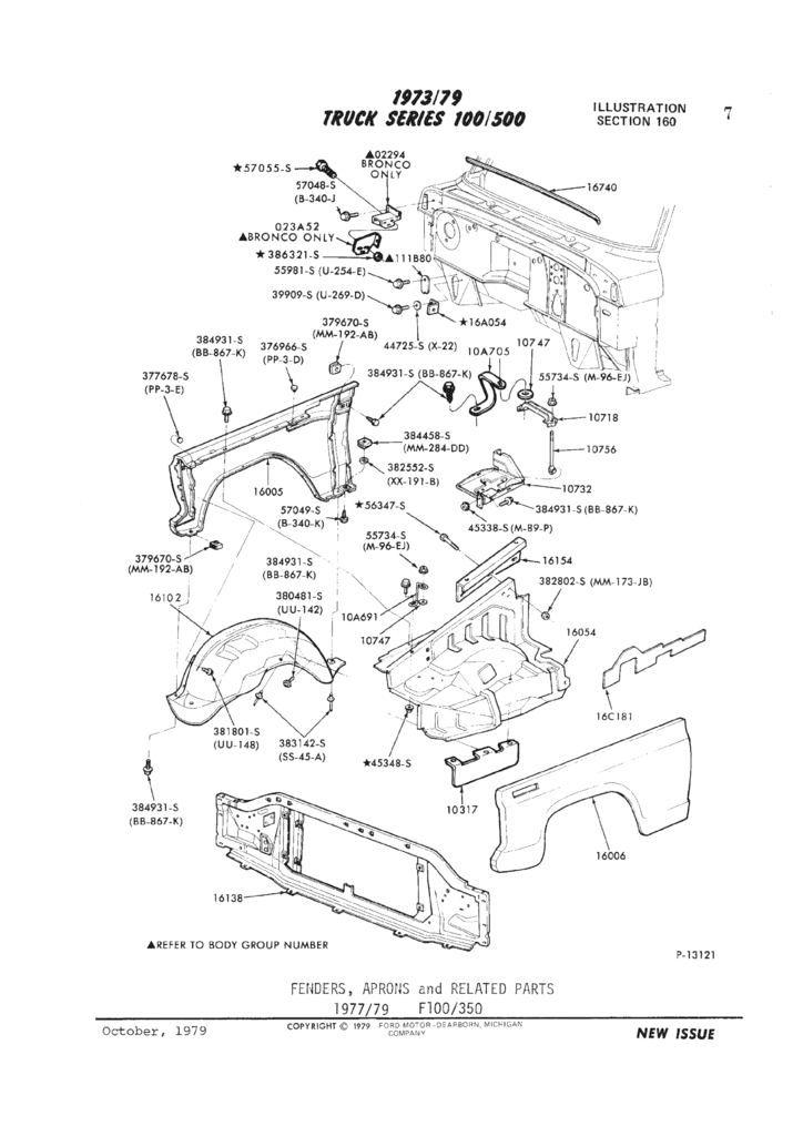

Do a cross X tape measure check and burn it in. This is an EXAMPLE below of the X measurement check using a early Bronco diagram for the X. Sorry I do not have the X measurement you need.
What did you cut out and why do you think it shifted? I mean if you think is shifted, you want it 100% ck it before you weld it home. Because once welded and it dog legs after you put it back together, you can chase it to the end of the world. But is the frame is "off", no way to shim it, unless it goes on a frame rack with chains and hydro's.

Thx for the extra pics. I'll grab my core support and check the distances between mounting holes. I need to break the front clip apart anyway for cleanup and paint. I don't know why I didn't just measure it from the get go instead of asking here. :braindead:
