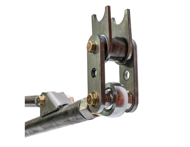

I need to get some bars for my truck. Always wanted them on my 2018 that axle hopped bad, but never pulled the trigger.
I'm thinking about making my own. If you use a shackle at the front mount, the axle can still move forward and backward some following the natural arc. And the heim joint will let it pivot. Prevents axle wrap, and allows flex offroad...best of both worlds...
I can see that working for axle wrap prevention.
in my case...I have th HD versions of the sulastic shackles which work great at low and medium sspeeds.....but once you get to 65mph and start hitting the road caverns that trucks cuase into the roads....the turck will snake dance pretty bad. I called sulastic about this and they said add preload...which I did...and the snake dance at high speed caveren dipping stopped.....then about 10 month later I noticed the extra preload had reduced some clearences in the sulastic HD devices and cuased wear on a crirical bar.....called sulastic about that and they said oopsy...you should not have added the preload. so in review...my previous truck setup with sulastics had traction bars...the traction bars were long tube bars and they precented left or right independent wheel advancement ...so the shakle type track bars would not work for me.
when I do the track bars mid may..plan on adding a washer or two on the sulastic springs frame mounts to try to increase the clearence at the trouble spot. and maybe get the damaged bar welded. so right now..the preload is rolled back to where the snake dancing was occuring....so that means until I get the traction bars in....need to keep it below 65 if the roads have tractor tralier crevasess.

The solid bars will definitely prevent axle wrap as the axle simply cannot try to walk forward. For articulation, they hold the axle in a constant arc of motion, which with leaf springs means the spring will bind a bit as their motion is not in an arc. This limits travel. Not really important on a pavement rig.
The S&B (OUO) bars have a bushing on the front that allows for point of rotation and will provide some give fore or aft in the axles arc of rotation. These will limit articulation less that the solid bars.
The traditional shackle traction bar (ladder bar) give an obvious point of rotation and allows the axle unimpeded articulation as the shackle can move. Spacing of the bracket on the axle is important and keeping the top bar as horizontal as possible is also key. This will reduce axle wrap and allow the axle freedom to articulate. More complicated to install and you will likely need to build a shackle mount off the frame.
