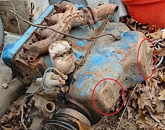

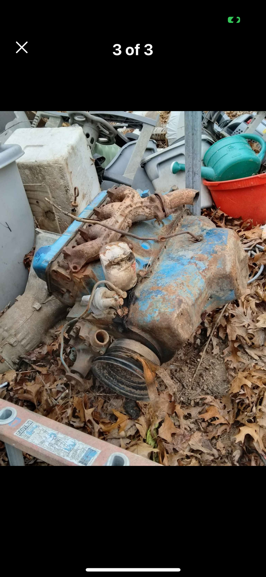

Is this a 4x4 pan
Old Apr 10, 2025 | 12:05 PM
Ar. Hillbilly's Avatar
Ar. Hillbilly
Joined: Sep 2016
Posts: 492
Likes: 77
From: Eureka Springs Arkansas
Is this a 4x4 pan
Says it came from a F150 2x4 and the transmission is a 2x4.
wondering if this pan will fit my 3/4 ton 4x4 project?

Looks like a 351M or 400 with a 4wd pan that has taken hits on the bottom of the sump, and under the oil pump, likely set down to hard on the floor. Likely fixable. Needs a dip stick and tube.
A 400 with 4x4 pan on my stand.

yes. 4x4 has a rear sump, 2wd front sump.
im guessing it was installed in a 79 2x4 truck and that possibly dented it or as you say it may have been sat down/ dropped hard.

Can a dipstick and tube be had?

Yes.
https://shop.broncograveyard.com/mob...uctinfo/20104/
https://shop.broncograveyard.com/mob...BoCNI8QAvD_BwE
