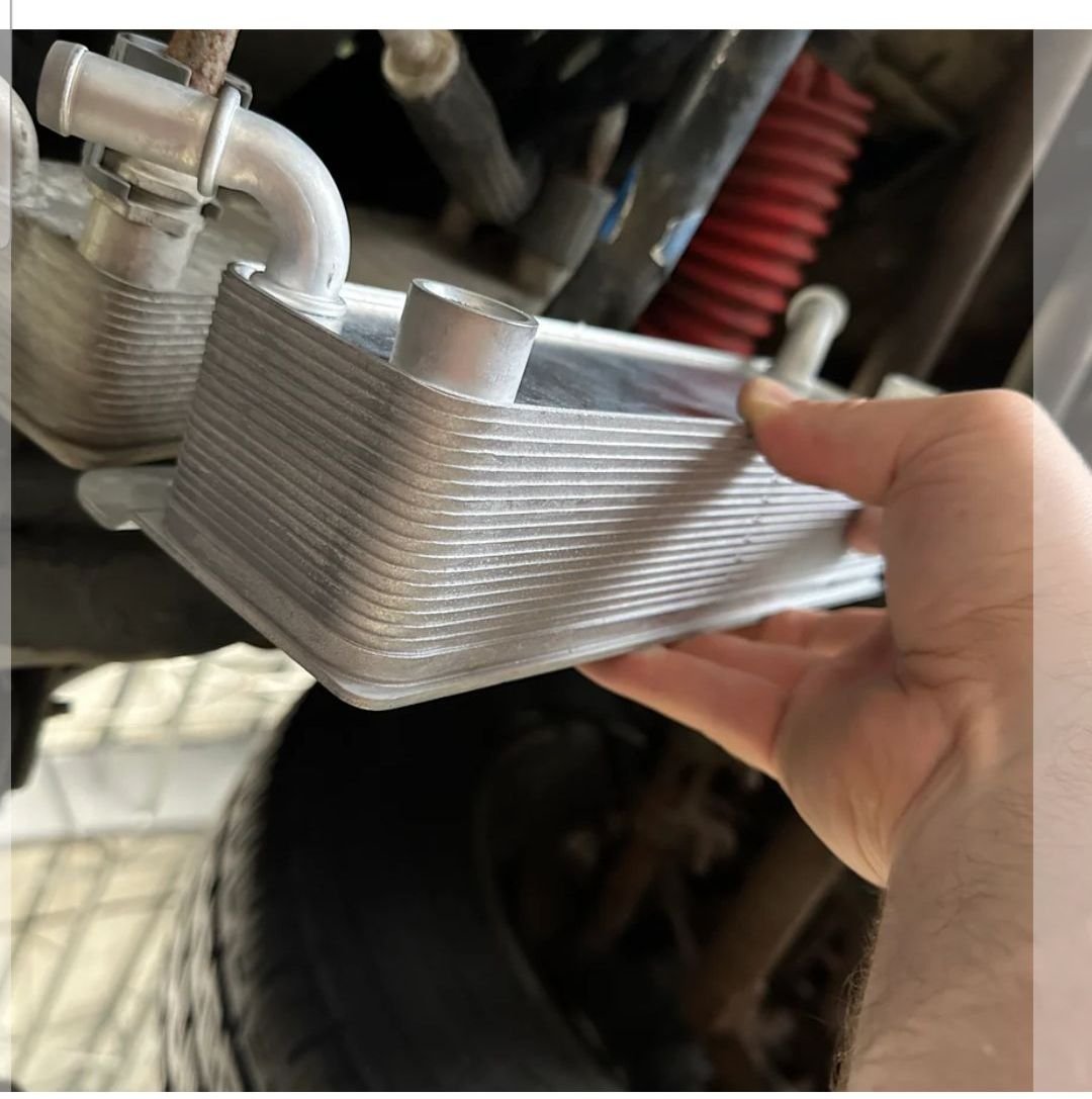

Don't know if this will help or if you solved your problem, but was looking at SPEs trans cooler when I saw this picture on their website:
Looks like those factory fittings thread into the cooler. Just FYI if you can find a hose fitting to fit into the cooler.

Those SPE trans lines set and their bigger trans cooler is on my radar for sure.
