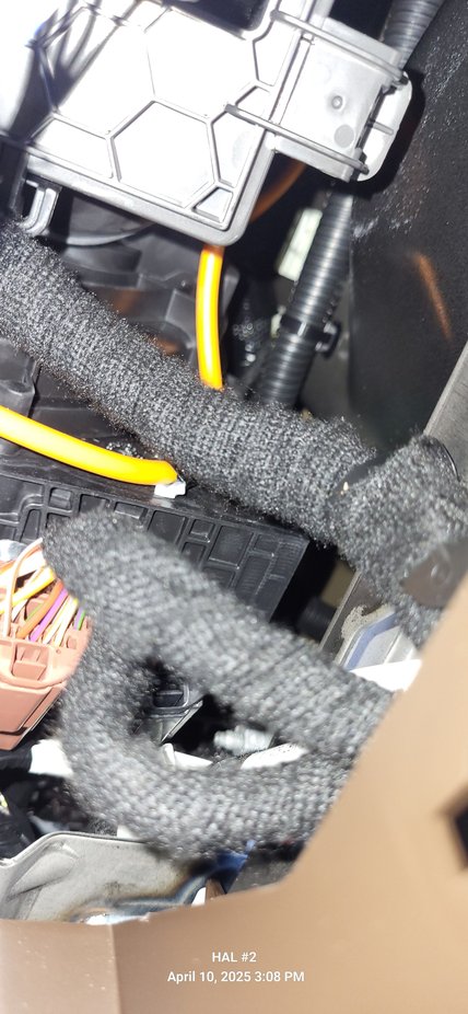

My bd high idle came today
the booklet indicates the connector in 23 plus trucks is more of a scavenger hunt
connector with pigtail could be up high in pass kick panel, or hidden
anyone put one in a 24 and has a pic where they found the connector?
i am going to start looking in am
thanks

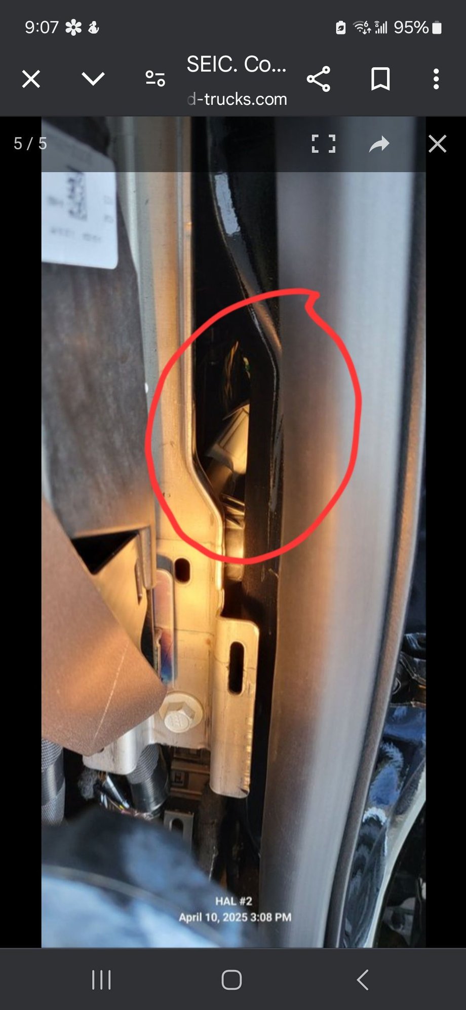

Finally found it..
what a mother flicker to get to
Way up high..very securely fastened to clip
any woooooo
I ran it over across under to headlight switch bezel..by happen stance I had popped out the panel to drill a hole right below it..then I saw the free space and said yup..
This will work
Funny thing was the pass the pass through wires, fell down and said howdy when I dropped the fiber panel
The red circle is the seic connector..it was up high in the panel
