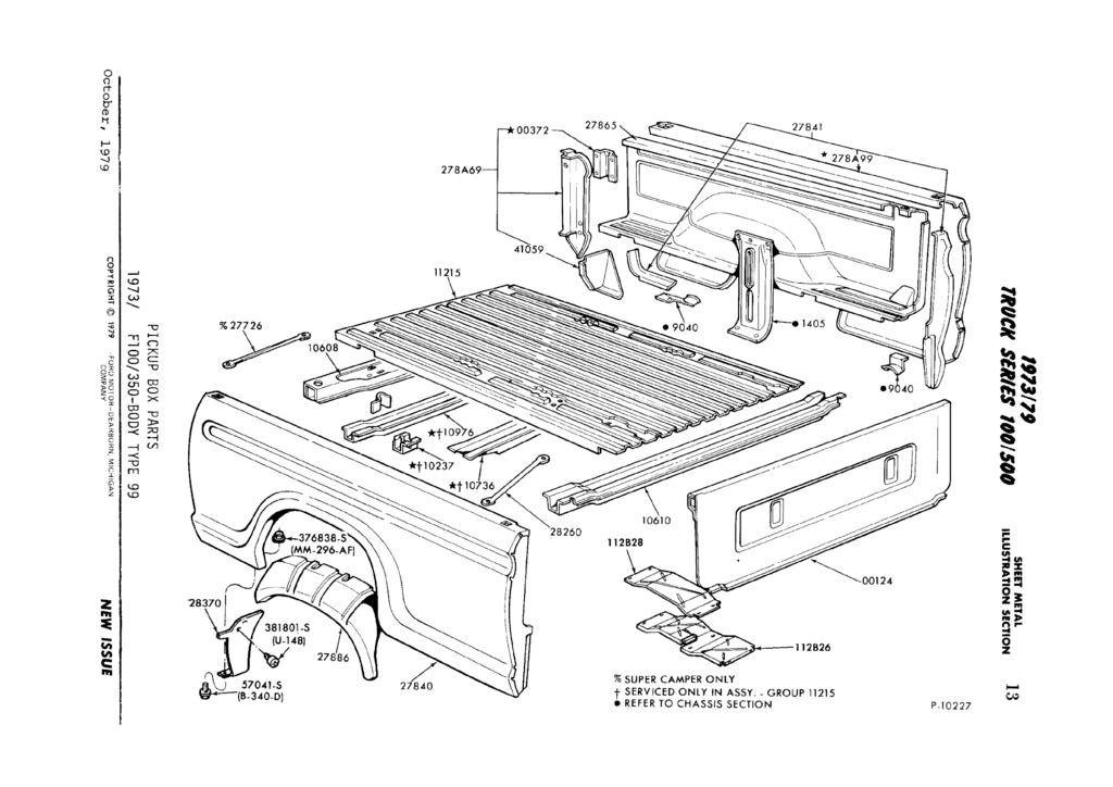

Its been 2 years since the removal of this on this ground up restoration.
Can someone tell me the proper location for this heat shield? No part number on it so I'm at a loss.
You guys have been so much help so far on this project!!
See attached.Thanks!!

Well it sort of looks like it came off the underside of the bed. #112B28 and #112B26 I believe are heat shields. I have not see one of them with a 90* bend, so maybe that is a Super Camper only item?

I have located those 2 shields. I'm looking around the fuel tanks thinking it might go somewhere around there.
I have dual tanks. This truck was a 1 owner and is not a camper special also. Thanks for the help!

With the 90° bend it might go on the inside and front edge of the fwd tank.
