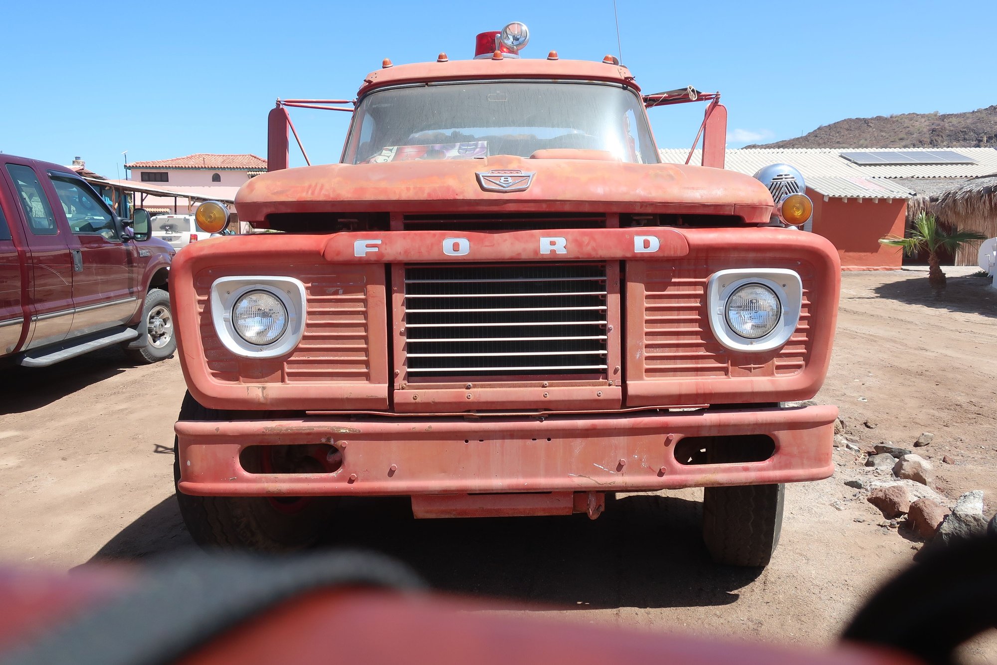

I'm trying to find the year of this truck. I really would like how to perform simple maintenance, like where do I add the oil? Will Sta-bil work as a stabilizer? What do I use for power steering fluid?
Here's the truck.
I read that the grill helps decode what year this model is. It does read Ford Super Duty F850 on the passenger side of the hood.

Welcome to FTE! This is the forum for trucks that size. This appears to be a 1969 model with the old Super Duty engine. Does it run?
F86 = F850
L = 534 4V Super Duty gas V8
U = Louisville Assembly Plant
E11685 = 1969 numerical series, October 1968 production
176 = 176 inch wheelbase
J = Red
F861 = F850, 27,500 lbs GVWR
4B81
4B = Black Leather Grain Vinyl
81 = Standard Cab, cab and chassis vehicle
No transmission code. This was a special order truck and the transmission was probably part of it. (I'd bet it's an automatic?)
No rear axle code. Again, part of the special order.
E = Ford-Rockwell (Timken) front axle, 9,000 lbs capacity, without HD front brakes.
27500 = 27,500 lbs GVWR. This would require a Commercial Driver License in the US.
235 3000 = 235 Certified Net HP @ 3,000 RPM
729903
72 = San Jose District Sales Office
9903 = Special Order Number

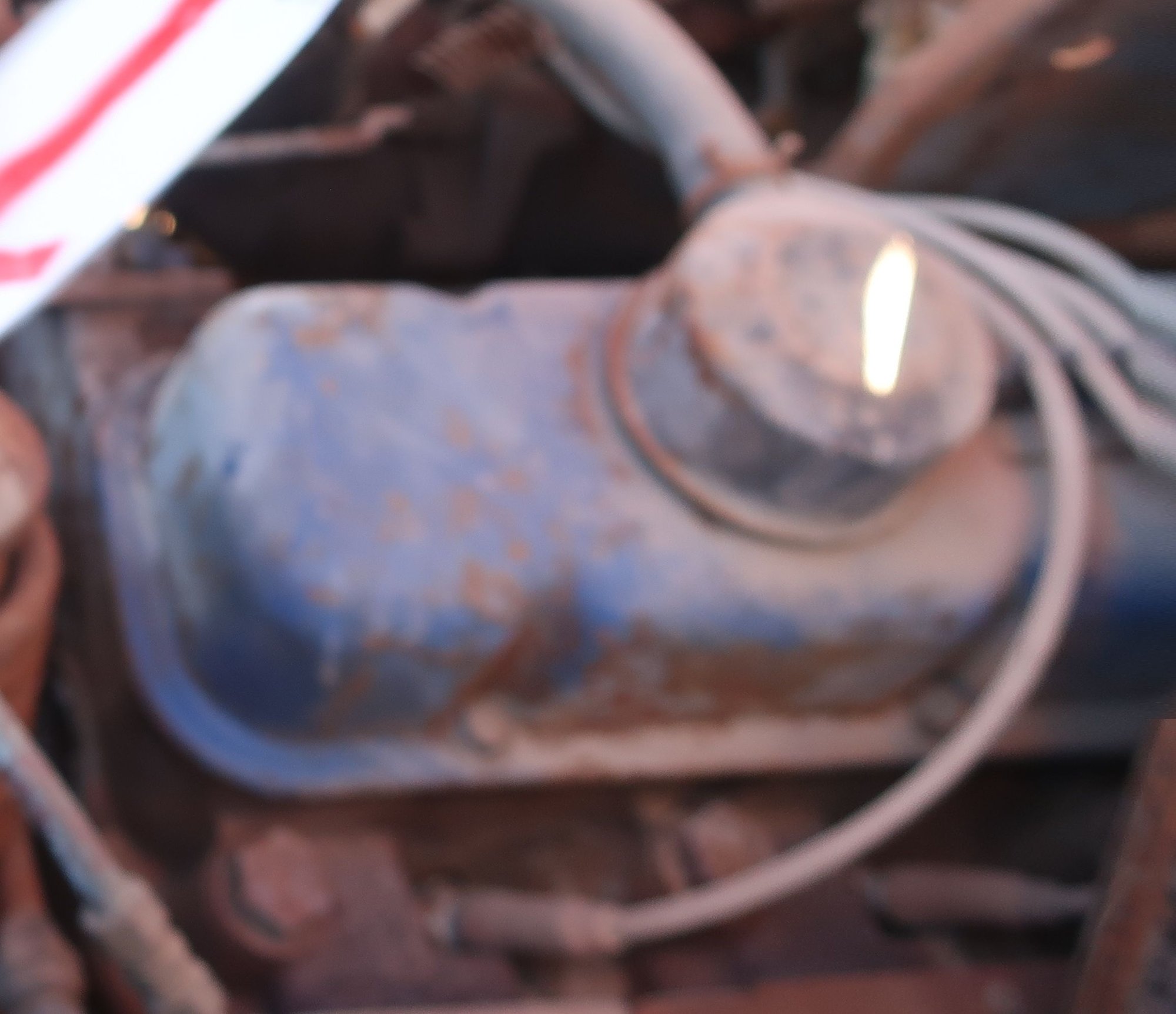

There should be an engine oil fill on the driver side valve cover. It could be connected to the air cleaner via a short hose.

I still have trouble located the oil fill cap. There are caps on both valve covers with hoses leading to a single hose up to the large oil-bath air filter. I guess I don't know what I'm looking at.
The arrow is pointing to the power steering fill cap. I haven't located the oil fill cap.

Doesn't the cap on the valve cover twist to the left and come off? Or straight pull off?

Ok, just wanted to check before attempting. I wasn't sure whether to twist it off (not really easy) or pry it off (it's stubborn), but at least I know that's the cap I need to loosen. The oil is fine at the moment, but the info is good to know for the future. Thanks!
