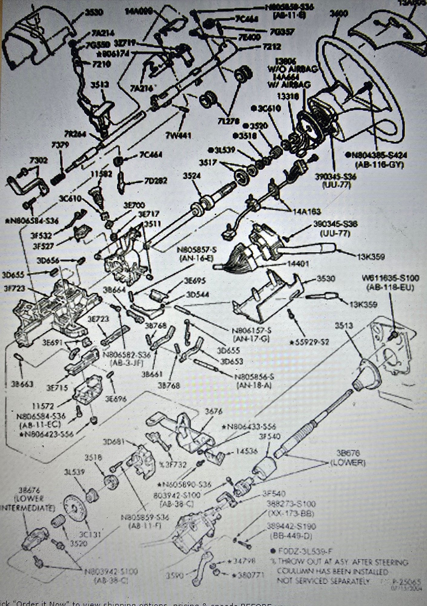

Changing the column on my truck and also the steering wheel. Going to a tilt column and cruise control steering wheel. It is a work truck, so I did not go for the leather wrap. My 02 F350 has a rubber wheel and cleans up pretty nice, so I did get the appropriate rubber cruise wheel with airbag for my 96. Thought that I could reuse my original bolt from my nontilt steering column and just put a little thread lock on it, torque it, and call it good. Looked at LMR and they showed a torque to yield Ford steering wheel bolt, so now I am second guessing. Is it just a regular bolt for the wheel or is torque to yield? By the way, what should it be torqued to?

The new ones use a torx bolt to retain the steering wheel 1991 and up IIRR if you have an airbag
They might "say" "torque to yield" and replacement necessary
Yes, if you were at a Ford dealer and they had a new bolt you could use one (I did) at the dealer when I worked there
However, most of us just reuse the original bolt with no trouble
I don't think most mechanics have even read what you read
Good job
The bolts are readily available
I would hit the dealer the Ebay ones are a ripoff
Here is one, item number 276869097190
[img alt="I have reused them with no trouble
I have replaced them too, who is paying? If under warranty, and Ford says to replace the bolt, then by all means, it gets a new bolt!"]https://cimg1.ibsrv.net/gimg/www.ford-trucks.com-vbulletin/2000x1075/steering_wheel_bolt_5a72192bb8ee6fc1c0933644d81eca 687906aca1.jpg[/img]
I have reused them with no trouble I have replaced them too, who is paying? If under warranty, and Ford says to replace the bolt, then by all means, it gets a new bolt!
