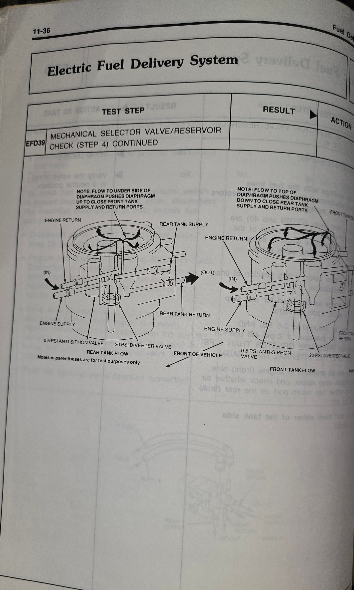

What you wrote is a little unclear, to me. So does the gauge usually read correctly for the selected tank? That is a separate problem from the fuel delivery issue. The sending units in both of my tanks are very accurate. When you select a tank does the pump in that tank turn on? That style of fuel system the Dual Function Reservoir (DFR) controls the flow of fuel to and from the selected fuel tank. Fuel pressure from the in-tank pump forces the valve in the DFR to move allowing fuel to flow to and from the tank and closes off the ports for the other tank.
What you are calling a “canister pump switch” is a fuel reservoir for the high pressure pump on the frame rail. There is no pump and no switch per se but an internal mechanical valve.

Test away on the switch and the valve
Here is some testing for the crossover valve

OK, I turned the truck on and never a peep from inside the tanks, no matter which tank was selected. Now, I just saw the pics and diagrams as for some reason they did not show up either on my phone or at the office computers. So back to square one for testing. I will start with the switch and see what happens. If it is one or both tanks, I will have to run one dry and then transfer gas manually-fun.
