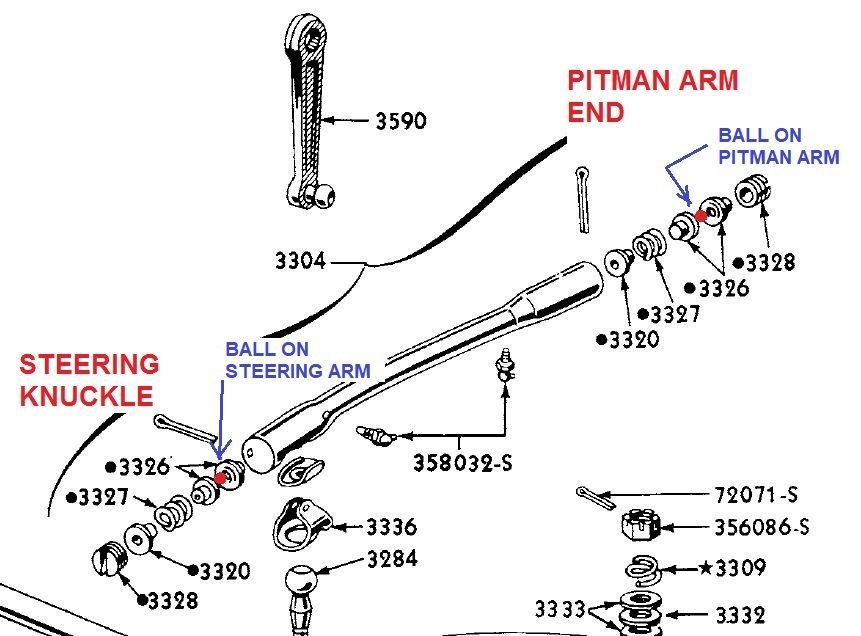

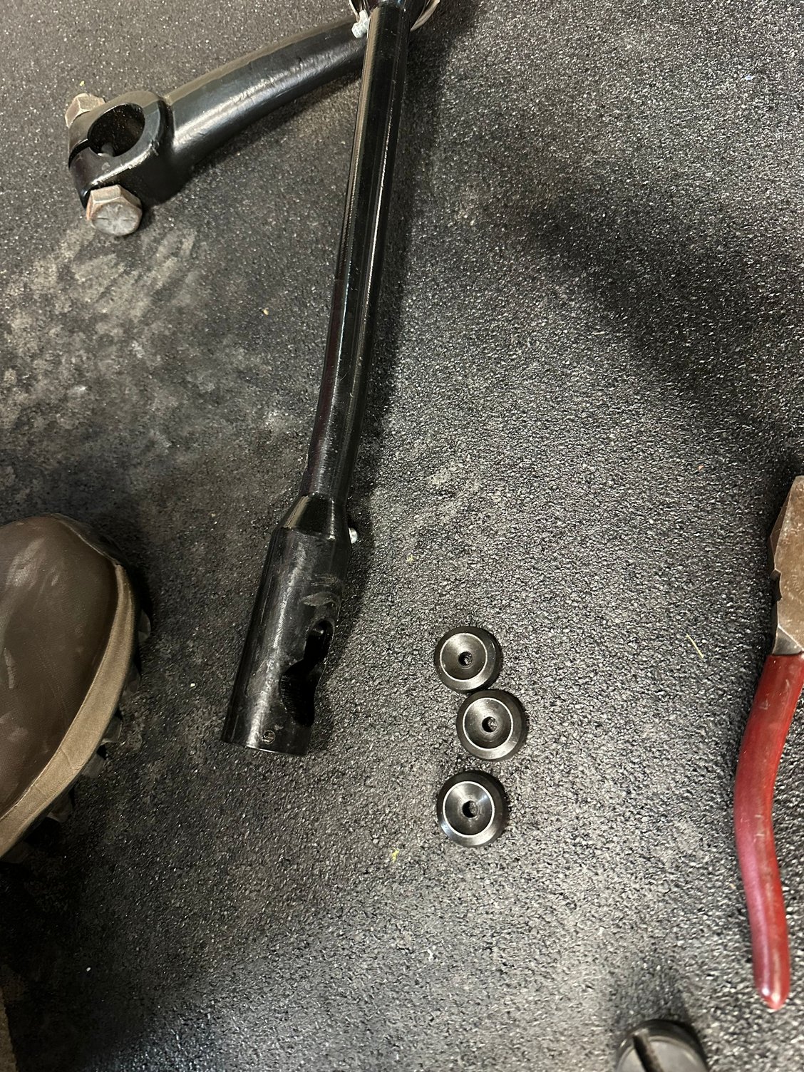

I have a new drag link. The end that connects to the steering arm has 2 steel cups to hold the ball.
The other end of it that connects to the big u thing, which I don't know what it is called, came with three cups. Is the third a spare or in case you need to take up extra slack? The assembly diagram only shows 2.

There should be 4 total, two at each end. Any chance of confusion between the outer seats of which there are 2 total, one at each end?

They way I read his post is he has five, hence the confusion for him.

There should be 4 cups and 2 spacers that fit inside the spring. There's no difference between any of the cups, AFAIK.

Correct. I have 5.
sounds like I have an extra one. I will assemble it with the 2 on each end.
