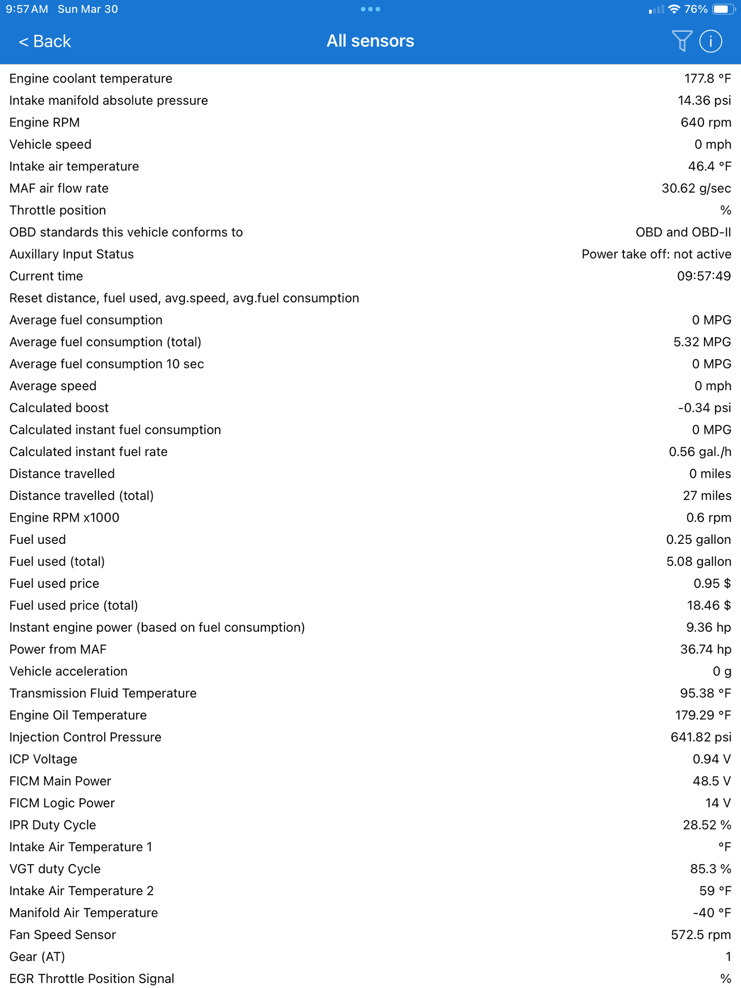

These are the numbers
Icpv at idle .86 to .94 at 2500rpm 1.22 oil pressure at 2500 is 901.82 psi
ipr% at idle 28.3 at 2500rpm 84.77. Oil pressure at idle is 641.78
code is fresh

alicejoe1!'s Avatar
alicejoe1!
Joined: Feb 2025
Posts: 68
Old Mar 30, 2025 | 10:24 AM

the slightly more then stock not the high output and no I haven’t contacted them I figured is was standpipe or ball cups leaking
did you see my stat sheets are they good I start it cold oil pressure numbers are higher like 8 or 900 at idle an 12 to 1300 at 2500 rpm I really don’t know what to do next what do you think maybe tart over and do an air leak test my hearing is really bad but maybe you have a suggestion
