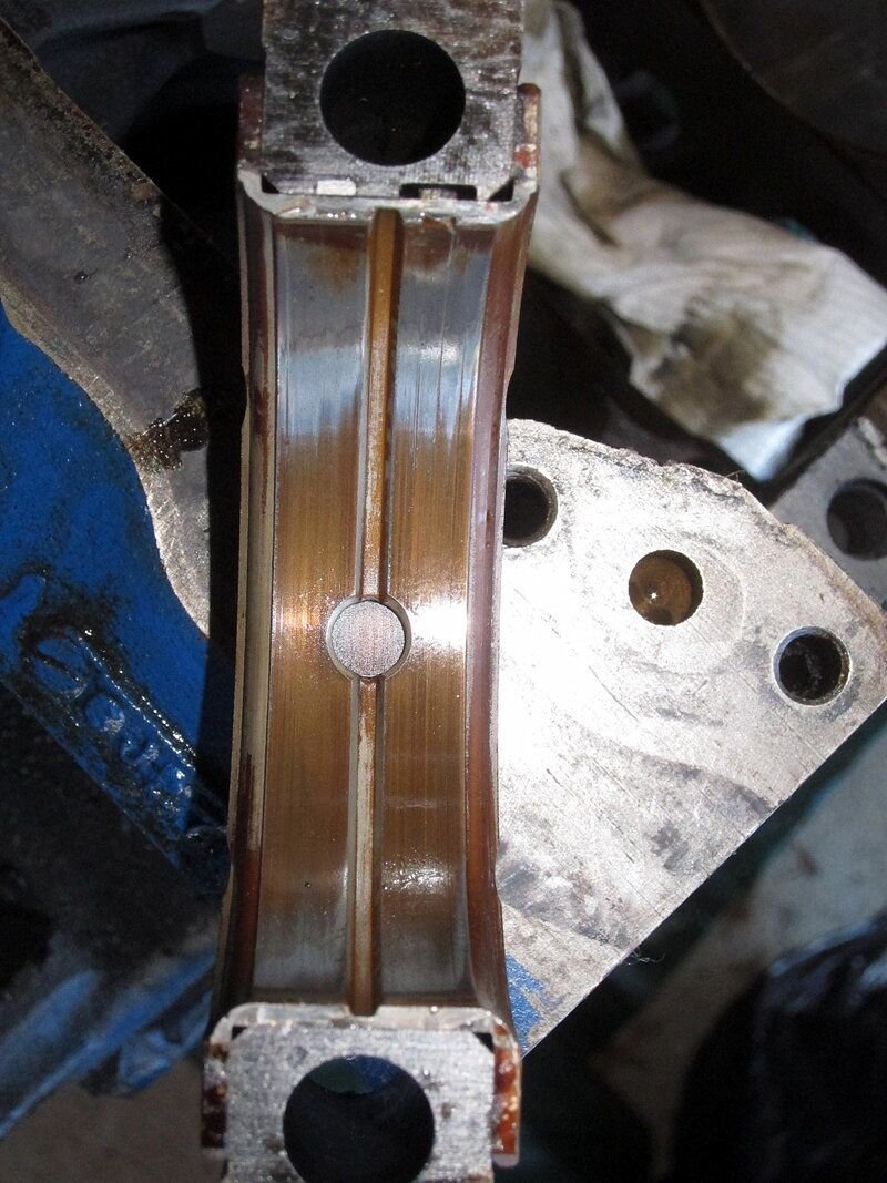

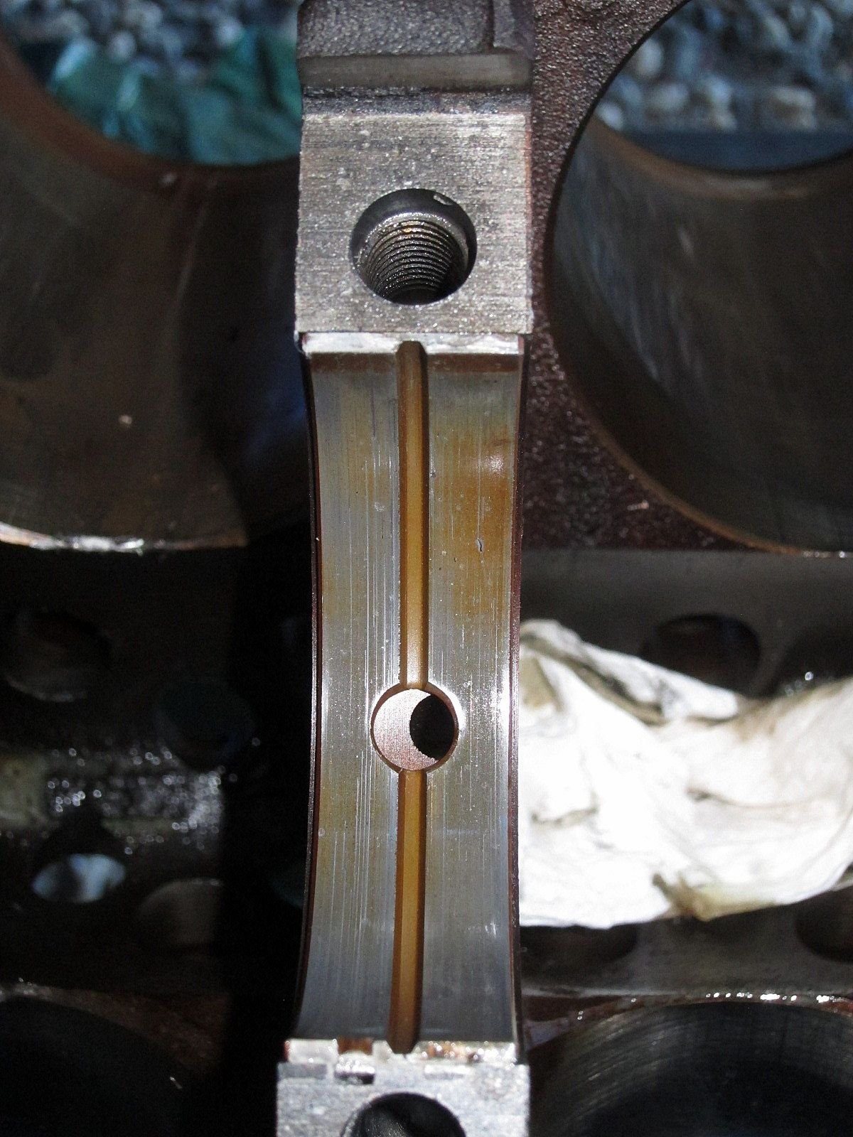

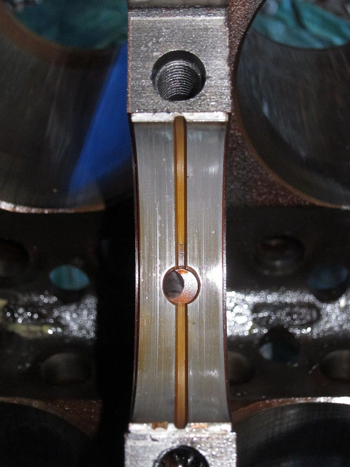

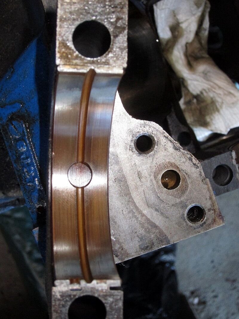

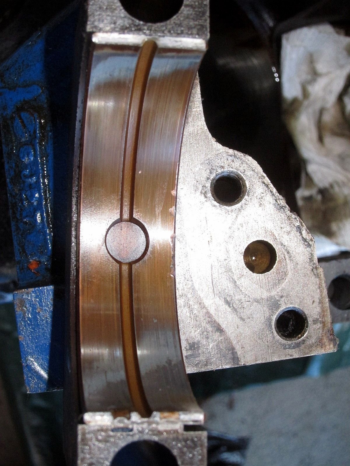

I did take pictures of the bearings which was almost one year ago. First two main #5 cap then saddle. Next #4 cap then saddle.

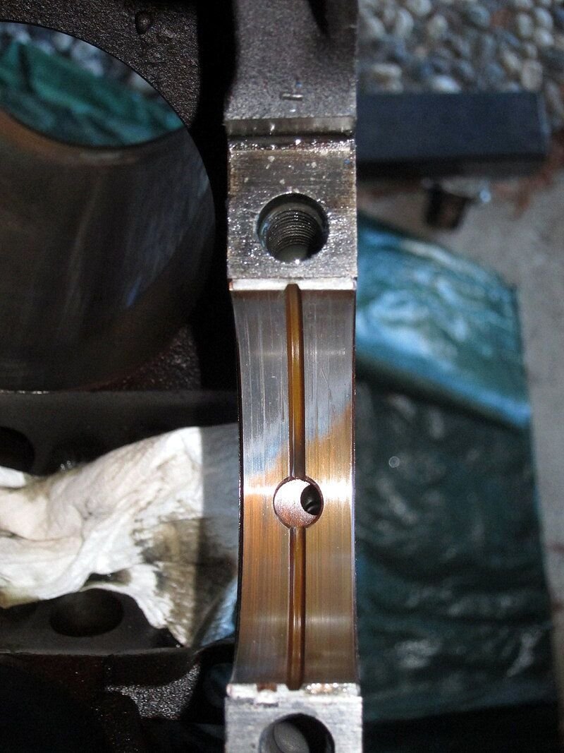

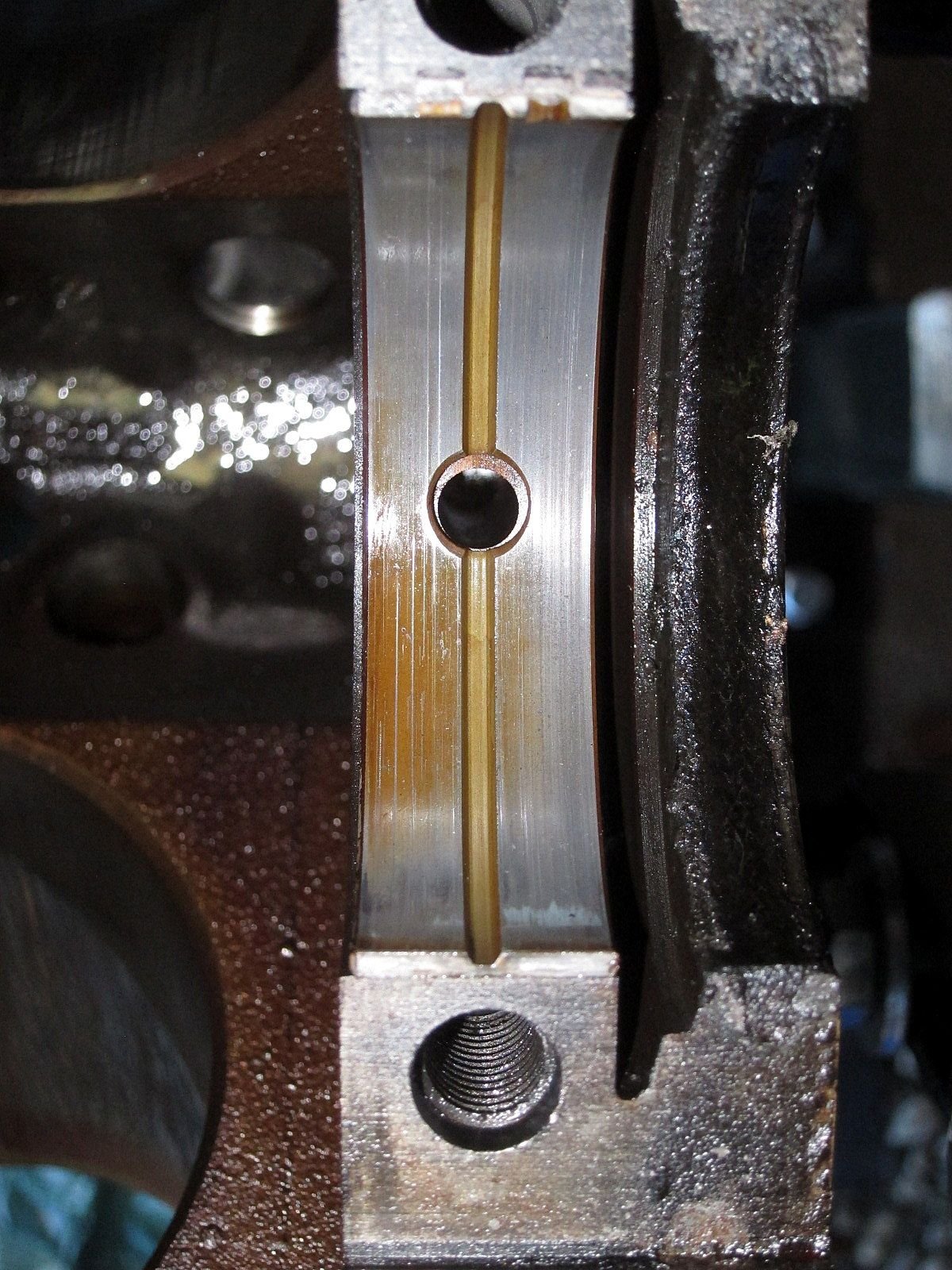

Next is #3 cap then saddle / #2 cap then saddle / #1 cap then saddle. As I look at the pictures I can see the variation in wear.
