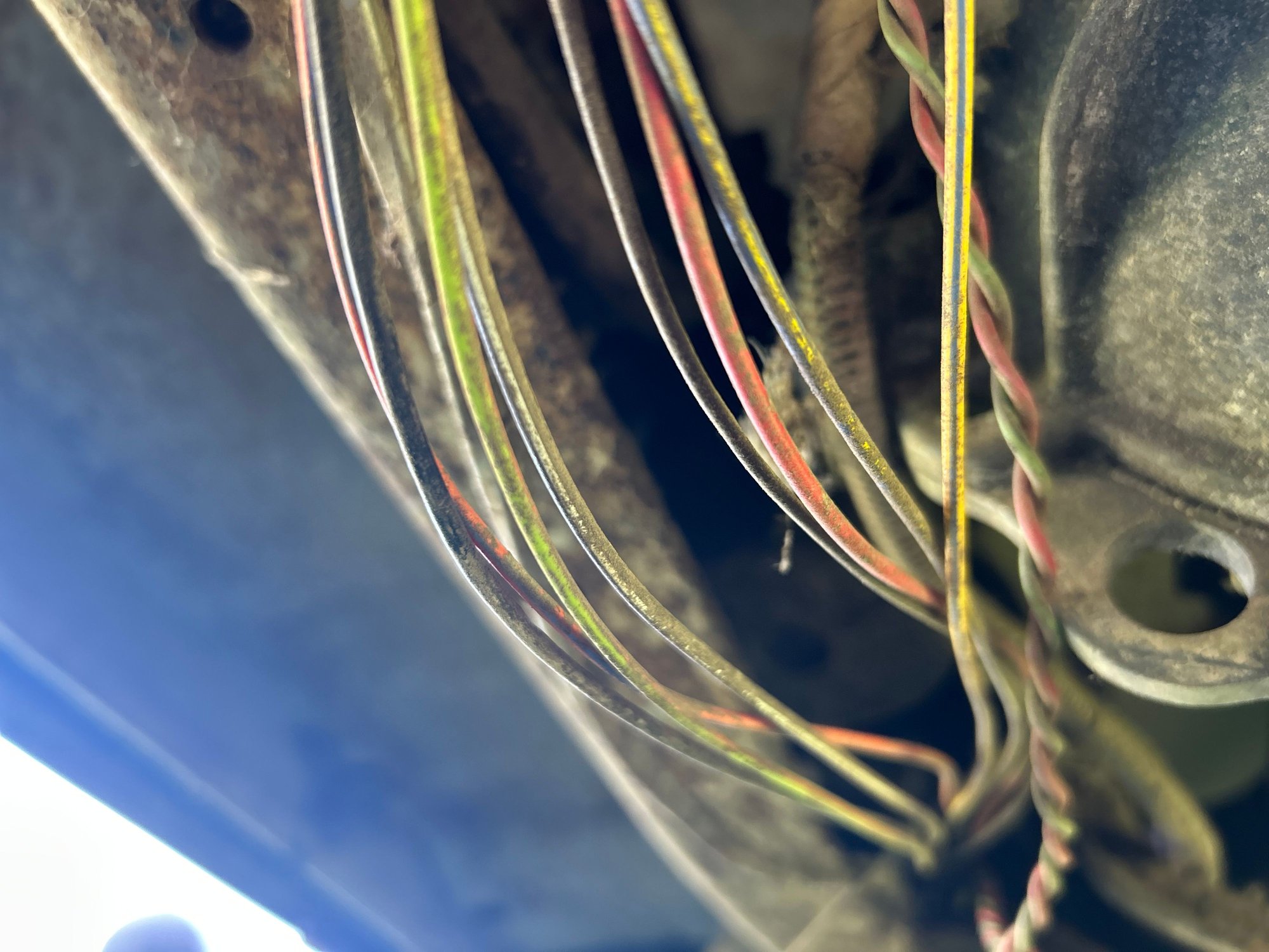

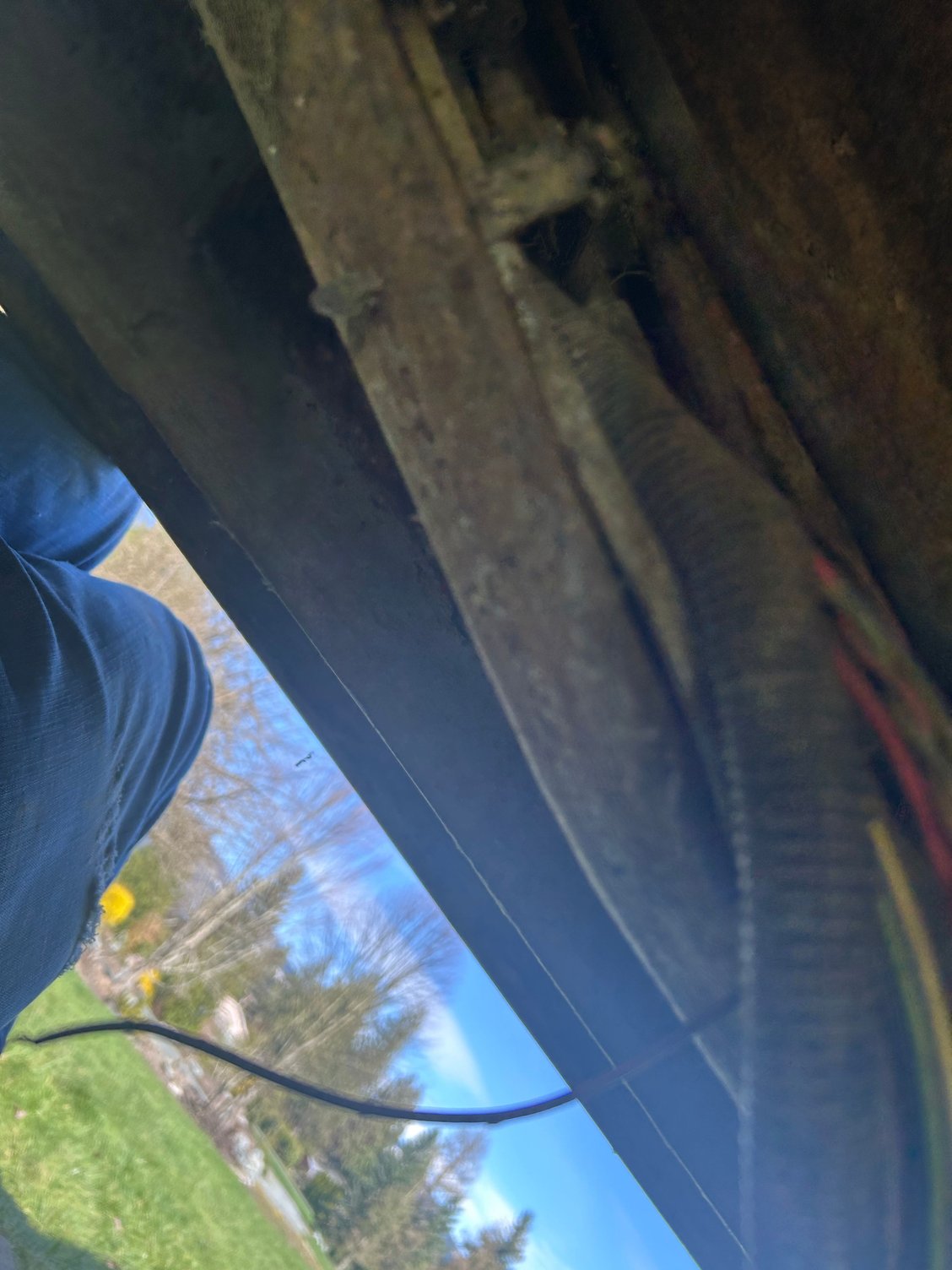

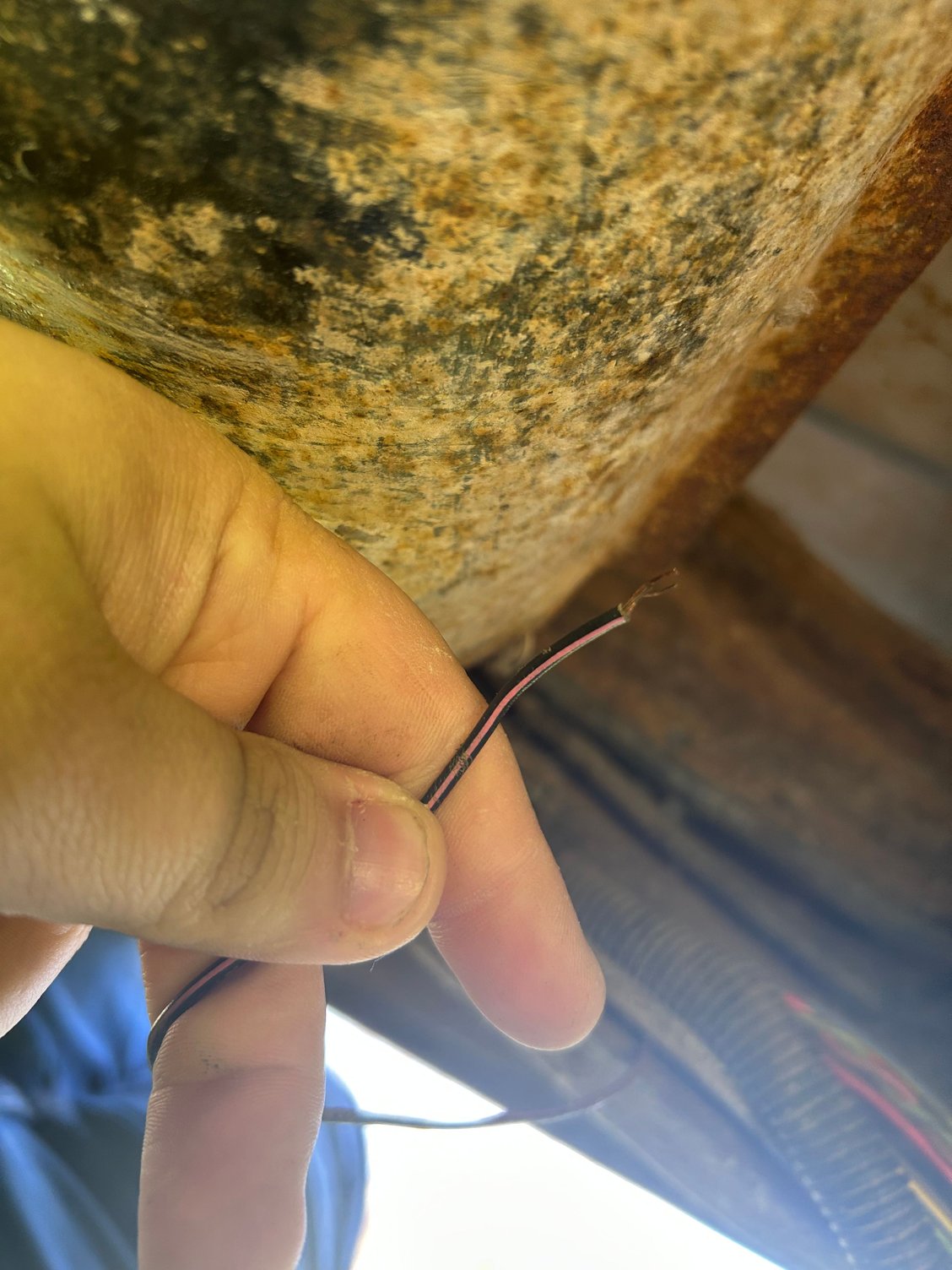

Pulled this 88 f250 out of a swamp it’s been sitting in for 7 years and got it running on starter fluid but I’m not getting fuel. Went underneath and saw some chewed wires. 88 f250 5.8 Windsor with duel tanks and the high pressure pump. Anyone got a schematic on can see to see what goes where? At a loss at the moment and want to see er driving again

Just unwrap the harness until you find it. Repair it. Tessa tape. Split loom. Run it. Get a good light so you can see. You are most of the way there just finding it.
