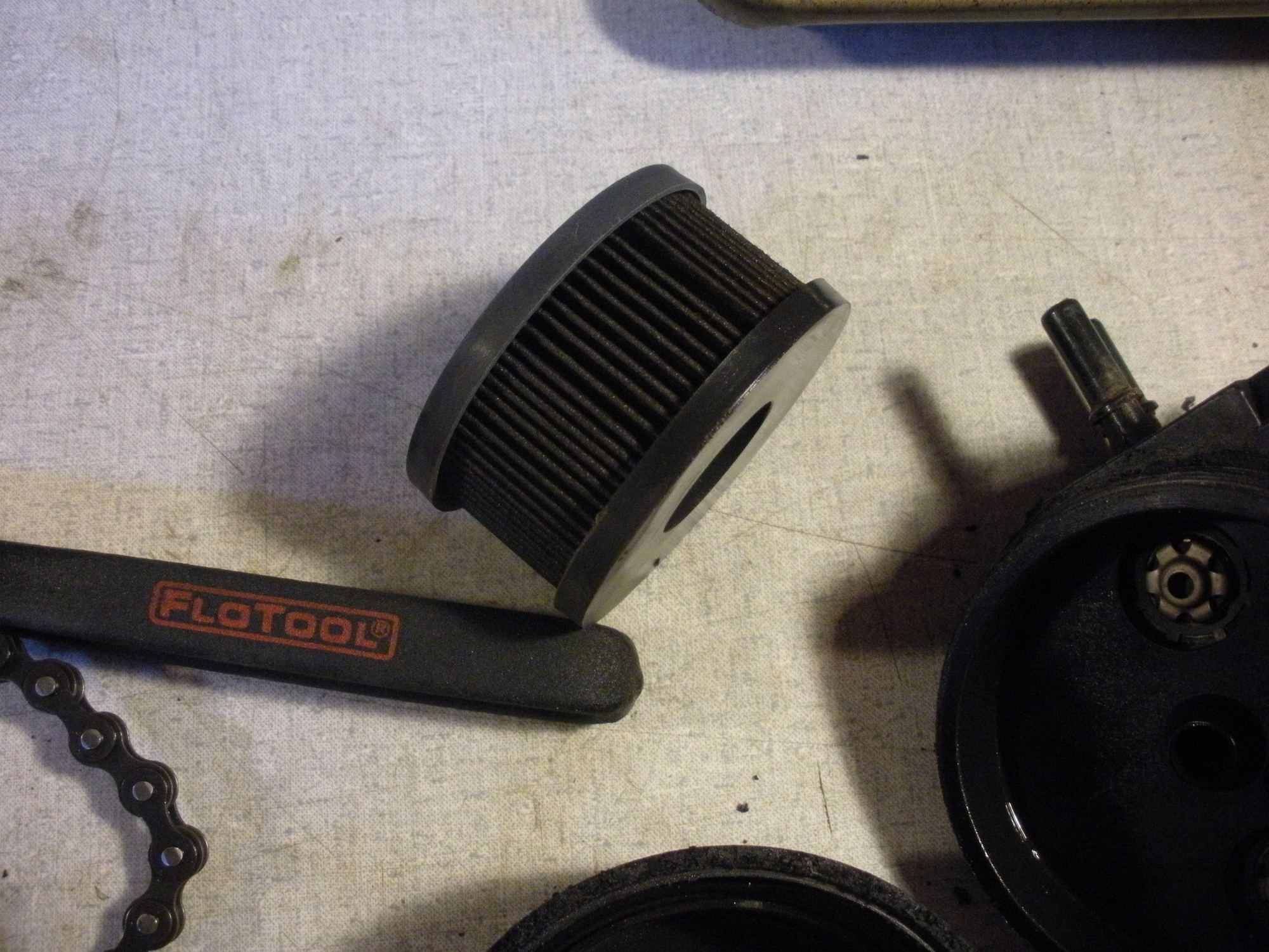

Sounds like the fuel filter is blocked. Did you somehow get the rust in the old fuel tank mixed around so it would fill the filter ? Here's my old filter when my truck did the same thing.

Tank is only about 1 year old. So shouldn’t be rusted. I already swapped filters also. Like I said it only does it after driving and getting hot.

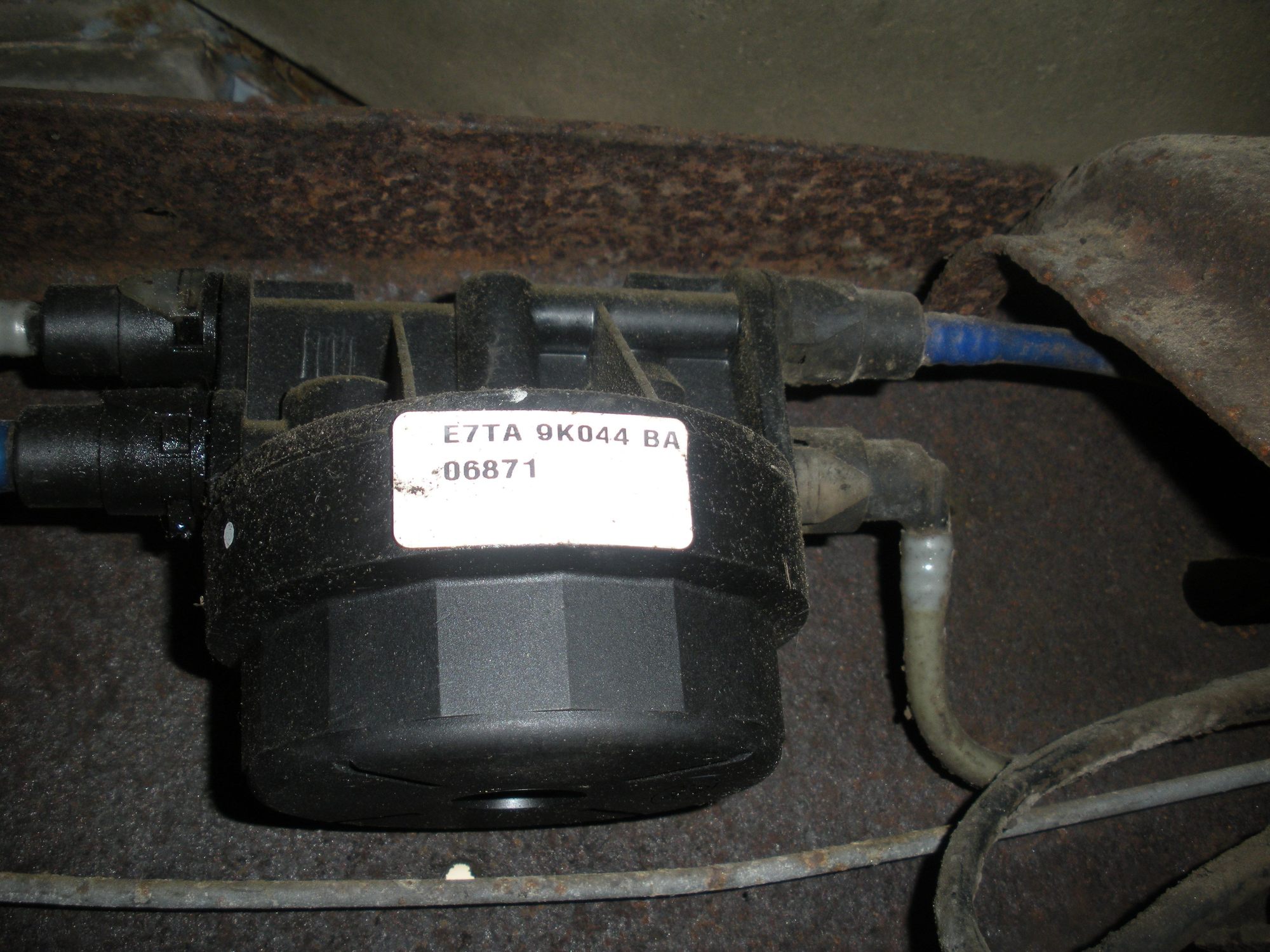

Great find! Got pictures? Was this filter like the one seen in post #2 above? Or was it a different arrangement?
