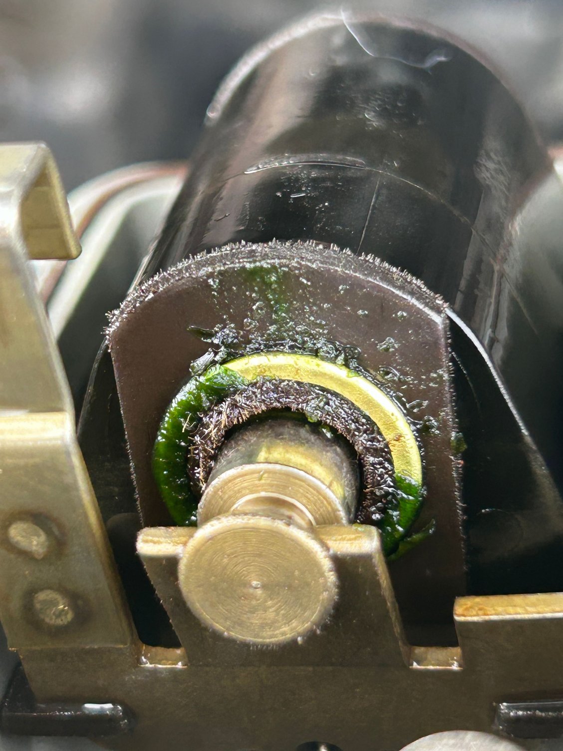

Just found this algae buildup on the FSS, what does it mean for the pump?

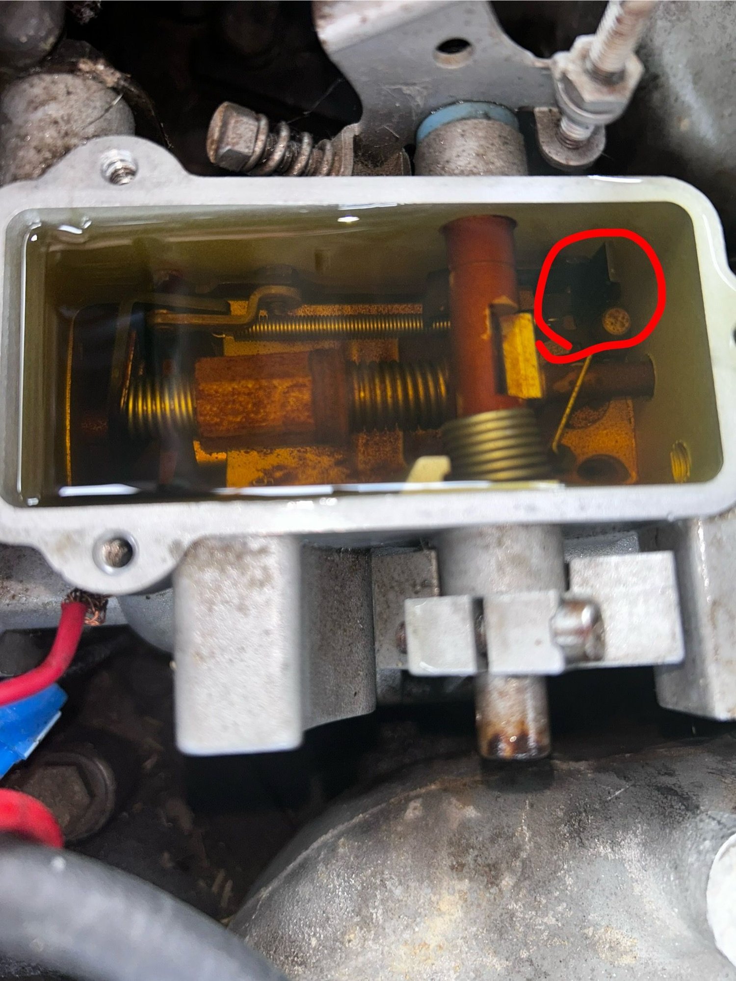

Picture of the inside

You're going to need something that will kill the algae. internet search: Bio Kleen Diesel Fuel Biocide
Maybe try taking your IP cover back off, soaking up, or sucking out, all the fuel in there and then filling it with that. Your fuel filter might be full of it too and tanks. So be sure to change the filter and add some to the tanks. Anyway, after filling the IP and making sure you place the cover back on correctly so that if/when it does start, it doesn't runaway, then crank for 15 seconds or so and hopefully it pushes some through the IP. Then let it set overnight if didn't start, and then try doing the same thing the next day. Maybe it will eventually clean out enough to fire and run and if it does, it will hopefully clean the rest out over time with more in the tank?
I don't know if this will work or if it's hopeful thinking, as I've never run into this issue before. Just something I'd try unless someone knows this wont work and tells you not to bother. It seems think a reasonable thing to try to me, before removing the IP from the truck and attempting to disassemble it and clean it.
Well, it says 1 ounce of the stuff treats 20 gallons, so perhaps don't try draining the IP. Just enough to add a teaspoon or so to the fuel in there, let it set there for.... how long? Then try cranking? I've only guesses.

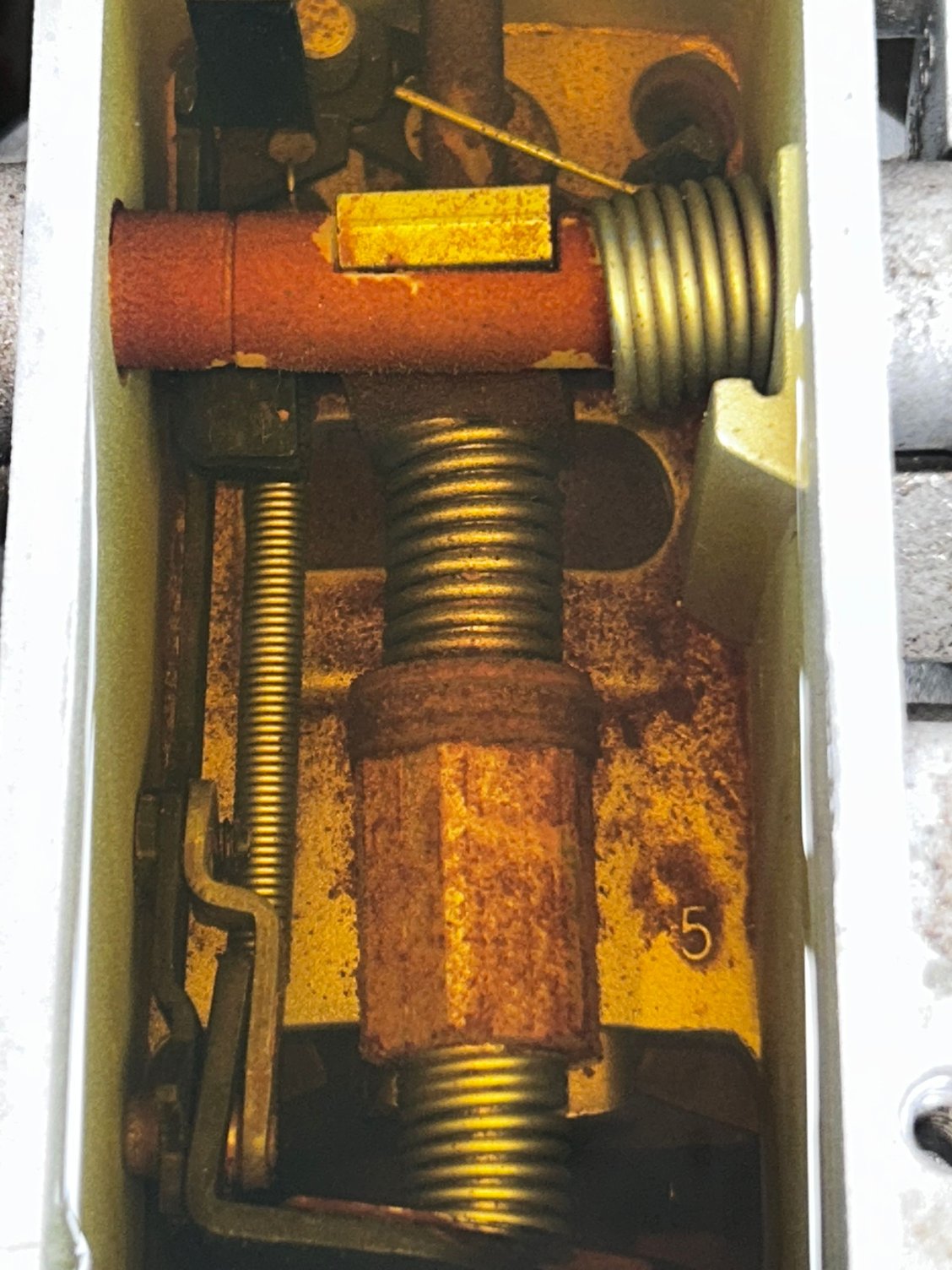

just for other people’s future reference, I’m going to add a picture of the linkage that was seized up. Just had to get in there and exercise it.
