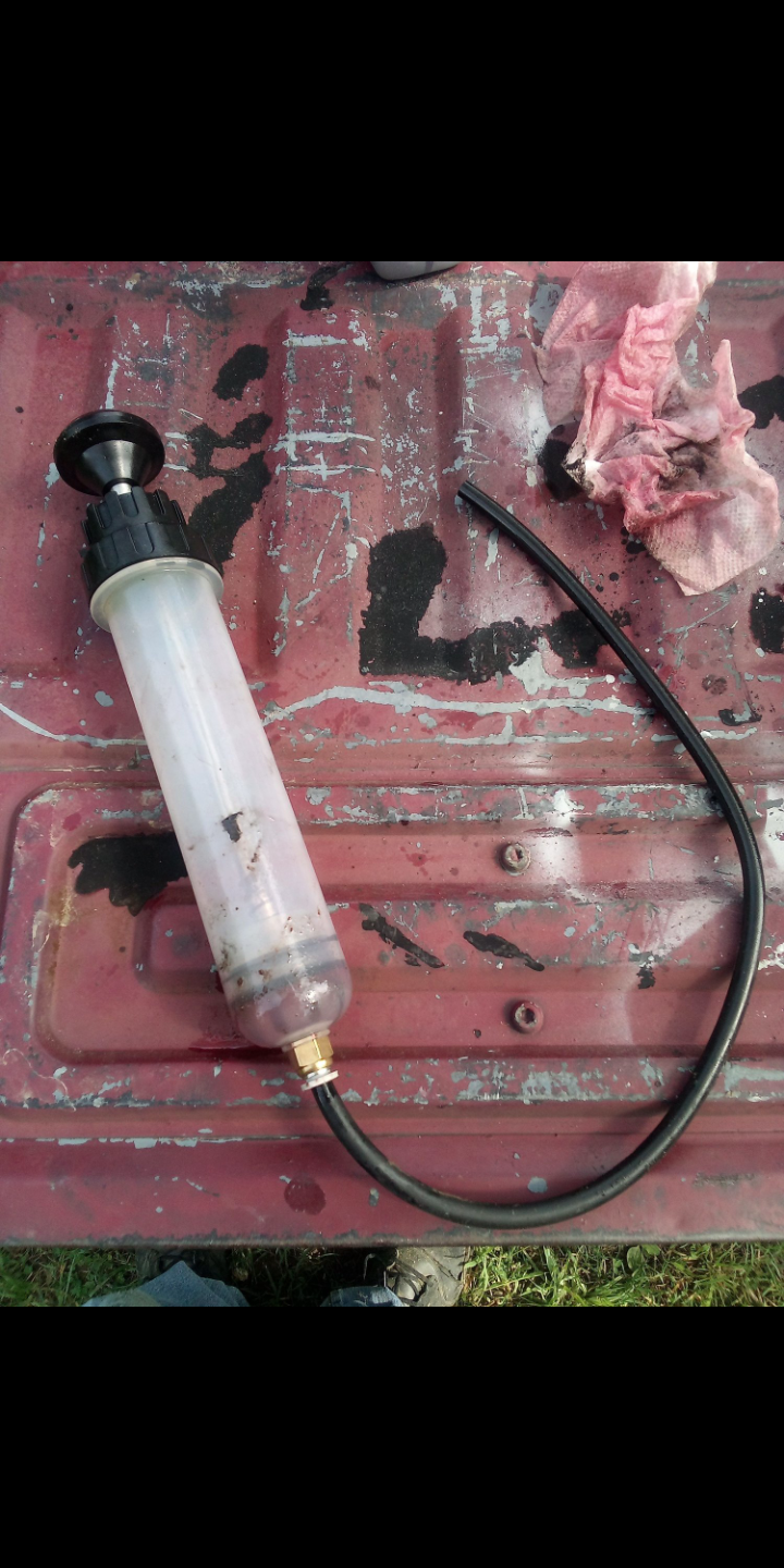

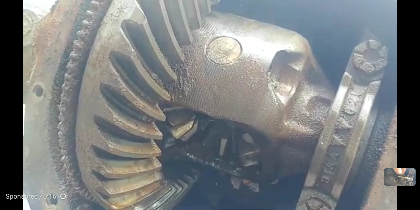

This is what came out of my rear axle, 3.55 open differential, in 2020. I washed it all out with WD 40, and put 80/90 in it. I changed it again about 3 years later.
They'll take some abuse, not that that's my goal, and I'm not running it at the drag strip or off road racing.
A syringe like this one works good, if you don't want to pull the rear cover. I used the syringe the second time I changed my gear oil.

hahaha wow that's incredible. I plan to pull the cover and do the works on it because I know nothing about it's history! This pictures instill a whole lot of confidence in the abusability.
