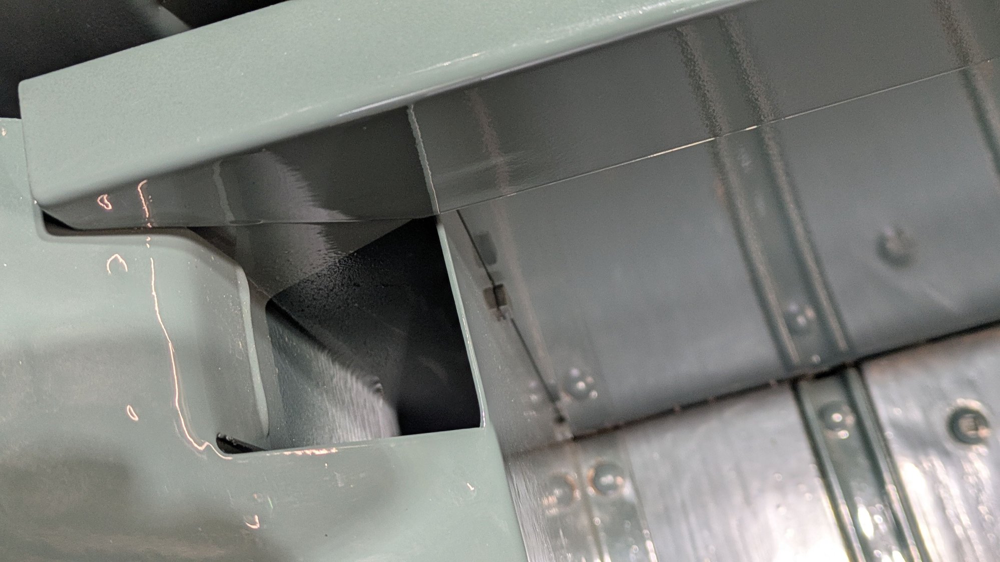

Stake pockets on the bed I bought from Midwest Early Ford.

My factory bed has the tabs and they are bent down, but not straight down. There is a slight gap before they bend down. I'm attaching 2 photos, one of the front and rear pockets.

Second photo disappeared so here it is.

Thanks truckee. After I got to the body shop we discussed and he just bent it down with his thumb so that's what we decided to do.
