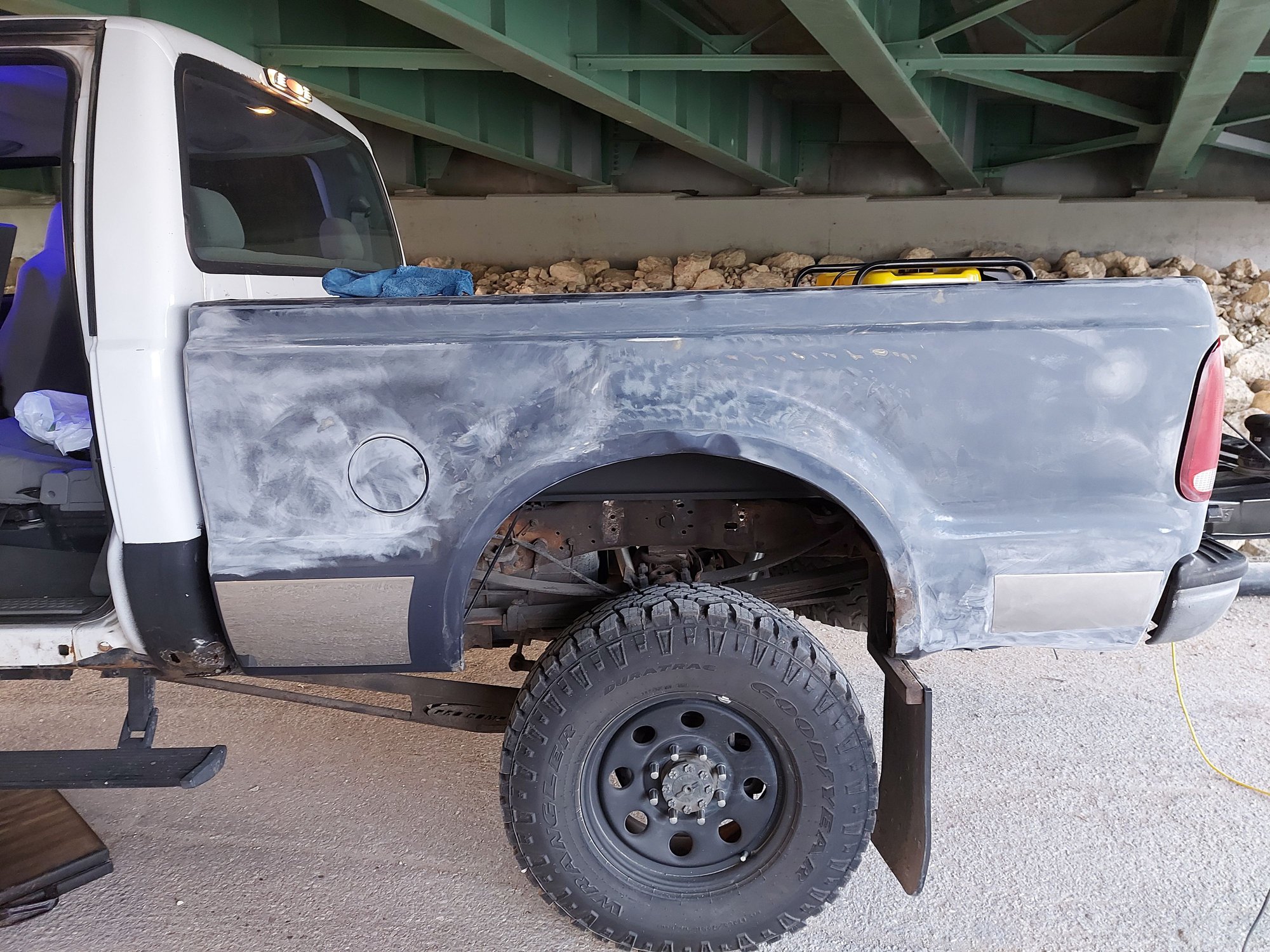

I'm 500lbs under payload(1800lbs under if my truck came with F350 badges)and just curious if my leaf packs look normal or worn out/tired? I'm going to be installing felling wedges on top of the bottom leafs to bump up the rear end a bit and get the overload leafs activated sooner, but so far the truck rides fine for what's in the bed and being on an 8'' lift. If springs are indeed looking worn then my plan is to replace them with beefier/heavier duty units from RockAuto that have 6+1 instead of the 5+1 that I currently have. Anyways thanks for any feedback fellas

They definitely looked straightened out to me according to the pics. Time for an upgrade.

Yeah I was thinking that's the case. Well in the meantime I'm going to install 2-6'' felling wedges per side and I also have to remove the DIY mudflap brackets as the rear of the leafs are close to touching. I have a set of larger mudflaps and I'm going to build one of those set ups that's connected to the receiver. These are the new springs I'm thinking of going with if the fitment is correct:

I’d be careful with the wedges. Honestly it appears to me the section of the spring on the trailing side is already slightly inverted. The wedge may put more pressure on that area and break the spring. At least that’s what I’m seeing from my 15,000’ view.

Wedges are not a good idea.

Curious as to what the square tubing is forward of your tire?

Square tubing is rear of the tires and they are the mudflap holders put in by PO I'd imagine. They will be coming off shortly.

Yeah....I see why you'd take them off.
