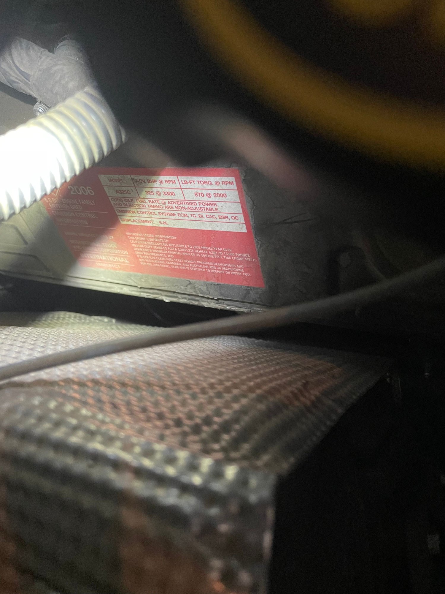

think I got a measurement on the passenger core plug. My calipers are too big so I had to use a measuring tape. Looks like 28mm.
Dreams shattered. 😭😂

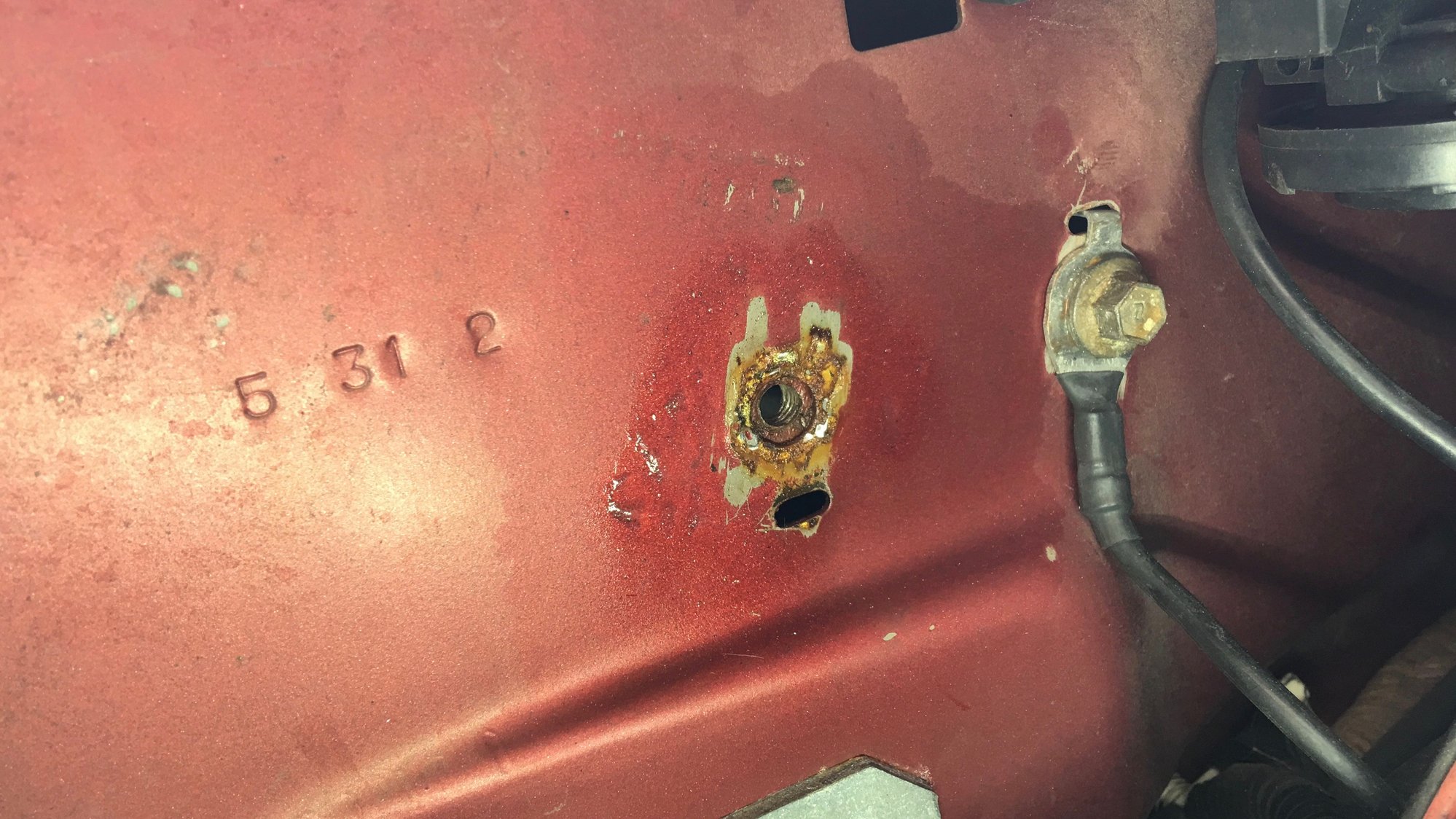

After removing the battery, the truck's build date (not the engine) is stamped on the passenger's inner fender.
In my case, May 31, second shift.
The 28/32mm dimension is the head casting diameter, not the ID of the core plug.

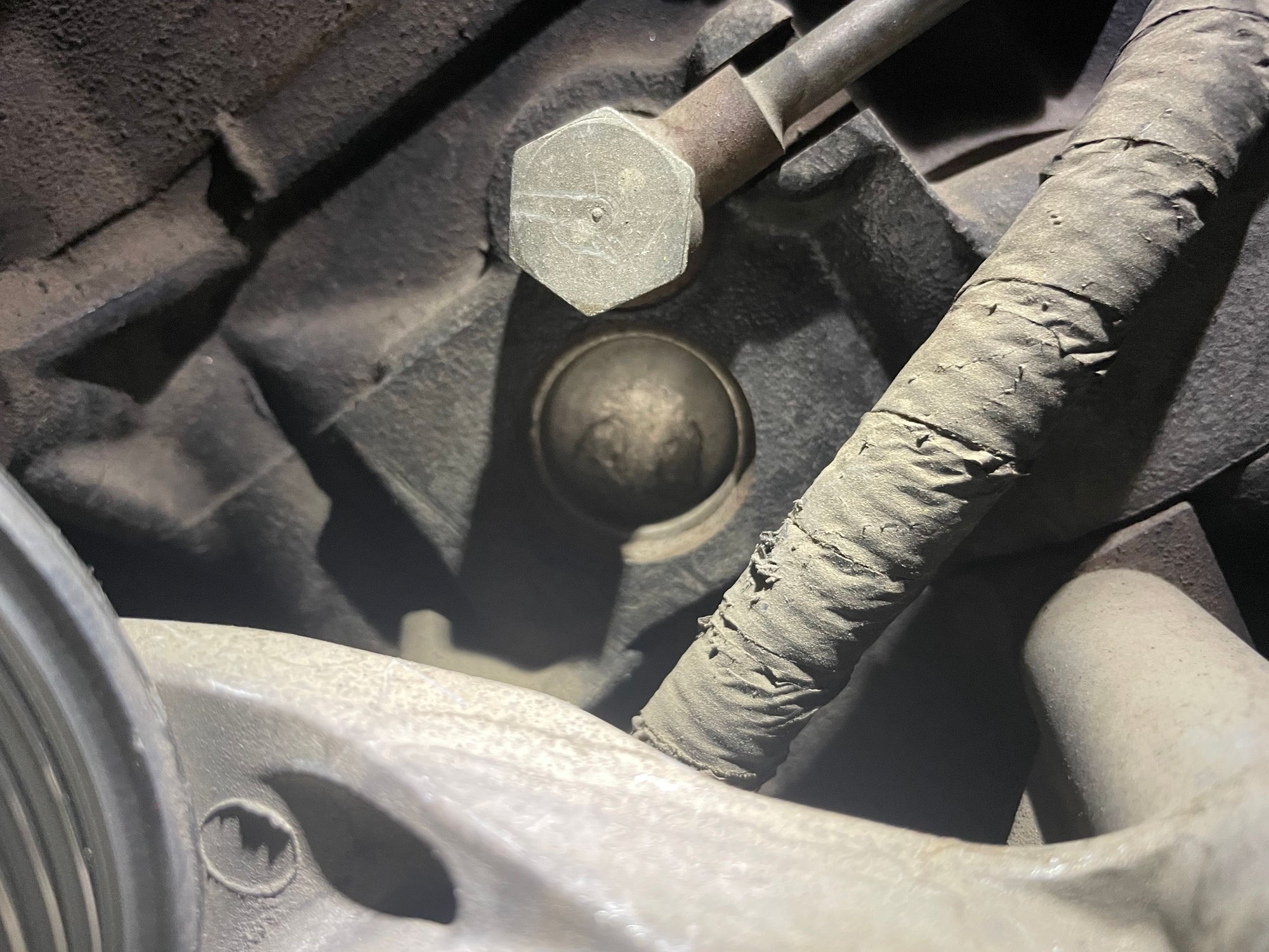

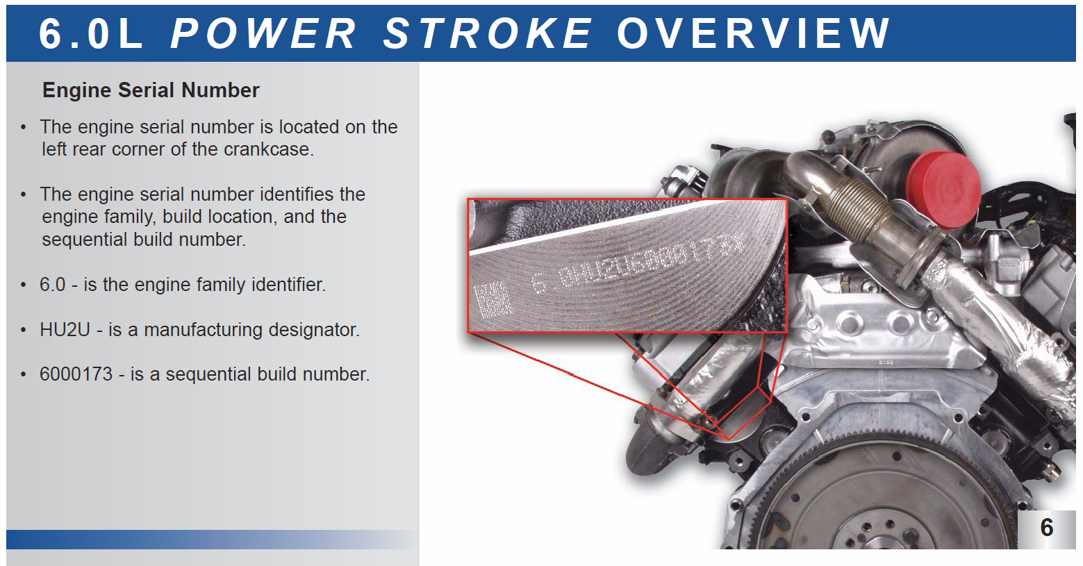

Originally Posted by FiveOJester
Looks like the block serial is very difficult to read with engine installed.
I was able to easily read my block serial number with the engine installed. The first step is the know where it is located (see picture below...look for the half moon shape), then spray the location down with some brake cleaner Reach in from underneath the truck from the rear of the block and wipe the location down with a rag to clean the gunk off. A normal size arm can reach this fine, its just a little tight. After all the crap is gone, now take a shop light to illuminate the area and snap a zoomed in picture with your phone. I found that it helped to boost the contrast with a photo editor. The only 'issue' that I had, and many others do as well, is that this number was double stamped on my block, making it difficult to discern what the actual characters were (my example is the second image). After some sleuthing and help here, we were able to deduce the ESN.

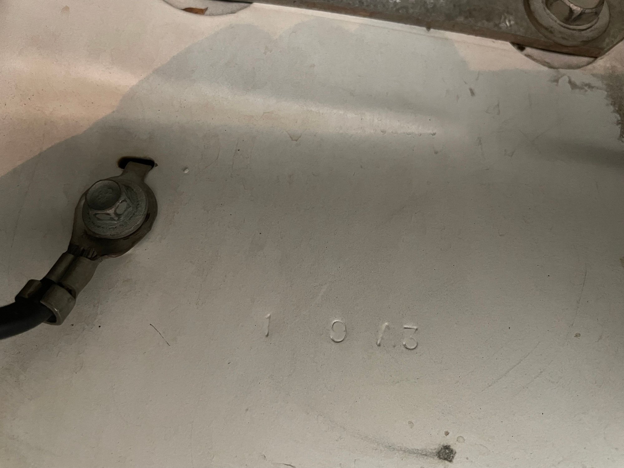

Looks like a January 9 build date? They stamped it upside down from Jacks picture. A3 is the shift number I assume. So literally missed it by 2 days.

From: Jersey Shore
These are hand stamps with a pneumatic hit, so the person on the assembly line doesn't really pay attention, so the stamp can be at any angle or upside down.
