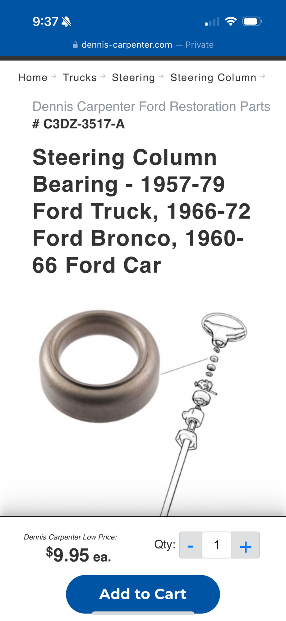

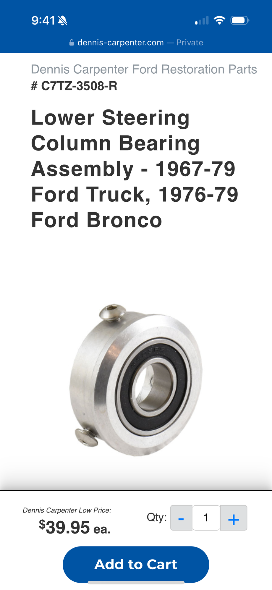

I was looking for replacement parts for the steering column on Dennis Carpenter and I came across this updated lower bearing.
Has anyone used one of these?

Yes, much better than the plastic "bearing" that ford used. There are a number of these offered on ebay. I don't know the exact brand I used.

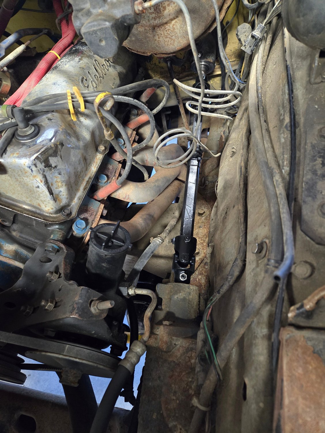

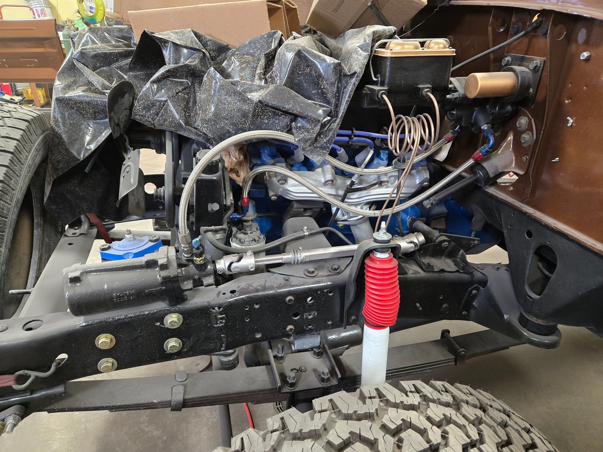

Do you have pictures of this installed? I’m curious to see how it’s placed especially with the three screws on the outside of the bearing and how it sits in the steel cup.
Old Mar 16, 2025 | 09:25 AM
nutter3's Avatar
nutter3
Joined: Jan 2014
Posts: 1,076
Likes: 500
From: Kenai
Rebuilt 75 F250 4x4 column
The column installed in the F250
78 bronco
78 bronco
78 bronco
78 bronco

I didn't have a steel cup. Both mine are dents, they have a piece of plastic that centers the steeing shaft in the end of the column. I welder the new bearing in the 75, and used the screws in the 78.

I am using that lower bearing in my dent as well. I am not sure how much different the column is in yours. Pictures?
I have since learned battelborn brakes offers a sealed bearing for the top, that replaces the ballbearing and rubber bushing at the top. Next time I have my wheel off I will install that bearing since the rubber bushing up there is impossible to locate and the "bearing" isn't much of a bearing to begin with.
Once you get the wheel off and t/s switch removed the rest is very simple. Lower plastic bushing, upper bearing and a snap ring as I recall and the shaft slides right out. The column housing isn't much different than a piece of exhaust tube.

So there are three spot welds that hold the cup in. Drill them out, remove the cup and install the bearing.
It is a great upgrade for sure. I bought mine on Amazon.

This makes more sense now. I figured that the cup had to come out.
It looks like the dent columns got rid of the cup in the generation change which makes sense.

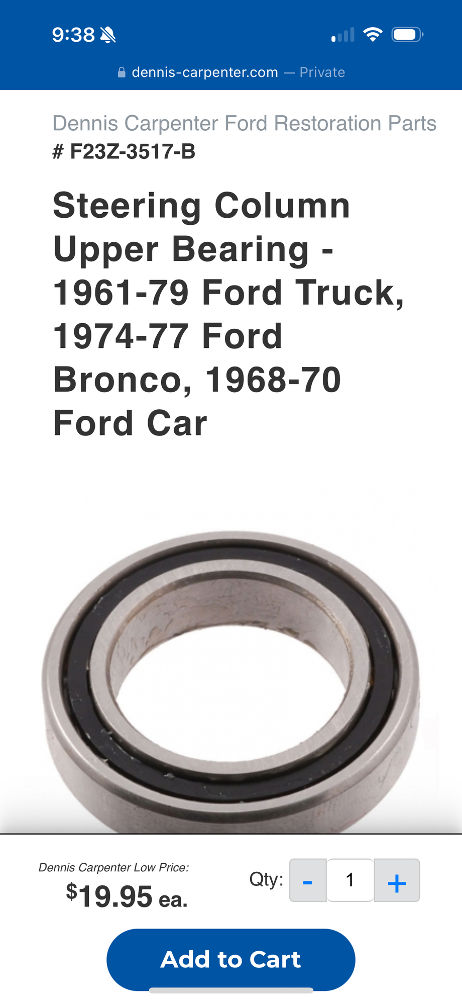

Below are screenshots of what DC has listed as replacement parts for the columns.
I think this is a replacement for the original style upper bearing? Looks like it would still require the plastic bushing maybe?
