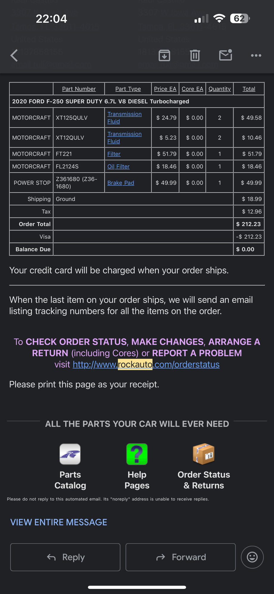

Two 5qt jugs of Motorcraft ULV at $24.99ea and two quarts at $5.24ea with tax plus shipping minus 5% discount is $75.45 from Rockauto. Or apples to apples 12qt at $5.24ea is $77.91 shipped.

Well, I sure missed out on that one.
Didn't come up in my searches, and nobody else was even close to that cheap on motorcraft.
