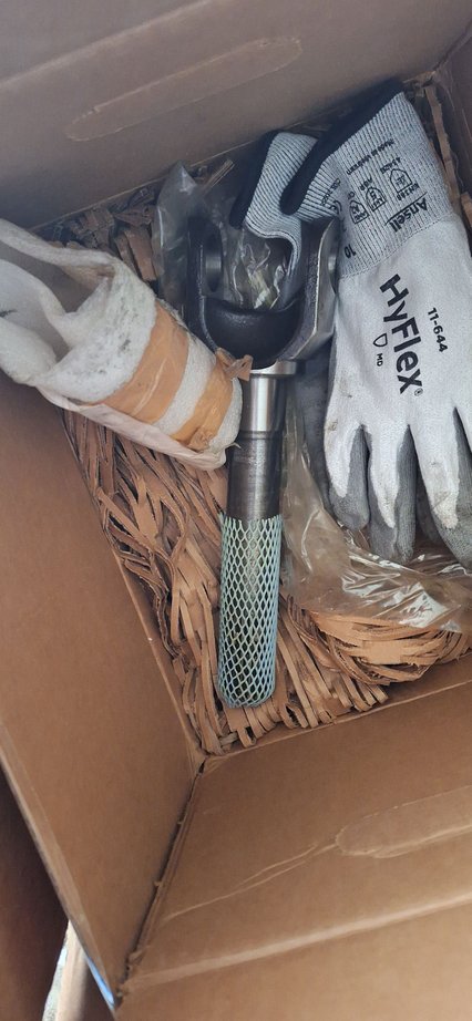

New stub axle, looks prety good.

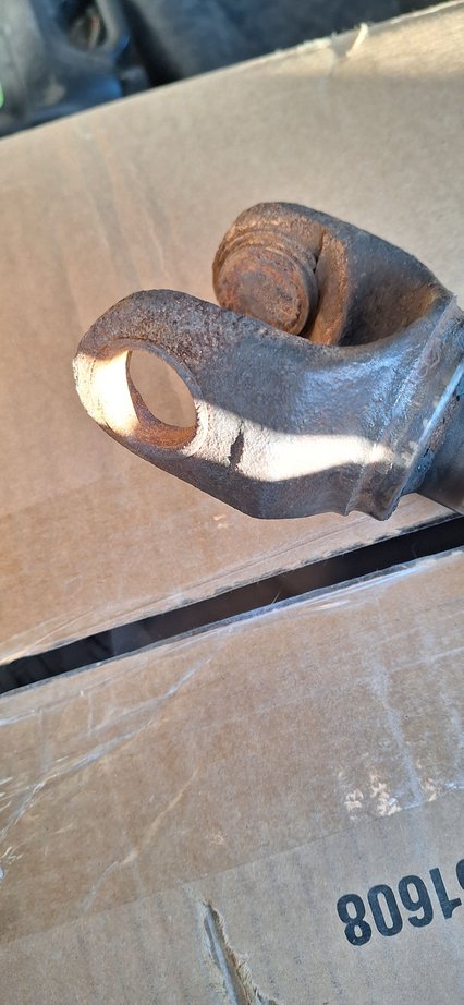

Well it was a hurried day so I only managed to get one pic of the spindle during the job. But, have one of the old stub shaft. And remains of the old u joint.
One side sheared off clean at the cap, and the other, well the part of the cap that contacts the yoke is there. The end of the cap is gone and the companion cross piece of the joint was also missing.
The stub shaft looks okay at a fasy inspection, and i will soak it in Kroil and work at getting the old pieces out of it eventually.
The new stub was fantastic looking, 4340 steel and machined beautifully. Only issue on assembly was the heavier duty ujoint i purchased had beefier caps....causing them to not fit through the opening in the spindle. I ended up having to use a file and massage the edges of the cap to get it to slide through and even then I used a deadblow to get it in. But after that it all went together wonderfully.
