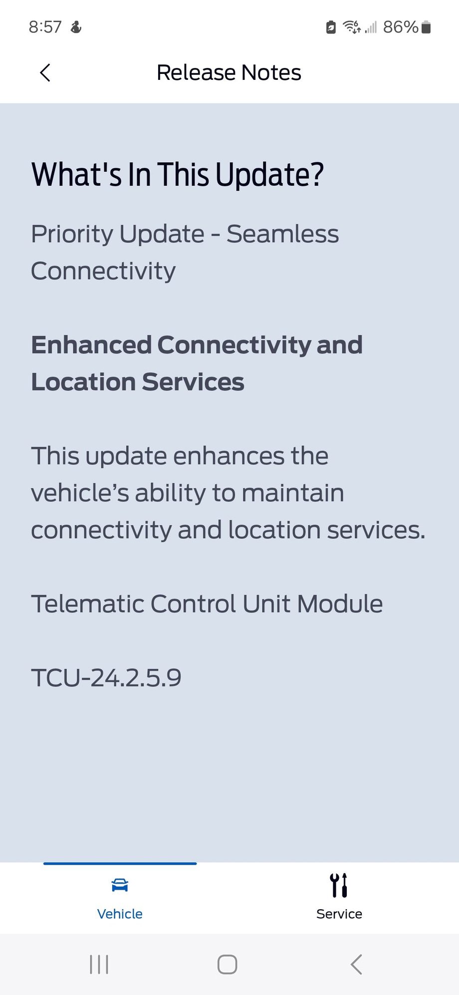

Just looked at my Ford Pass app and see that this update was installed on Feb 25th for me. TCU-24.2.5.9
