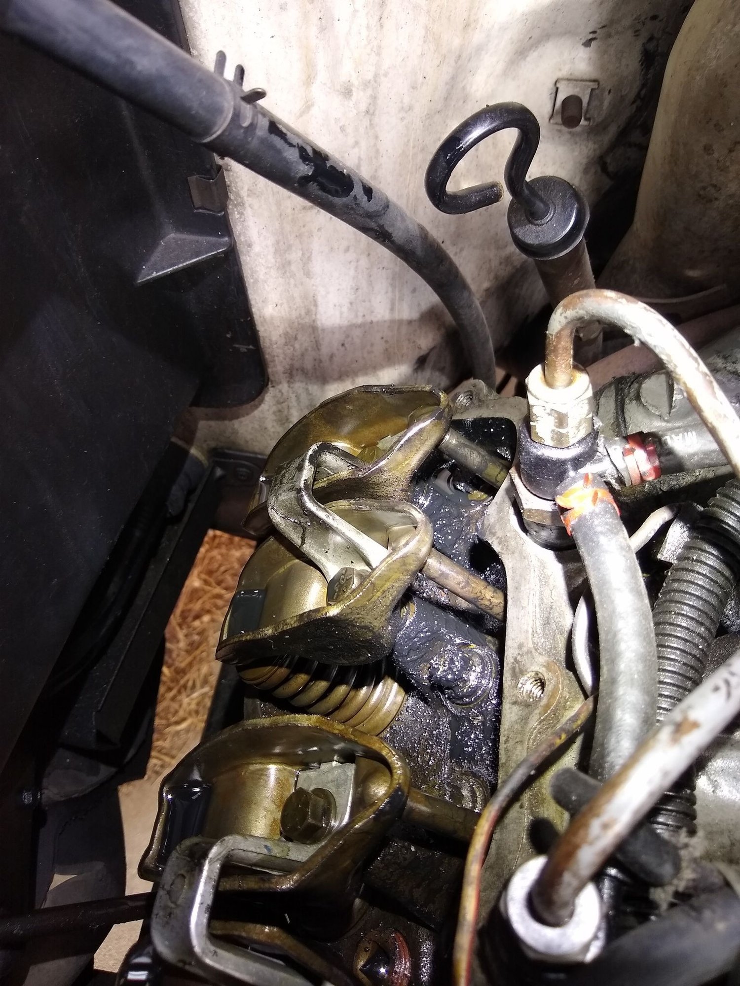

I got a chance to pull the valve covers today. Nothing really jumped out at me. The rocker pedestals on cylinder 7 seemed to have more oil/sludge around them then the other cylinders. Not much though.
I also cranked the engine from the solenoid (with the key off so it didn't have fuel) with the valve covers off, and everything seemed to be moving as it should.
I think my next steps will be compression and leak down tests.
