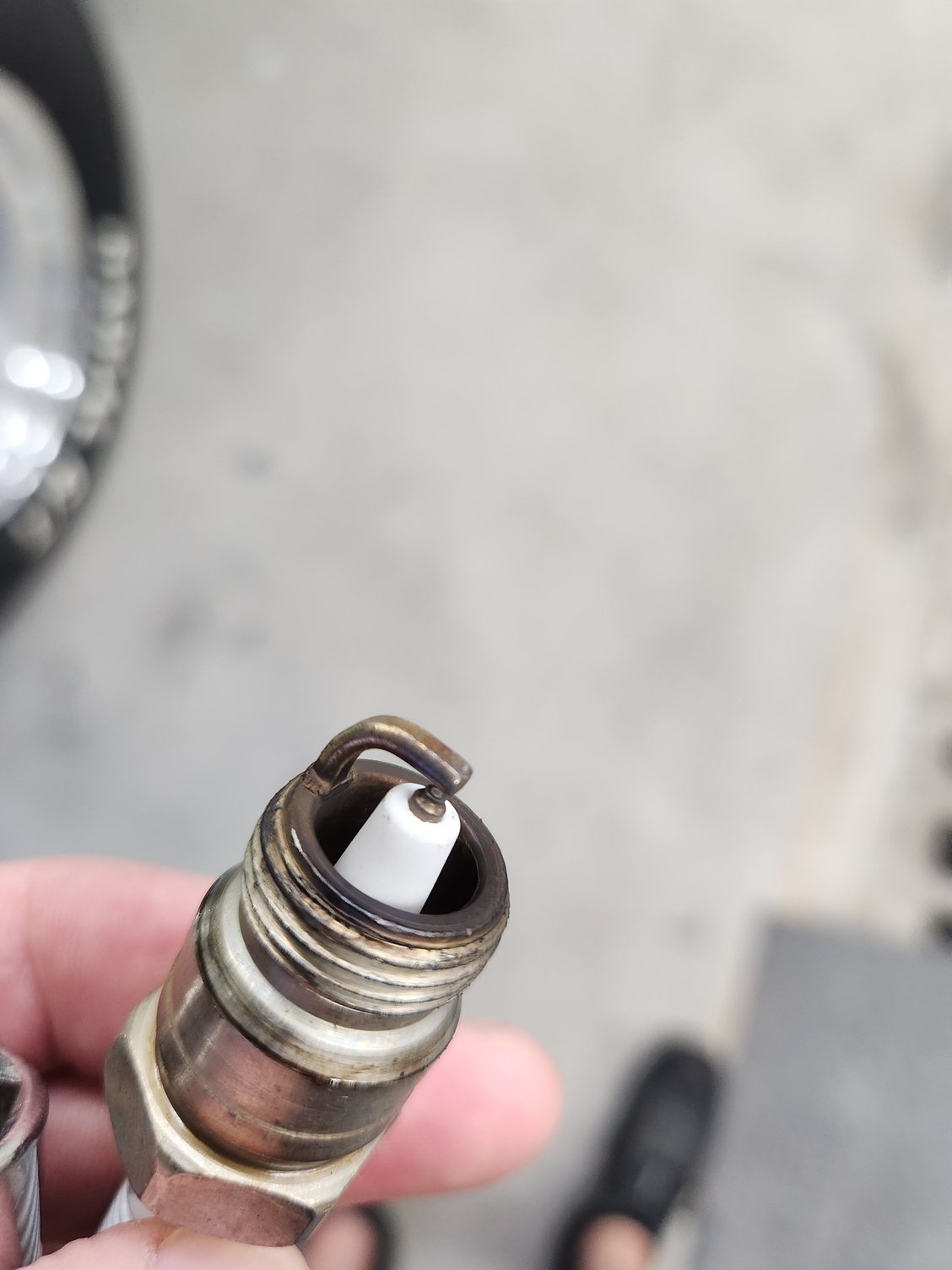

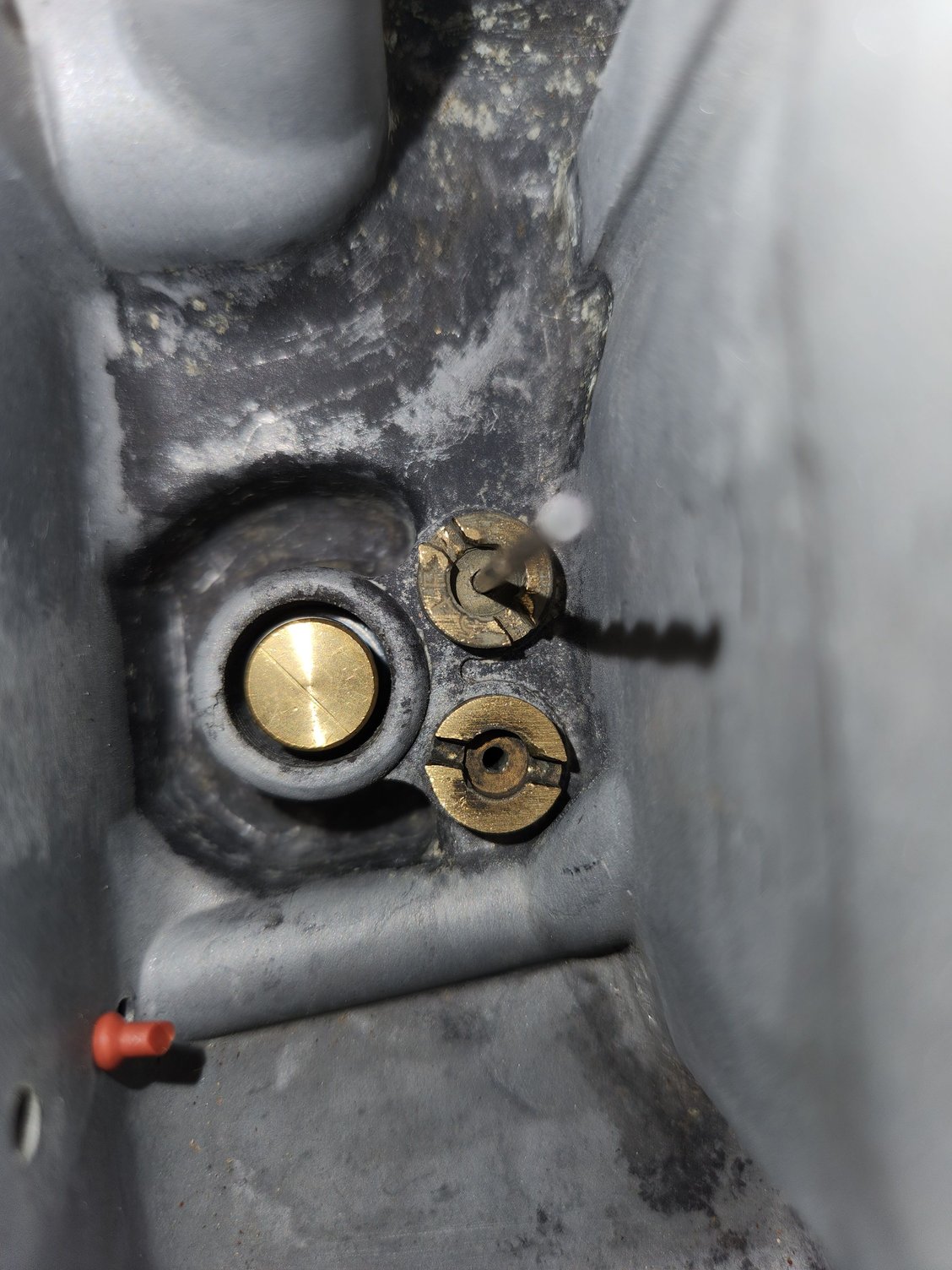

rebuilt the 2100 on mine. it was burning hot. previous owner had too small of jets. after rebuild and fixed the wonky set up on the manual choke. things started running a ton better. I have a box of spare parts off ebay spring/jets/linkage screws a plastic tub of spare parts. I only needed a few parts but it was a grab bag of items. if you need something I can fish around.
