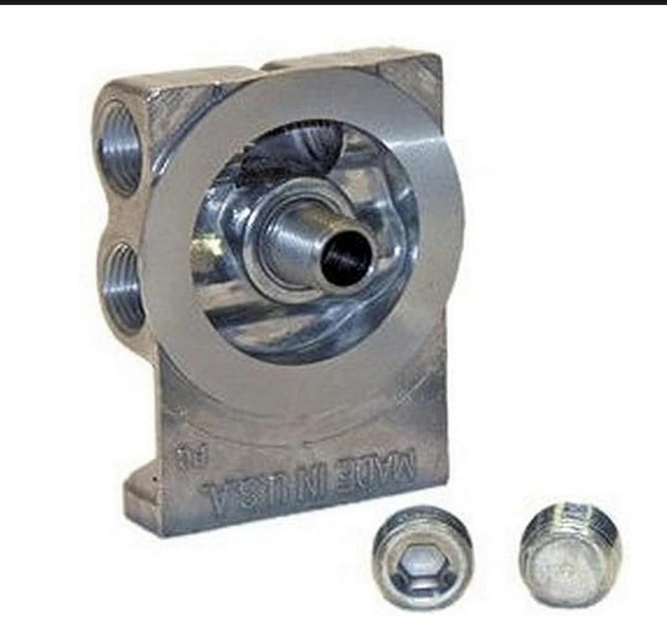

I am finally getting around to installing a different pre pump filter. Currently I have the small clear wix inline filter, though I have had trouble with gelled fuel clogging it when it gets below -20.
Going to try a screw on filter base, though I can't mount it in the same spot, it needs to come back toward the tank where there is space for it.
For anyone who's done this, did you just cut into the hard line and run flexible fuel line to the filter nipple inlet? If I do this should I flare the fuel line? Or did you take the rigid line off all together and do flexible from the tank to the filter?

Thanks for the replies. I ended up just routing about four feet of flexible line back from the hard line to the new mounting location and ran line to the pump from the new filter housing.
Didn't really like adding about six feet of line for the pump to pull through but probably won't change anything.

Yes, moved it back. Between fuel tank and transfer case. Made a 90° out of 3/16 plate, drilled it out for the housing on one face and existing holes in frame on the top. Kind of protected by the T-case when mounted.
Got four feet of fuel hose, connected to end of hard line and ran it back to the inlet of the new housing.

Seems that flex is usually double clamped at barbs on filter housing but questions remain whether hard line can be cut and flex line slide on and clamped without further preparation of hard line.
we didn't do anything special to the hard line.
just a bit of sand paper, and the special high pressure fuel hose clamps

When I need to put flexible hose over hard line that I've cut, I usually use my double flaring tool to put a little "bubble" at the end of the tubing just to make sure the hose and clamp aren't able to slip off of the tubing. I set up the tube in the clamp like normal, put the mandrel in the tube like the first step of a double flare but I only tighten it down enough to expand the tube and make it just a bit wider than nominal.

I'd call that special prep on hard line. Double flaring steel requires one heck of a tool.
