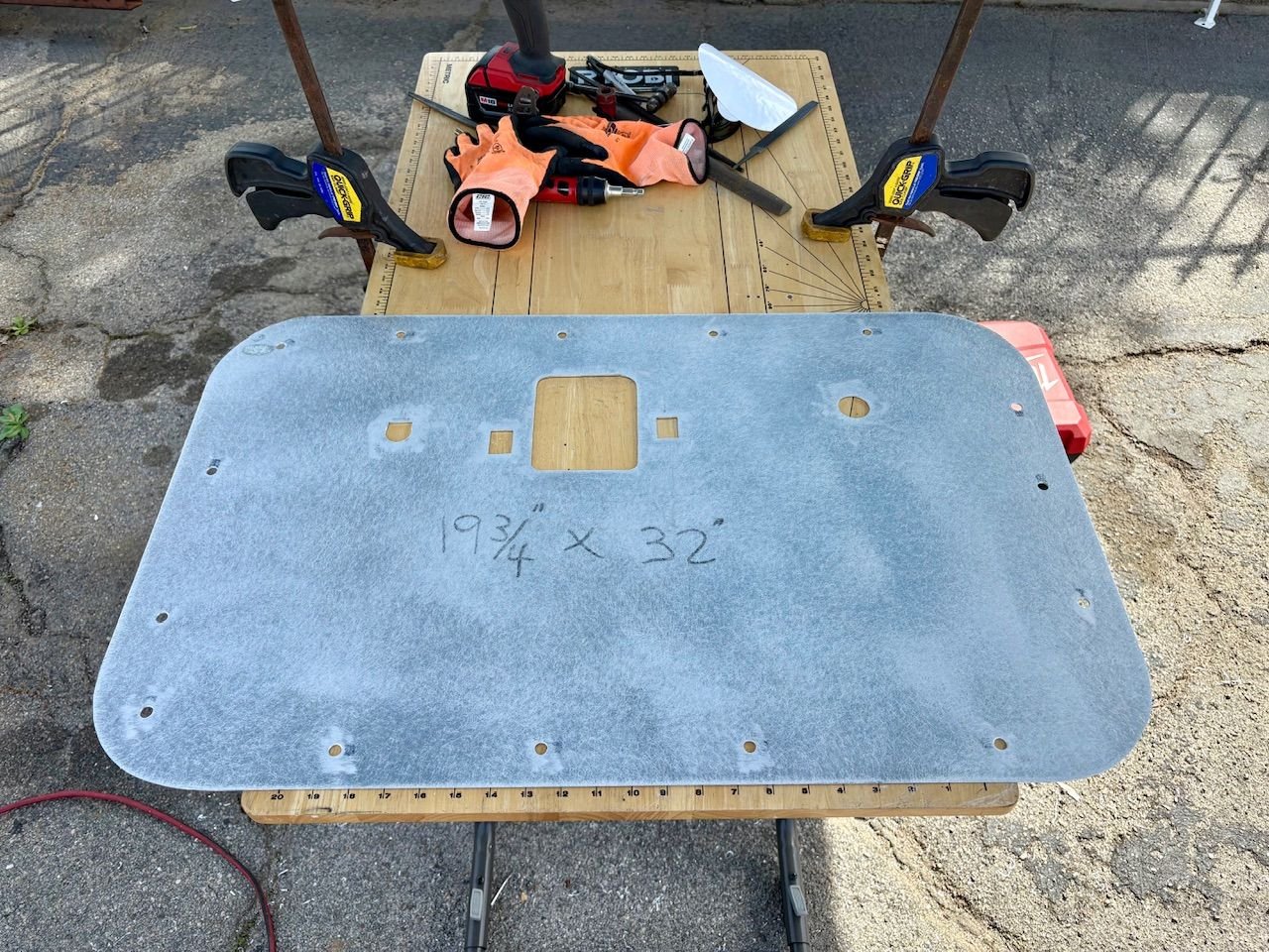

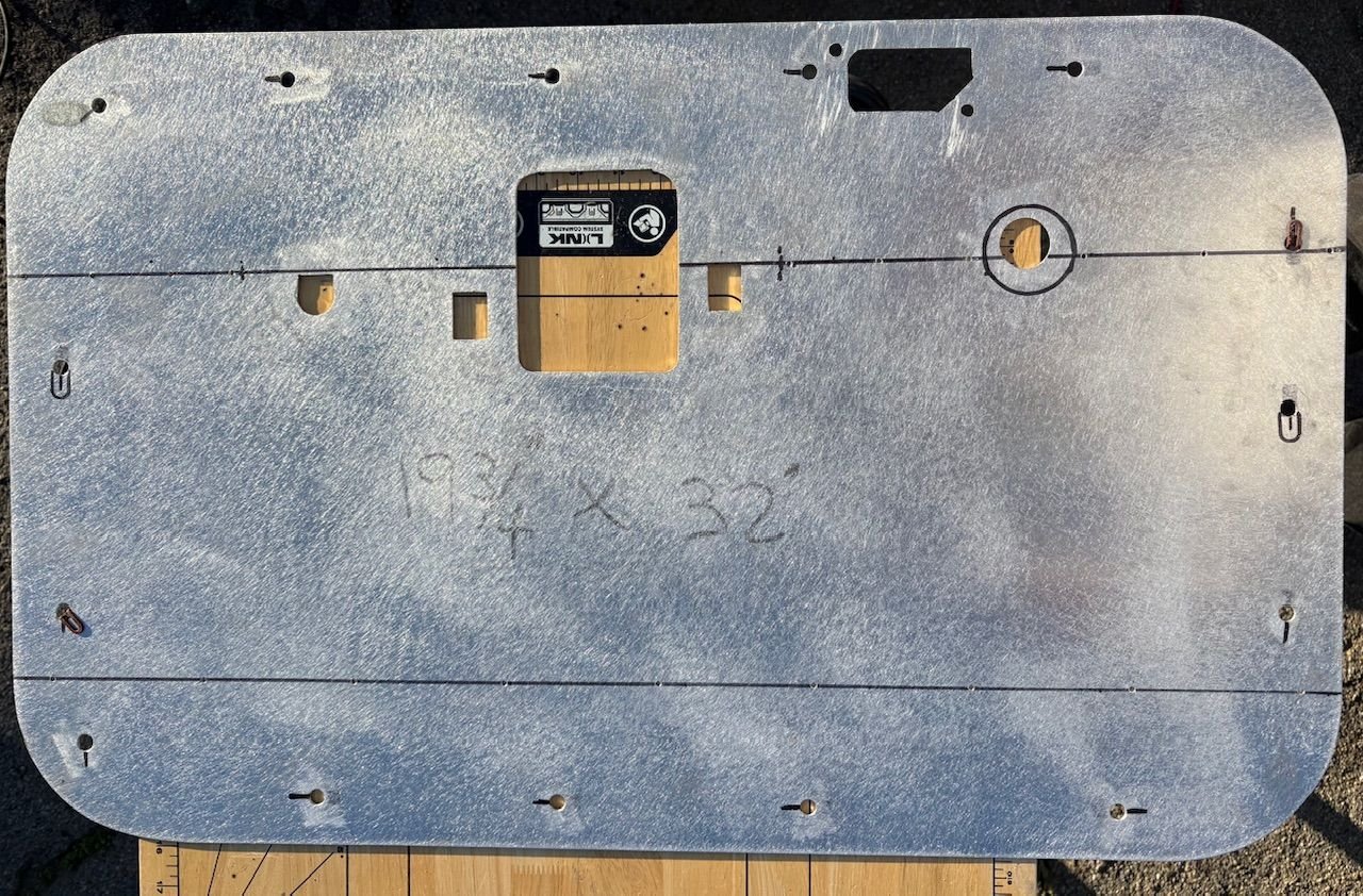

My sport custom door panels have seen better days. The fiberboard is warped and the fake chrome is peeling off of the plastic.
I don’t like any of the aftermarket options so I decided to take a stab at making my own.
I opted for 3003 aluminum as a base.
I have some ideas for overlay material. 🤔

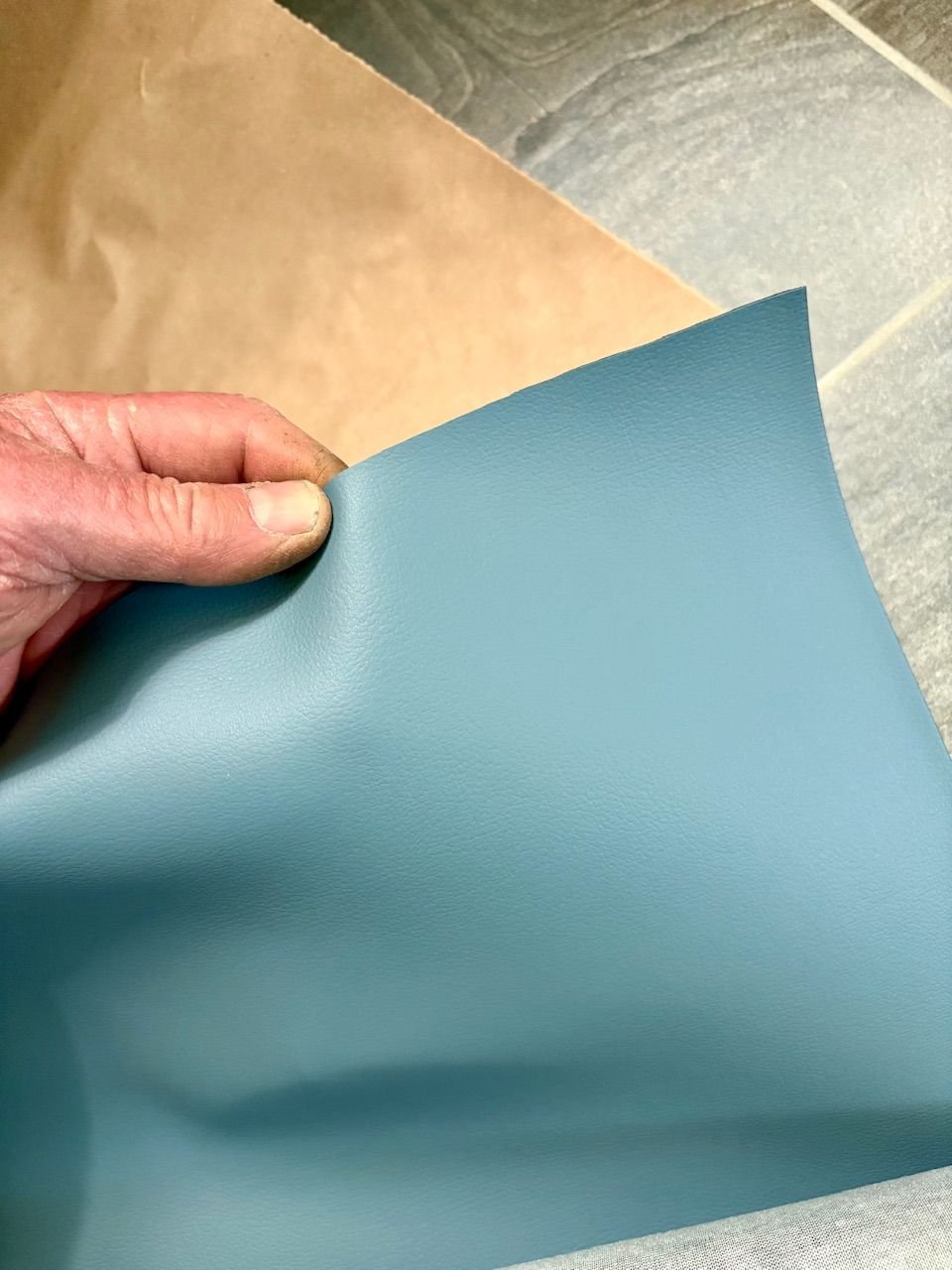

Picked up some vinyl and some tweed. I guess it’s kinda hard to tell the real colors from an interweb pic.
I’m still waiting on some sew-foam and some acrylic felt to arrive.

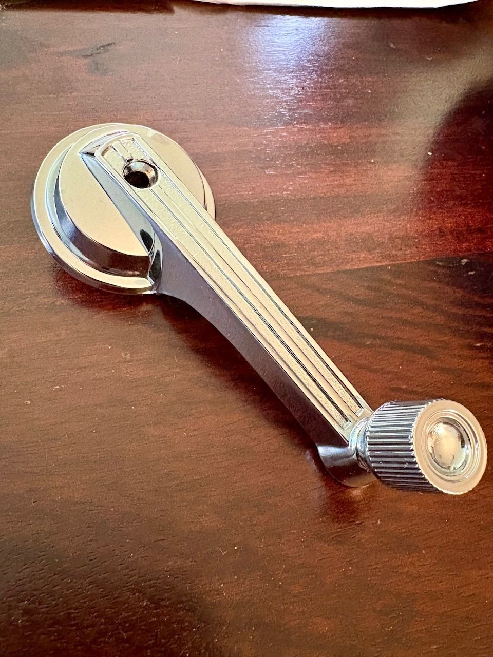

Also picked up these sweet NOS 1965 Mustang window cranks

Will those 65 Mustang door handles fit a 1967 Ford F-100.? Or are you using them on a 65 Mustang.?

The stock panels are sport custom so they are just one color with the narrow “chrome” plastic trim.
If all goes as planned, these will be two tone, vinyl and fabric with some polished aluminum to separate the two fabrics, stock armrest and 65 Mustang window cranks. Also, the driver side will need a provision for the remote mirror control, as I am using 1969 Mustang sport mirrors.
I’m using them on my 72 truck. I expect they’d fit a 67, too.

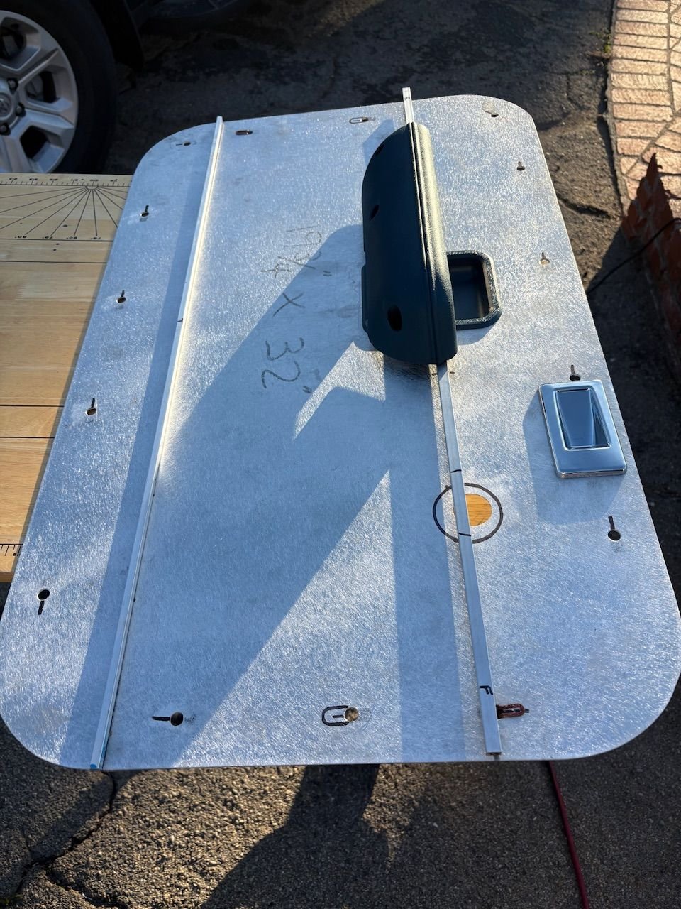

I finally got back on the panels today. I’m starting to see my idea a little clearer now. I got the bezel in for the remote side mirror control.

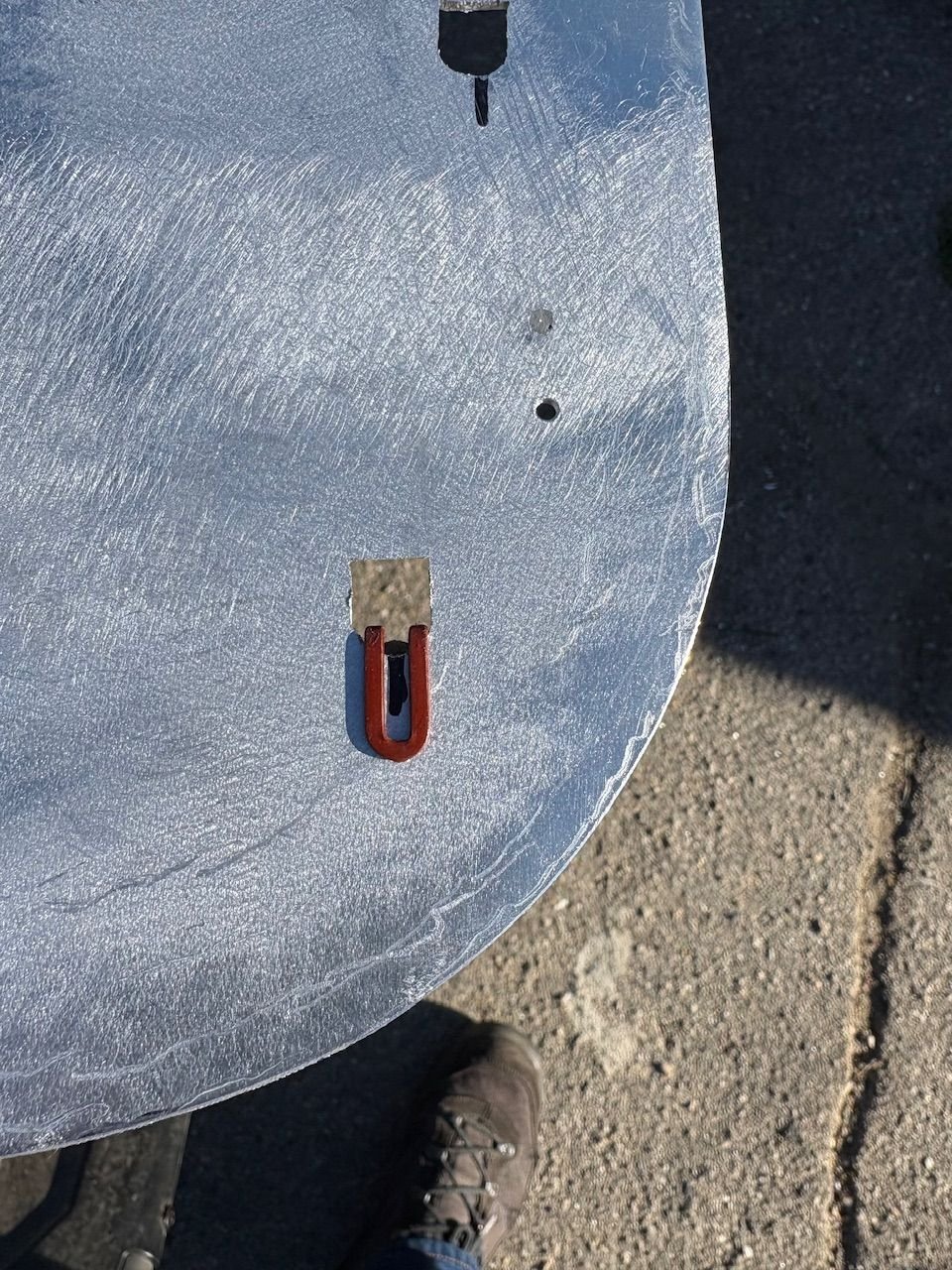

Hand filing d-shaped panel clip holes is tedious work. You can’t just drill 3/8” holes and stuff the clips in because it spreads out the clip and they’ll be loose and possibly be visible behind the vinyl.

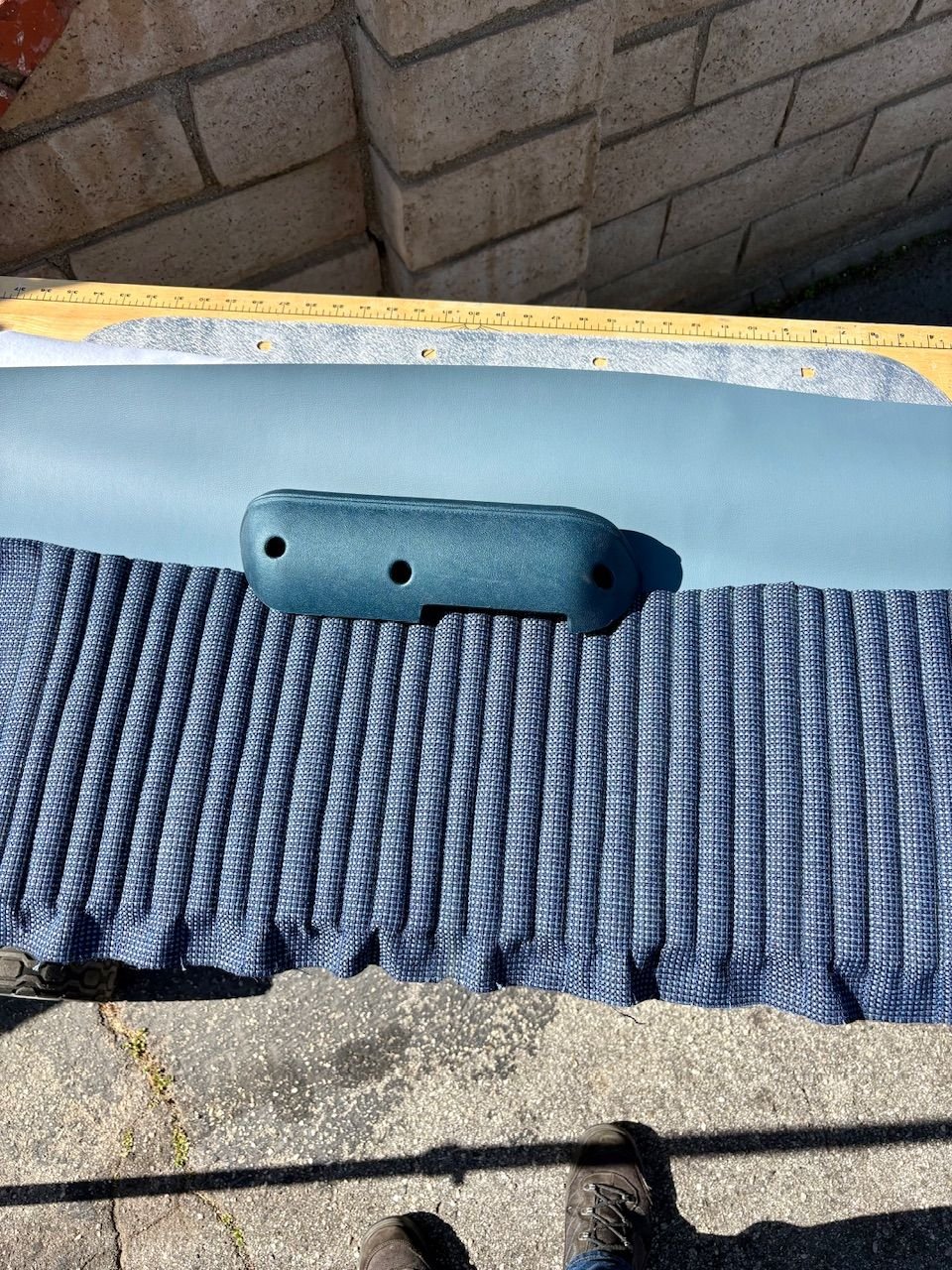

Still feckin around with these door panels. Seems these colors should go together.

Looks like a good color combo!!! Nice work on the pleats.
