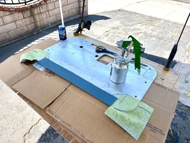

I’m using this stuff to glue foam and acrylic felt to the vinyl

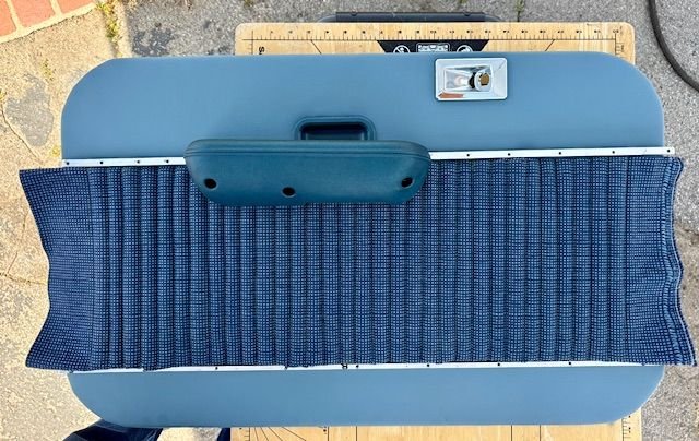

Upper and lower vinyl glued in place.
This is a mock-up. 1/2” aluminum square stock for upper divider and 1/4” stock divider will be polished and installed with countersunk stainless screws, the pleated tweed will be the center filler panel.
