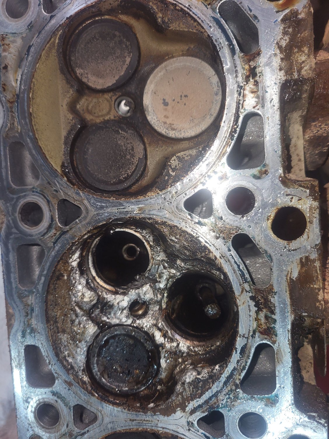

Got my motor apart today, definitely shot. Whole piston is missing. Anyways, beyond repair. Deciding between a cheap used 5.4 and sell the truck or a brand new 5.4 and keep the truck. Mileage is only 168k on it and it is a manual....

Nope, gonna keep it. Getting ready to pull the trigger on a new Fraser 5.4 3v. Does anyone know if the clutch is the same between a zf5 and a zf6 tranny? I have an old broken superduty with a 5.4 2v/zf5 with a brand new Luk clutch kit in it. Will it swap into my 5.4 3v/zf6 ? Rockauto shows the same part numbers so I think it will. Just looking for more real world verification. Thanks in advance
Also, where did my piston go?

Well, the pieces of the piston are obviously in the oil pan unless there is a hole in the block (doesn't appear to be where a piston would "shoot" out of the side though) but damn, that's crazy. As for the swapping portion, I wish I had more knowledge but don't. Personally, I'm not a fan of the 5.4 due to all the valvetrain issues they're known for but I understand that they can be okay if well maintained. The thing is though, I've heard of people that have maintained them well AND THEY STILL have issues. So, I wouldn't want to deal with it. But, I understand if the truck has semi low miles and/or is in good condition otherwise. Trying to swap with something completely different is stupid in my opinion so going with the same engine is obviously easiest. I would say to go with whatever your budget allows though really. If you can afford a rebuilt motor, then I would try to find the one that has the best reputation for quality builds and actually stands behind their warranty and go with that one even if it's a few hundred dollars more. Outside of that, just keep your oil changes to full synthetic and no more than 5k intervals and I would think you "should" be okay for 200k or more. But again, you never know. Good luck.

I agree. I've read that a lot of these issues are addressed in the rebuilt motors. I'm going with frasers top level build that addresses all the TSB's that have been issued for the 5.4. Truck is in great shape otherwise. Extended cab, 6spd manual , 4x4 superduty. Used to be a forest service truck so it's been well maintained. Low mile's (168k) for its age.

Never used Frazier. I've used powertrain products, jasper, national etc. Jasper pays labor on warranty repairs. They pay double what i charge to swap one so i tend to like those on customers cars.
No doubt, like you, I'd fix my truck with a new 5.4 assuming it was not rusted out. 168k miles is pretty early for a 5.4 to fail and I'm no expert but a piston evaporating isn't usually included in the phaser/ rattle issues. Lol. They usually sound like hell for many thousands miles before top end failure.
