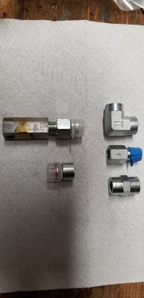

I built a custom tool to go from the STC fitting lines to the oil rails to connect to shop air and pressure check injectors, heard no air hissing out(had valve covers off and oil filter out, no bubbles)

If I understand correctly you haven't actually verified the presence or absence of high pressure oil? Is it possible there is a leak resulting in zero pressure and you are only seeing the default pressure through the scan tool? If so, do you have a way to dead head each side of the hpop one at a time to see if it then starts and runs on one side, thus indicating a leak on the opposite side?
I see you used shop air to check for leaks, not sure if that can be 100% conclusive though I could be wrong on that. I do know that in the service manual Ford indicates to use dead heading to check for a leak. I brazed some parts together and bought some parts to make a dead head set and gauge attachment.
