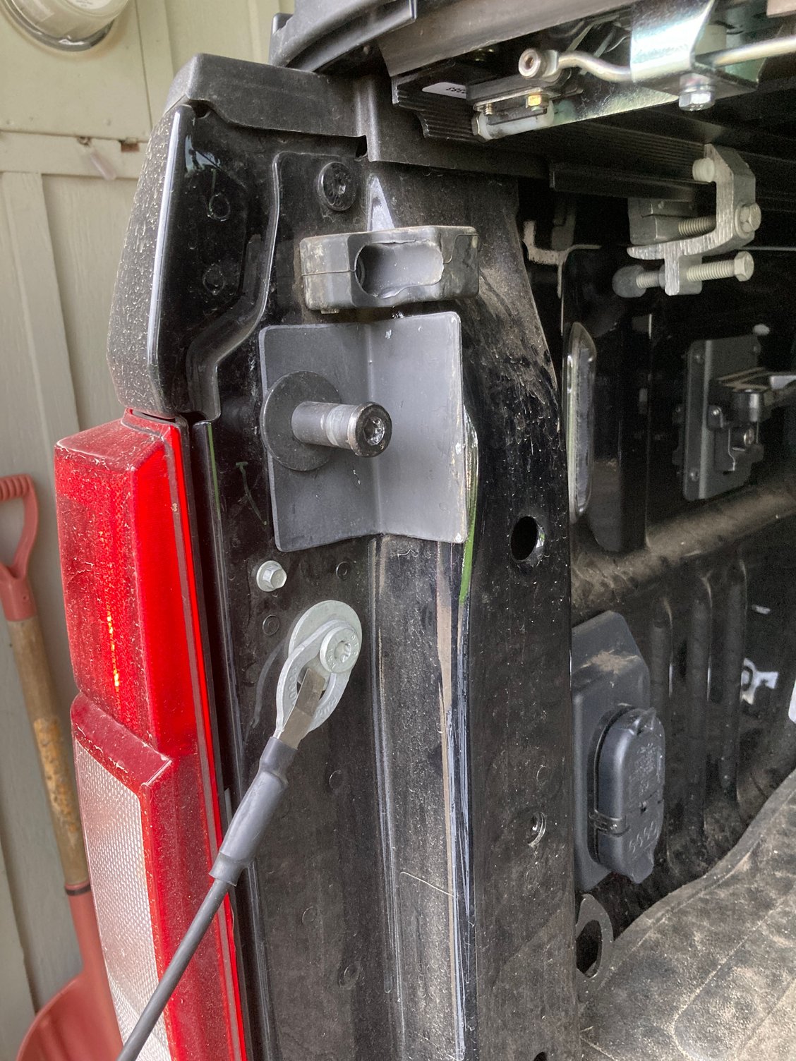

Saw on the news that they caught a tail light theft ring in the Houston / Galviston area. The article said that police are warning to take precautions against theft. I have a tonneau but did this in addition. Only did one side as the tailgate won't open unless they get at both latches.

Did you make this?

It's just a steel angle with a hole drilled in it for the latch to bolt through. Simple to do.
