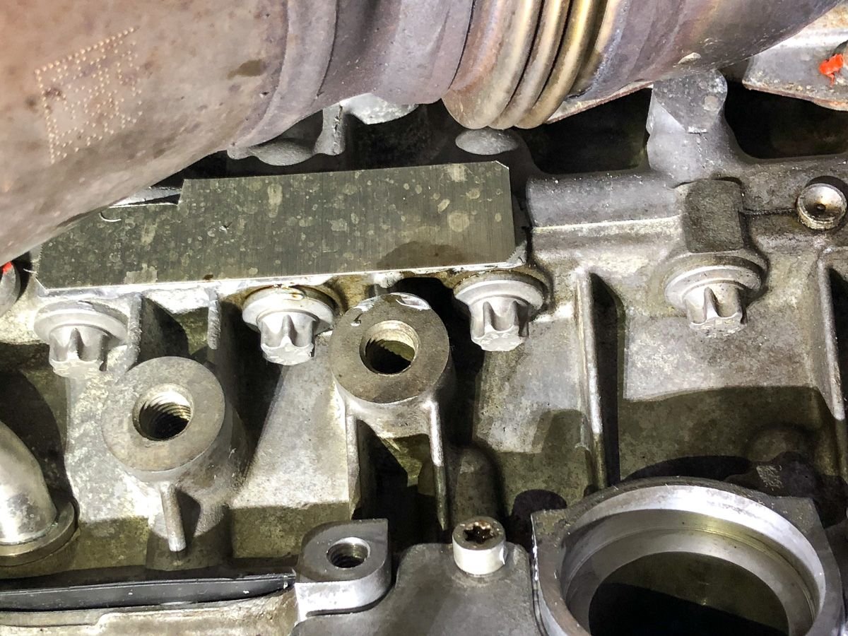

I had some oil leaks in the bedplate seal on my BMW 6 cylinder - huge job to repair. I ended up cutting some pieces of aluminum in long rectangles, cleaned up the outside of the block where the leaks were with brake fluid, roughened the area with a small burr grinder, then used fresh silicone gasket sealant with an aluminum cap to seal the leaks. It worked and has held for years. If you can see where the leak is and if its not too bad, this might be possible also....
Oil leak repair - aluminum rectangle, silicone gasket sealant

Brake FLUID? or brake CLEANER?
just wondering
