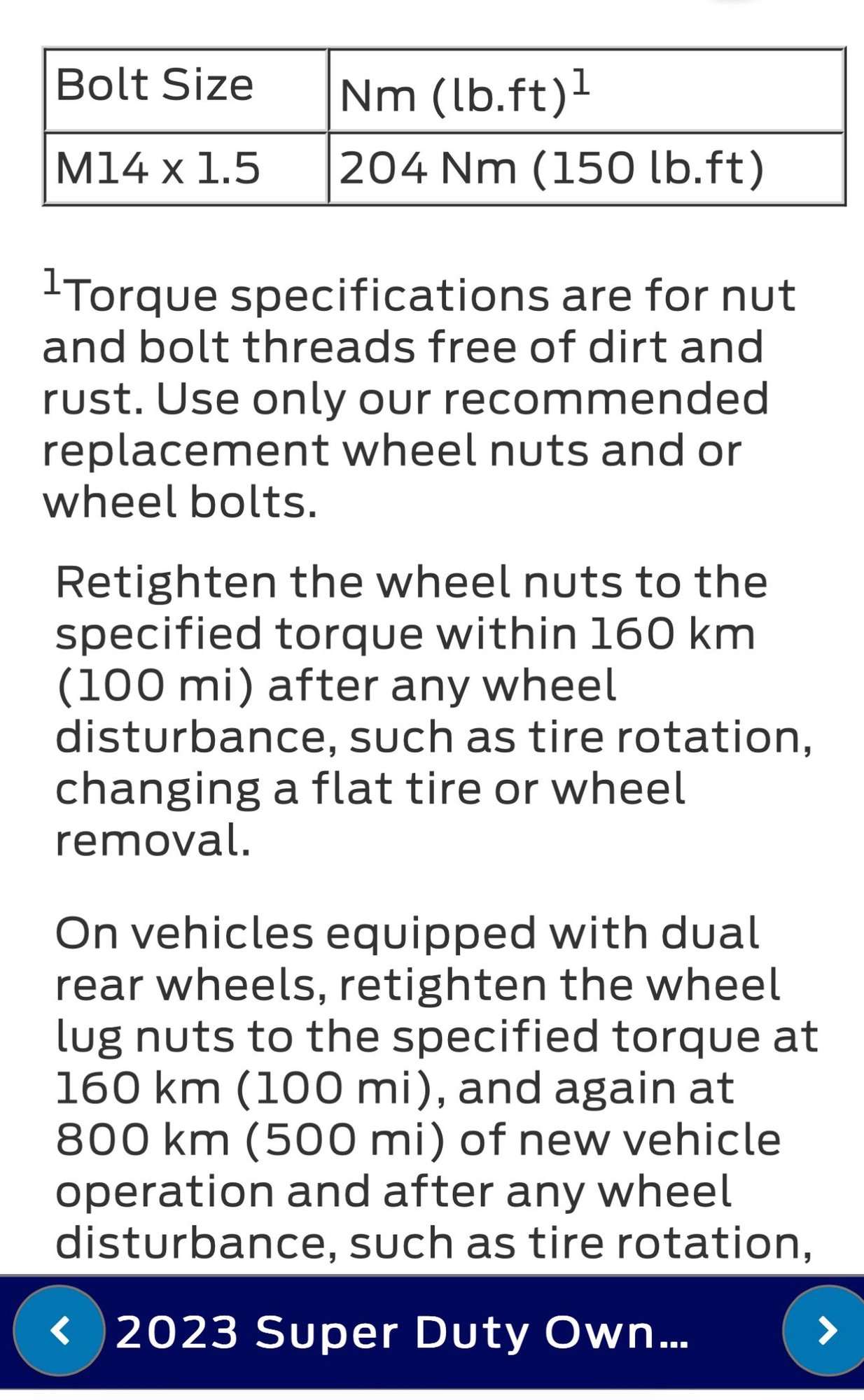

thinking about purchasing Gorilla solid wheel nuts in black for my truck and wondering what the spec is according to you guys. Seeing some inconsistent info just searching. my truck is a 24 f-250 xlt with factory 20" carbon gray wheel option. Thanks in advance

On my 2013 and 2019 the lugnut torque is 165 lb/ft

Rangervx, in the online HTML version of the manual for my 2024 F-350, under the tab, Changing a Road Wheel, sub tab, Changing a Flat Tire, list directions for changing a tire on everything from an F-250 to F-600, and the sequence for torquing the lug nuts, but no torque value is shown. Under the sub tab, Wheel Nuts, it list only one bolt size, M14x1.5, with a torque of 150 lb.ft. The photo that accompanies this information shows the back side of a 6-lug wheel.
I’ve found so many errors and so much mis-information it the manual it’s hard to trust anything.
