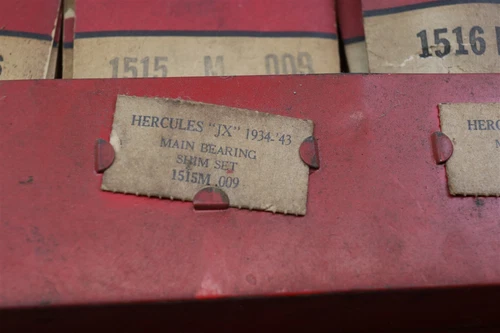

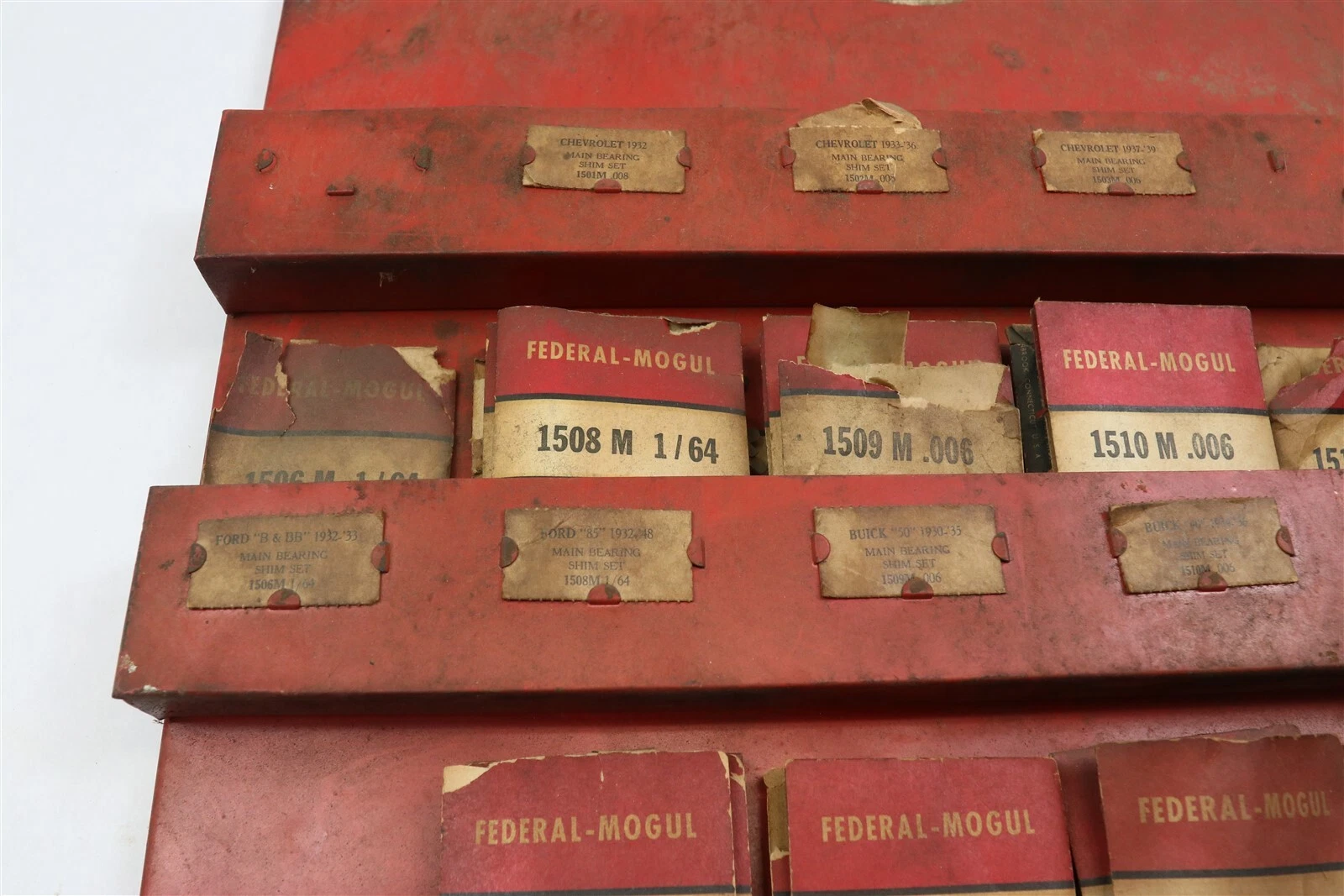

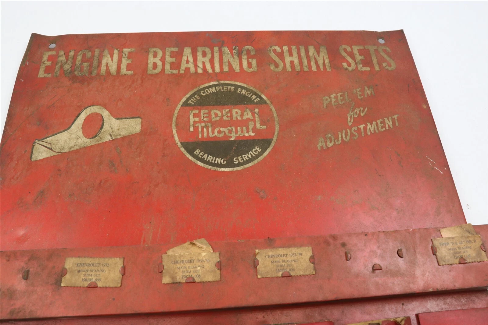

So I'm waiting out the cold today and watching the snow flutter, sitting around window shopping on ebay, and I run into this display of engine bearing shims. Is there someone here old enough or experienced enough in building ancient engines to teach me how this works? This must be some kind of "fix" that avoids machining and purchase of under/oversize bearing inserts, or with babbit type? There are shims for main bearings and rod bearings in the packages. Curious.

The Stovebolt Chevys came with shims in the rods between the rod and caps. Whenever the engine got 40-50k miles, you would drop the pan and remove a shim or two. These engines had poured rods and caps so this was the only way to adjust the bearing clearance. When the engine was rebuilt with new poured bearings, the shims would be used again. The Chevy is the only one I am familiar with but other manufacturers used the same concept.
Edit: A little story: Sometime in the mid1950s, I bought a 1941 Chevy that had been on blocks during WW11. It had somewhere in the 40K miles shown so I decided to drop the pan and adjust the bearings. I was so pleased to only be able to remove one shim per rod side.

Ross, look at the picture shown to the left of the Mogul logo in the first pictures posted. These shims were factory-installed and fit between the rod and the bearing cap. Service shims were used by engine rebuilders when the rods were remanufactured with new babbitt or whatever may have been used to renew the rod. I never knew the kind of shim you link to was acceptable or made commercially. Of course, we all have heard horror stories like Big Win mentioned. Working in a junkyard as a teenager, I saw quite a few of these repairs. Parts unavailability during WW11 made many folks innovative. Some worked and some were disasters.
