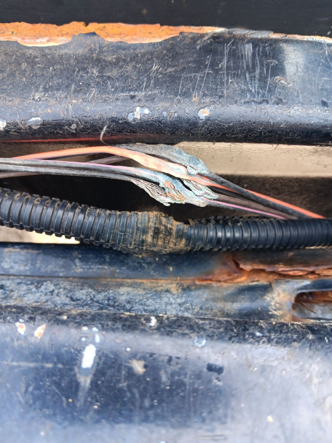

Old Apr 9, 2025 | 02:53 PM
truckermark's Avatar
truckermark
Joined: Mar 2017
Posts: 25
thanks for all help previously. Bed picnched wires finally got warm enough to track it down
Old Apr 9, 2025 | 03:03 PM
crashz's Avatar
crashz
Joined: Apr 2024
Posts: 219
Likes: 84
Ouch! Good find, that must have taken some time.
