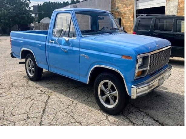

Lots of great suggestions and much appreciated. I won't be able to complete the purchase until the end of the month. The owner wants to fix a few minor things before I come for a test ride like the turn signals and gas gage is a "bit wonky" according to him. He thinks it's the sending unit in the gas tank. I don't plan on doing any power shifting from 1st to 2nd so hopefully it's a minor issue and the guy says it doesn't happen all the time. it has 78K miles and was well maintained so I'm not concerned about the engine. No leaks according to the owner. New interior but has a really bad dash pad. I'm curious about what you guys might think it's worth, although the best answer I ever heard on value is "It's worth whatever you're willing to pay."
Old Feb 7, 2025 | 10:31 AM
FuzzFace2's Avatar
FuzzFace2
Posts: 30,915
Likes: 4,123
From: Angier, NC
A word never so true "It's worth whatever you're willing to pay" LOL
This side looks pretty good take it the other side is just as good?
If you pull the rubber mat back the floor and cab mounts in good shape?
1 tank or dual tanks? If dual it has the easy tanks switching set up of all the trucks like I installed on my flare side.
As a guess a high of maybe 5K if everything is in good shape and working. I am cheap and would not pay that much
Dave ----

[QUOTE As a guess a high of maybe 5K if everything is in good shape and working. [/QUOTE]
$5K? Wow, if you know anyone selling an 81 shortbed professionally repainted a few years ago please let me know, I'll buy 2 of them. The paint job would cost $5K at a minimum..
