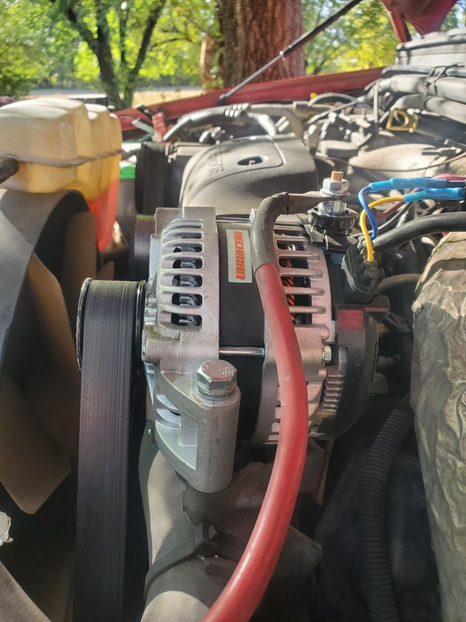

That depends on which battery is being supplied the charging current from the Alternator. In any case, they must be the same Age, and CCA, and brand/model.
on my truck, the Driver's side is the only battery with the heavy 2 ought cable, I have a 340 Amp alternator, so that cable has to be BIG. and I have a Winch that pulls a lot of current when loaded, and I wanted the Alternator to be able to put out enough current at Idle to keep up with the Winch.
Rainmaker has tied both batteries to his Alternator, it is also a MechMan like mine... they regulate at 14.5-15.0 volts,, depending on underhood Temperature.
