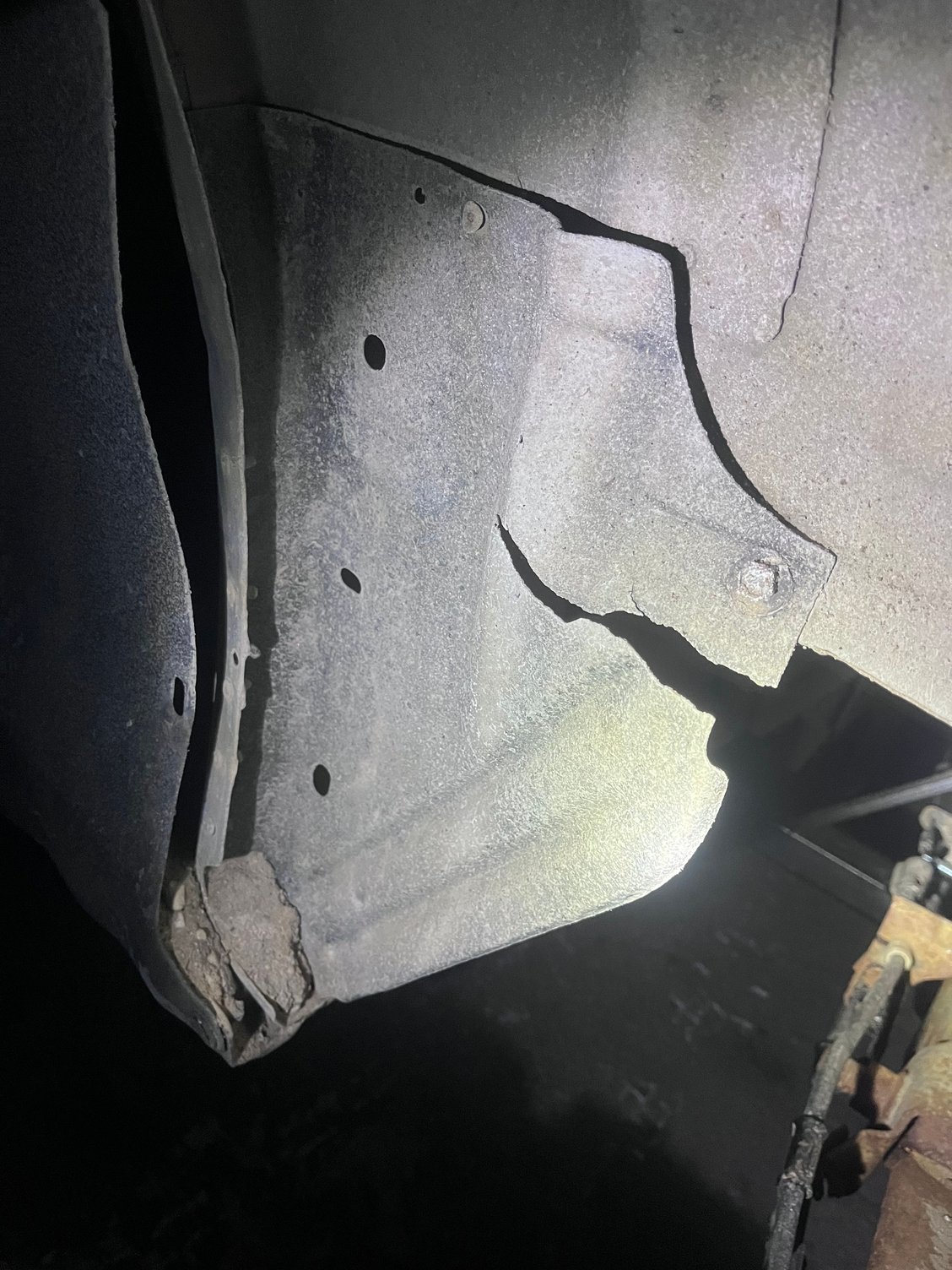

New to Super Duty form, so if not properly submitted, I’m a newbie!
Question rear fender to box side.

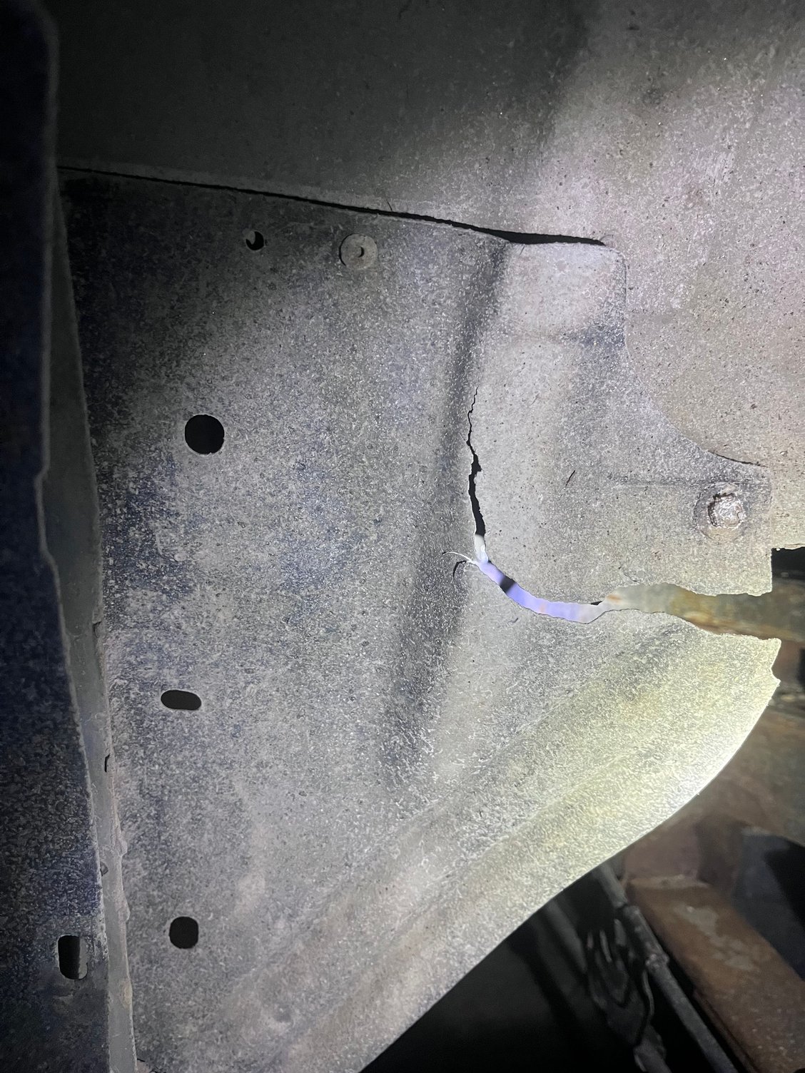

On the front of both fenders there are basically triangular pieces of light metal, riveted to the fenders and then 1 bolt attached to box side/or inner fenders both of these are cracked causing the front of each fender to be loose.
I can’t see these pieces on Ford parts diagram and hope some of you good folks can help me out
pics of cracked part.
This is left side looking forward.
thanks

You likely won’t find those braces in a parts book, it’s a structural part of the bed.
Why would you replace a poor design with another poorly designed replacement anyway?
It wouldn’t take too much to fabricate a much better brace by fishplating the existing sheet metal or from flat strap or light angle.
