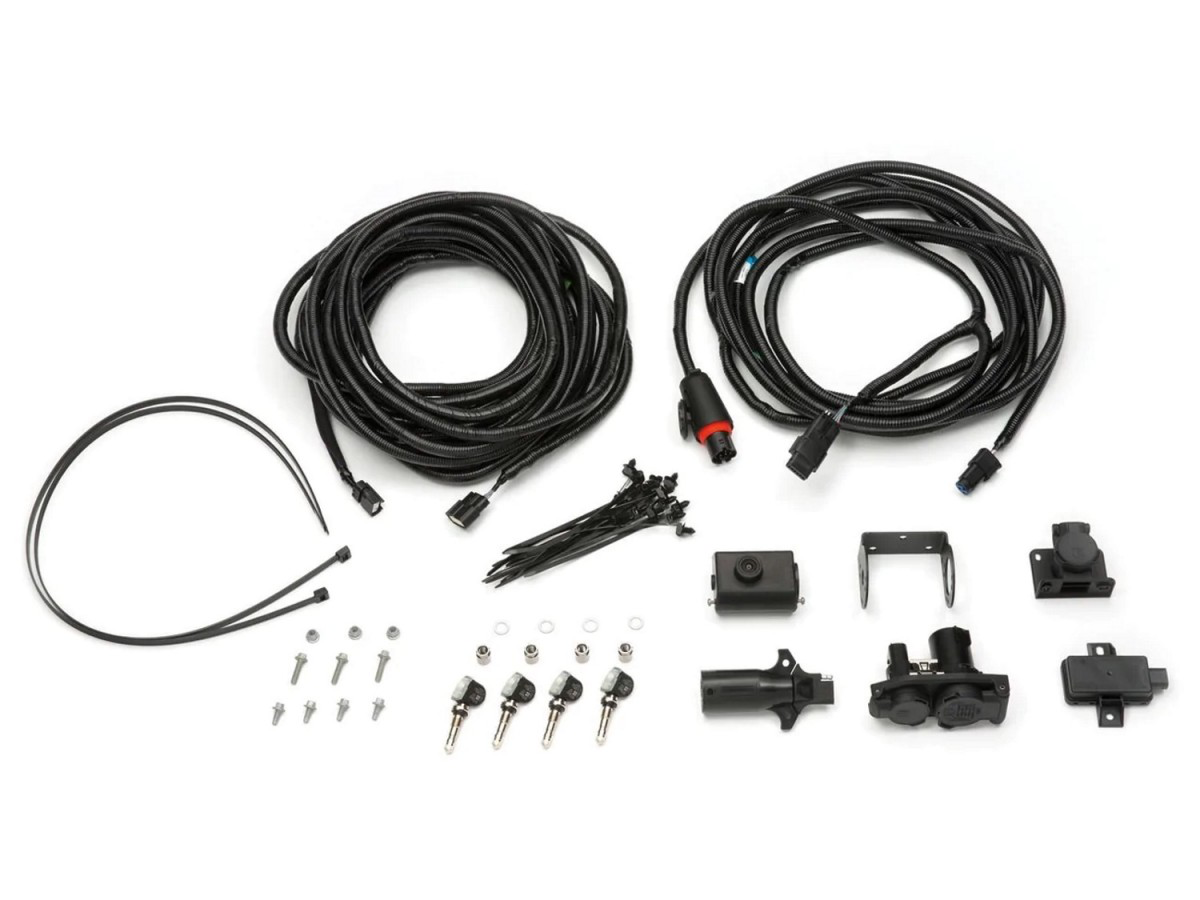

I ordered a different kit then what you are showing, I got this kit for my 24'. Comes with everything but the YAW sensor which should have come with your truck.
LC3Z-1A189-A
Edit* Oh just looked up your part number, that is a newer camera.

Does that have a plug for the yaw sensor? I have the older system from my 2019 on my trailer that does not have the connection for the yaw sensor. I'm looking at changing the harness to the newer harness . My concern is will the new harness be compatible with the old camera?
Old Feb 14, 2025 | 01:19 PM
GadgetB1's Avatar
GadgetB1
Joined: Jul 2016
Posts: 81
Likes: 45
yup, even though the picture sucks it has three connectors, 1 for yaw, 1 for tpms and, 1 for the camera. Not sure on the compatibility with the new camera though.
