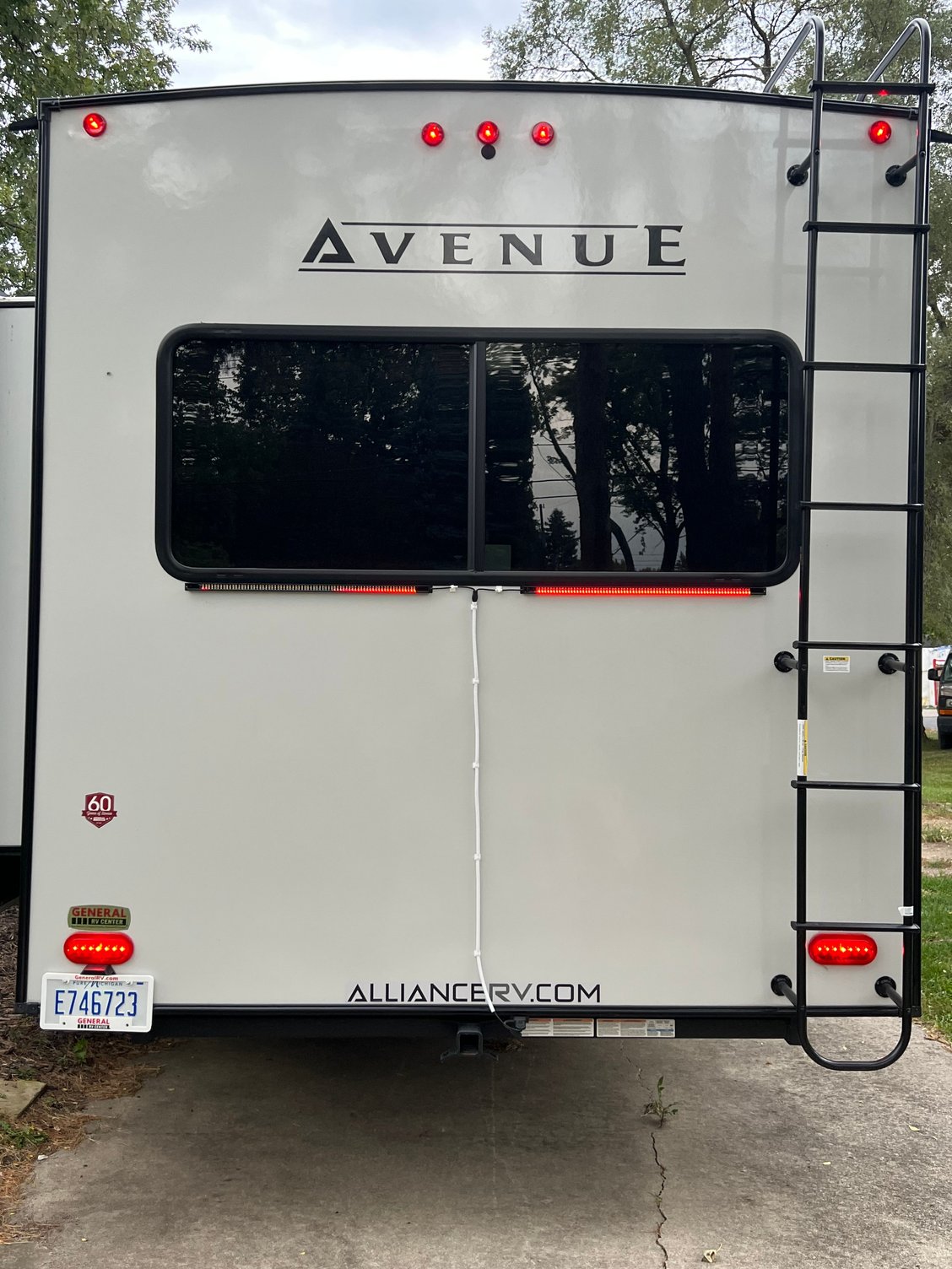

I ordered the harness a while back just ordered the new camera. My 5th wheel is "camera ready" but it's just supplies 12v power to a camera. Looking for a way to get the wire up to the roof but don't see any good way to rout it without major work. I like the idea of just below the back window running the wire up the ladder from underneath.
I ran mine up the center of the back wall.. I really like the view I get. This is before I mounted the camera. It sits right at the center bottom of the window.
What did you use to mount the camera? Looking at similar options, and wasn’t sure if I needed to drill and mount a bracket in the back wall or if you found another option.
I drilled two holes and used the Ford mounting bracket for the old style camera. I'll have to get some close ups of the camera when I get home.
