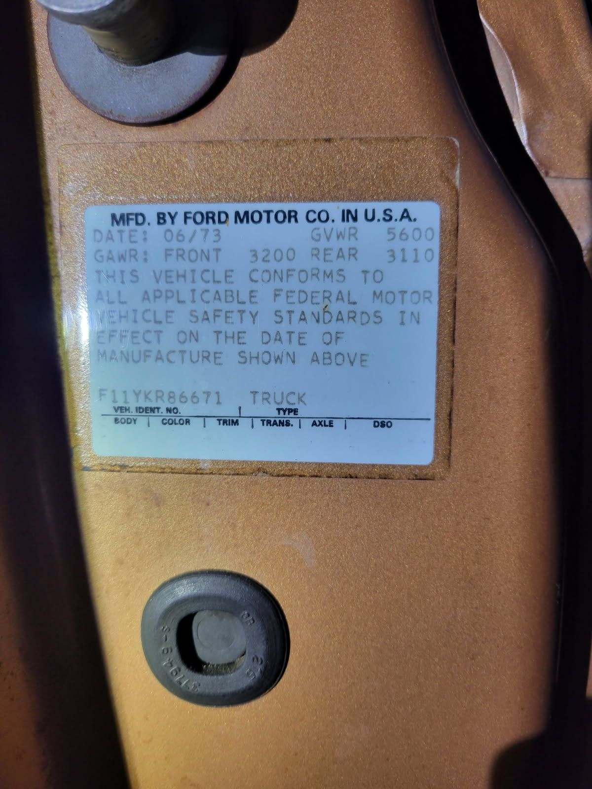

Pillar sticker below. Sorry for the large size. Just scroll it down for the placard info. Thanks!!

Perfect. So 3110 it is.
