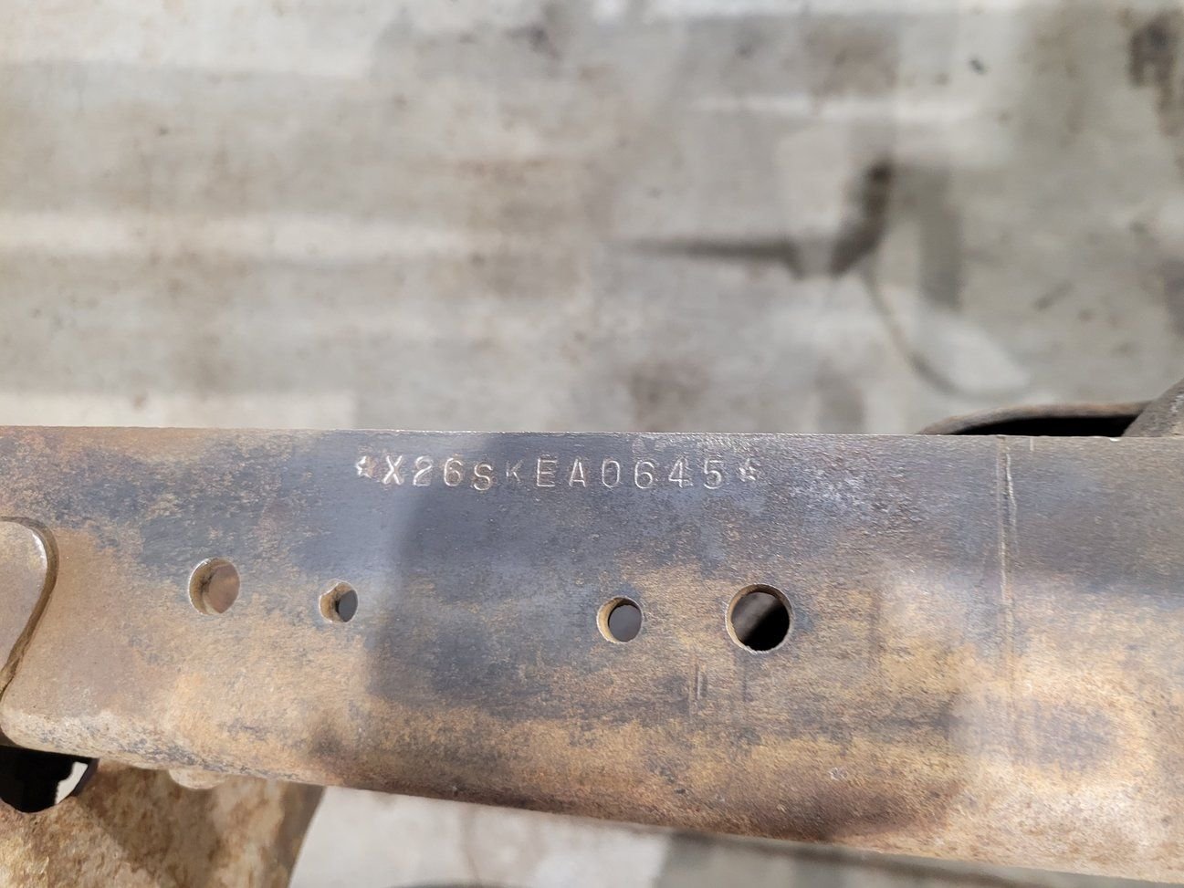

From this I would guess that this is a respray that they swapped the grill on. The Grill/Hood/Bumper are a 79.
https://www.fordification.net/tech/vin.htm
VIN Shows its a 77 with a 351, Manual. Original color was Midnight Blue Metallic; I could be misreading this though.

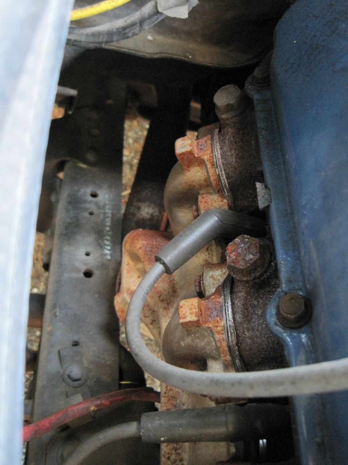

I would make sure the VIN on the frame matches the vin on the door. Should be on the passenger side by the manifold

I agree with others, check the frame VIN to see if it matches the door. There should also be sticker opposite the door tag on the cab that shows the VIN. Ideally all three match, but the one that matters is the frame VIN. You should be able to see one of them in the engine bay, passenger side, top of frame rail. There is another located under the cab on the frame but you can't see that one as easy.

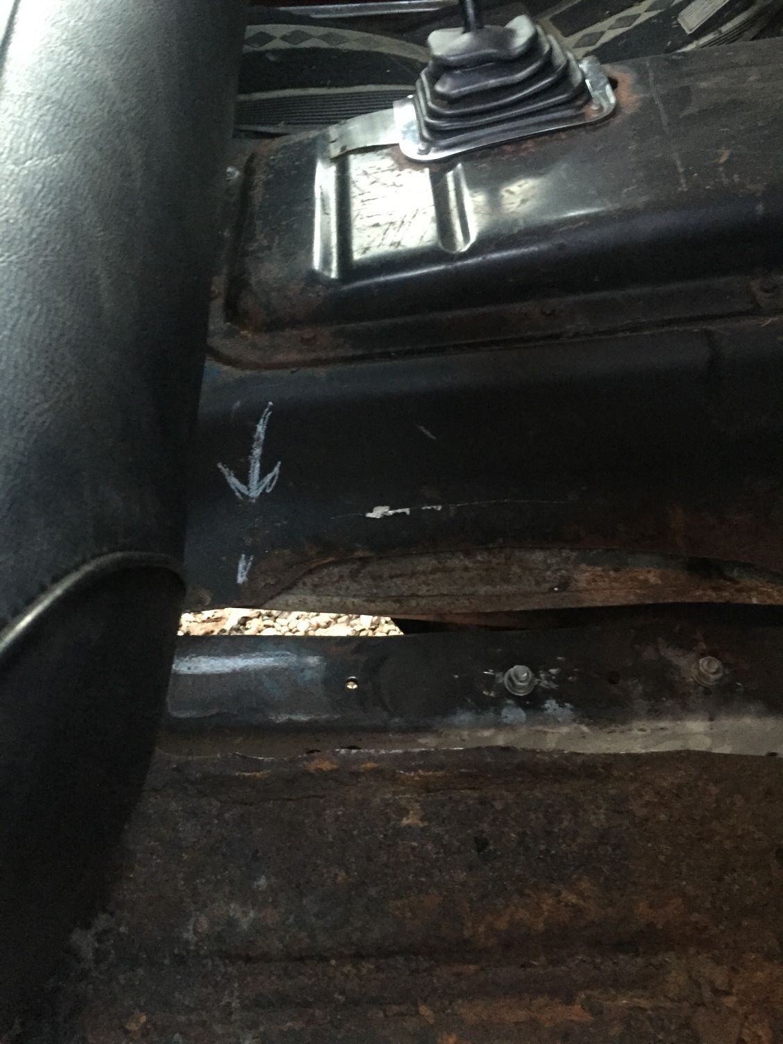

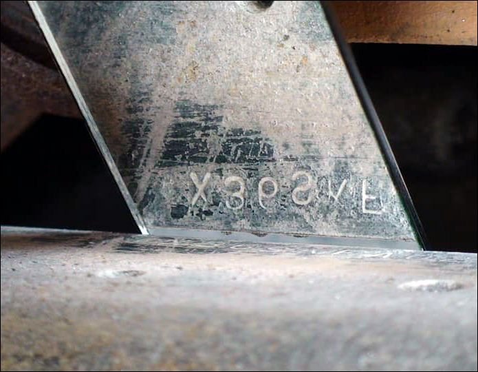

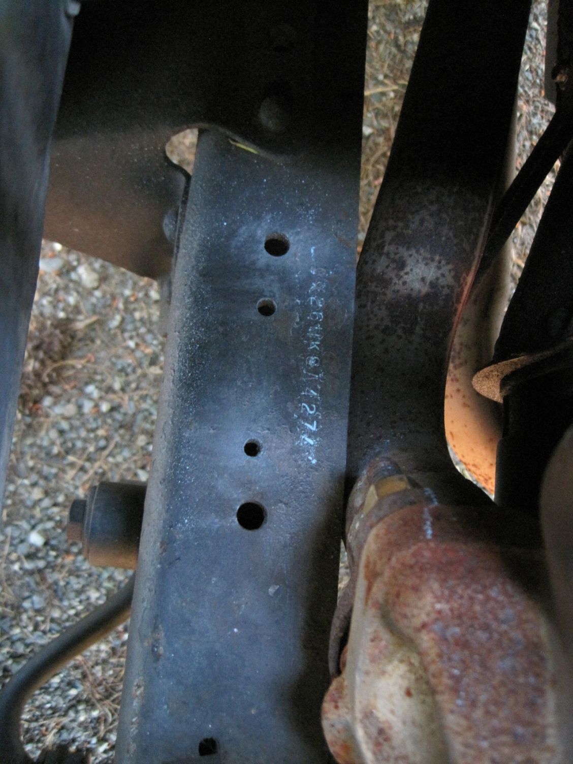

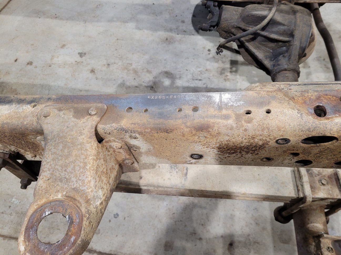

X1000 I would REALLY make sure the Warranty Tag (on the door) vin matches the dvrs side B pillar Safety Certification (white sticker) vin. AND get in the engine compartment or take a snake camera in the passenger side fenderwell and look at the passenger side top of the frame rail stamped vin. Yes just about inline with the exhaust manifold.
You might be able to find/see the other one on the top of the passenger side frame rail about in line with the fwd seat slider bolt, with a insp mirror. Another way to also is check is to measure the rear leaf springs to be either 3" wide 778/79 or if a 73-77 they will be 2 1/4 wide. Then you have a whole different franken truck going on.

White mark on frame is vin. You have 1/2" to 3/4 " between top of frame and bottom of cab. This is just a different view.

Even if you are willing to overlook the flaws it's nearly certain the door tag isn't original to the pickup. so getting the real serial number and a Marti Report would be the only way to know what it is. finding out if it's stolen would be a good idea too.
