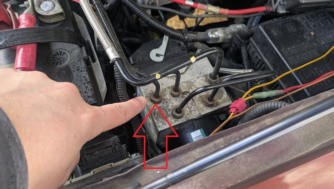

The brake line from the ABS block (behind the drivers side battery) to the front left wheel well rusted through and blew out. Luckily I was in my driveway and didn't hit anything! I just happened to slam my brakes to see how much traction I had in the snow, and lost brake pressure suddenly. The part that rusted through isn't pictured below, it was a horizontal section kind of between the fender and engine.
I'm having trouble figuring out what part to buy. The closest I got is one that claims to be the right part but it's out of stock (and the part number is only found on their web site when I google it), and I also found full front kits that supposedly fit 6.0 and gas trucks, and I don't know if that is correct.
Can anyone help me find this part? Or is it a "make it yourself" or a go the dealer parts counter situation?

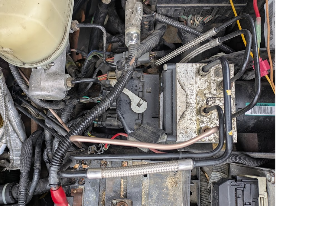

It's done. It's not pretty but it works. I got the bends close enough on the first try that I didn't have to redo it, so I consider that a win.
It was 2 different flares & fittings:
DIN/ISO Bubble Flare at ABS module (re-used the fitting from the broken tube because the kit I got didn't have that size)
45 deg SAE/Double Flare at wheel (used a new fitting)
