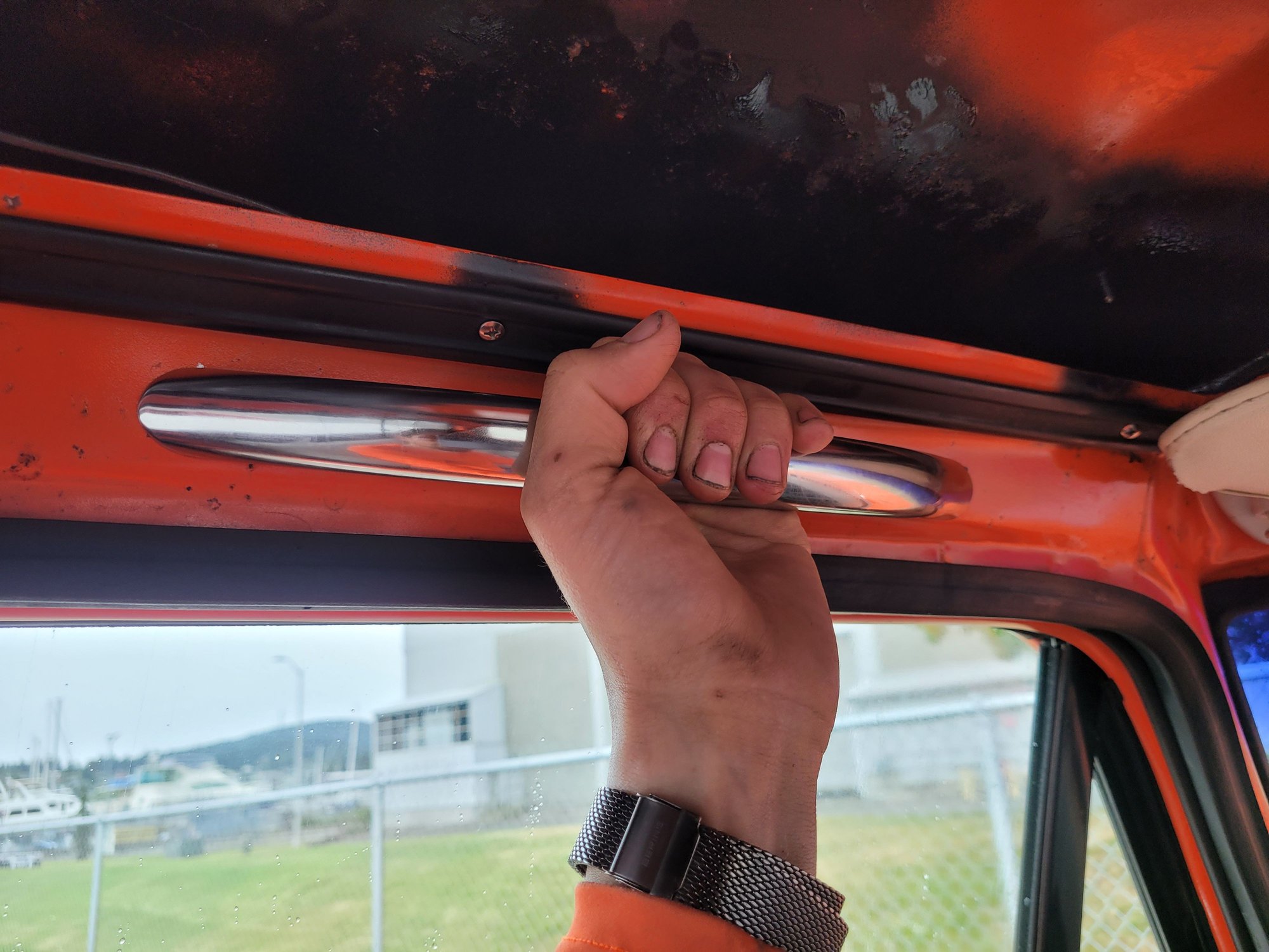

On a previous thread I had shared pictures of the overheard oh ***** handles I installed above the doors. I was actually considering doing something similar to the jeep but with the same style as my overhead ones but obviously longer lengths.
Wouldn't take more than an hour to install each one once correct product is found and would match handles, stay classy AND utilitarian I think.

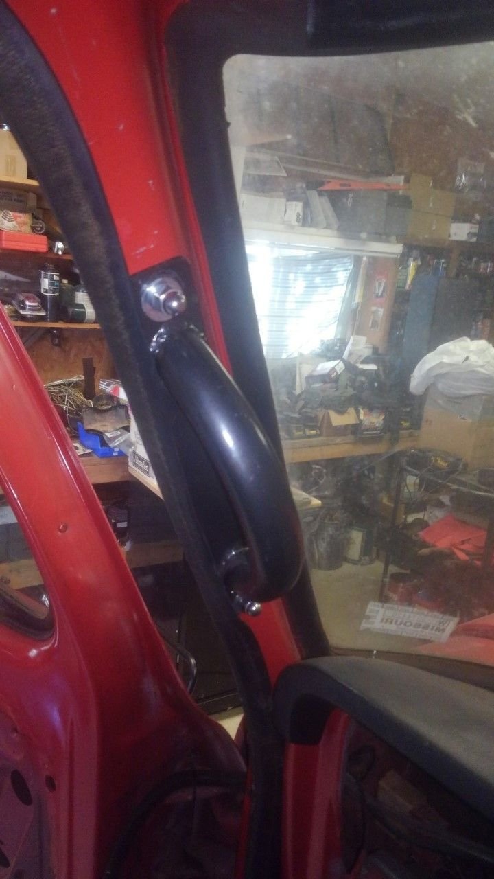

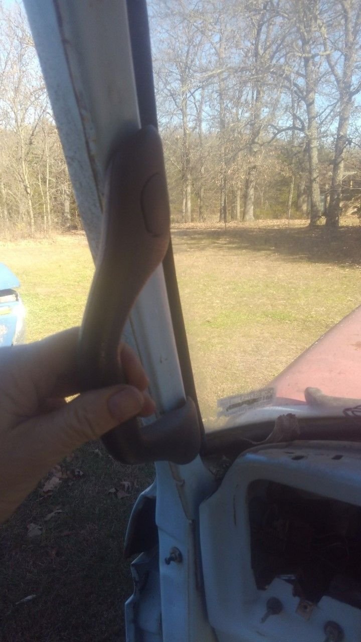

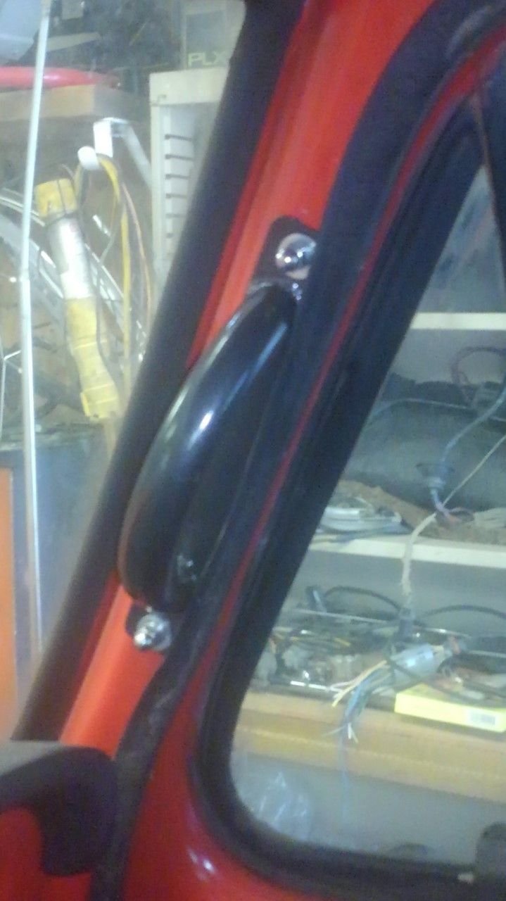

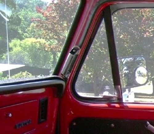

A fellow FTE member made these for me, out of plate steel and d/s safety loop material.
Carriage bolt head almost flush mount. Also almost flush with the pinch seam edge. Does not roll the pinch seam or compromise the integrity of the A pillar.
My left hand will also fit thru the gap to climb in that way.

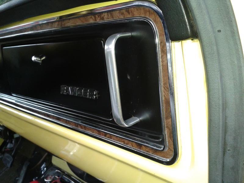

Can not remember what these came off of, some Ford in the JY. Were mounted with a nut sert and torx head screw. Could do the carriage bolt set up I recon.
FTE member idea, probable need HD'er handle , HD hdwr and reinforce that back side of the dash. But a good idea if you do not have a/c vent there.

I know my wife would love a handle on the A pilar when getting in the truck.
I also know of the nuts on wire as my frame mounted hitch uses them on the cross bar. Again there is no openings like yours.

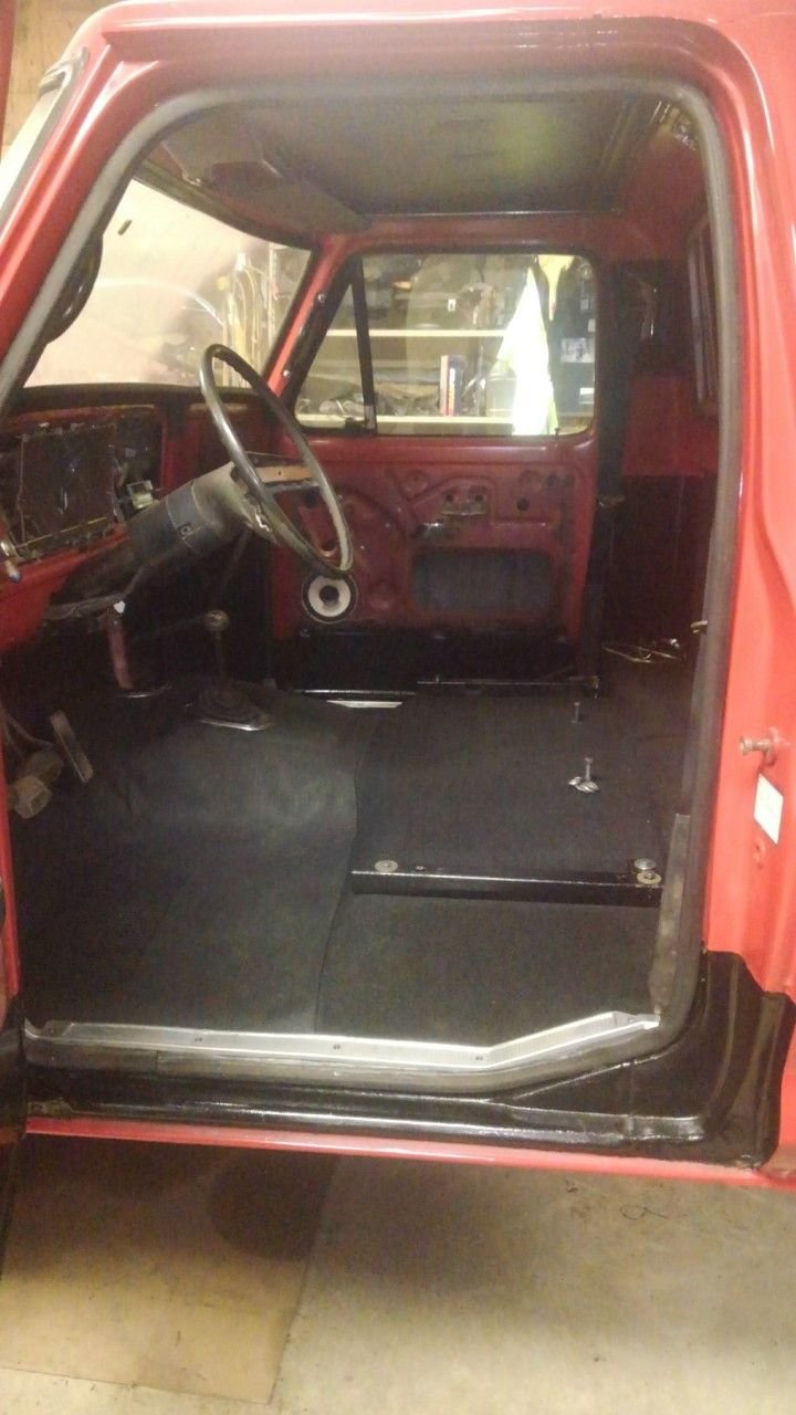

Only picture I have
Dave ----

Yes without the open headliner access to the inner skin pretty hard to put one up top on the newer rigs. And then all that plastic dash stuff. And the plastic A pillar cover hard for a guy to get a handle in their any where. What about grafting a 2004-2008 A pillar handle and cover all in one set up, over to the 80's stuff?

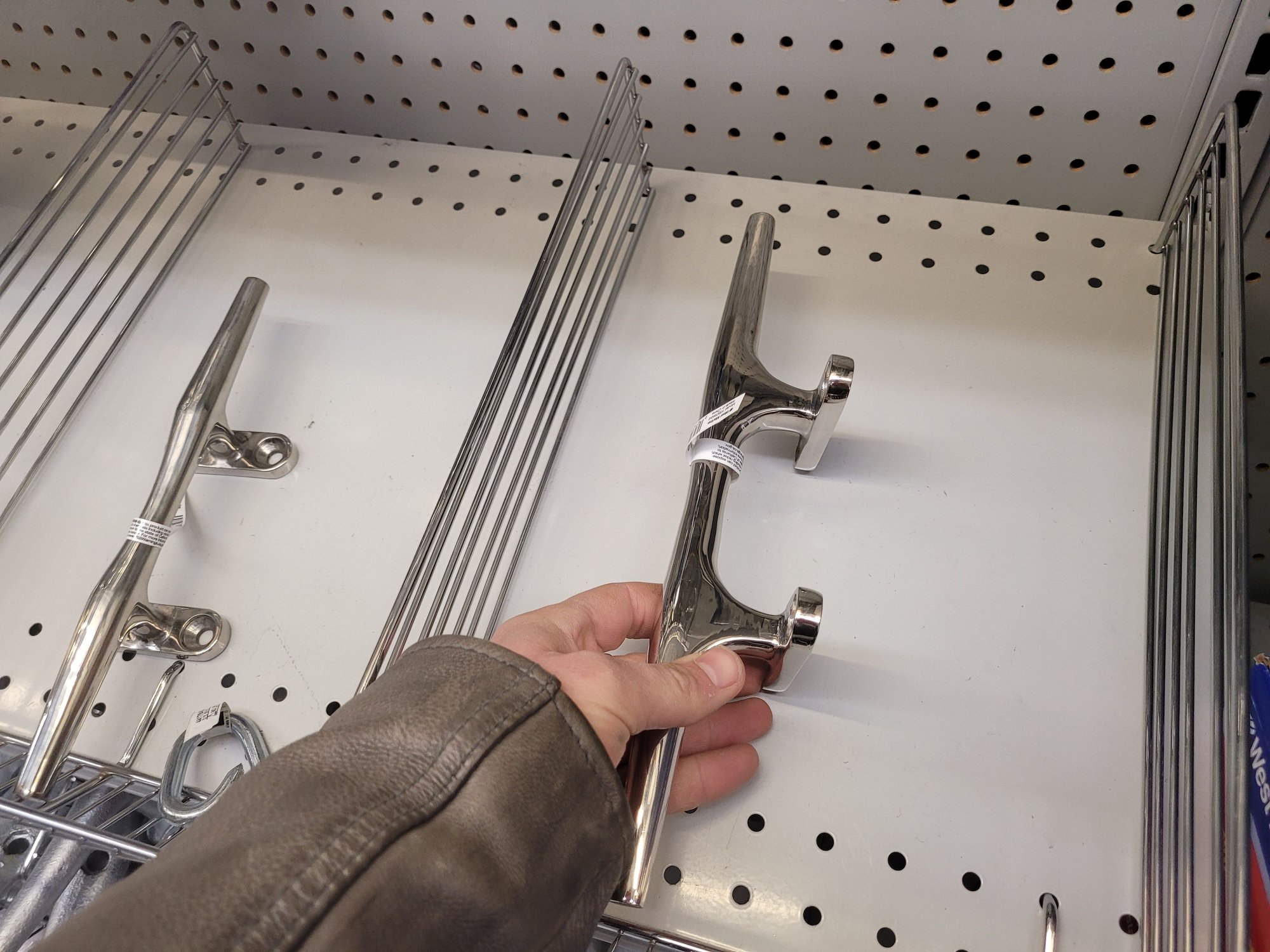

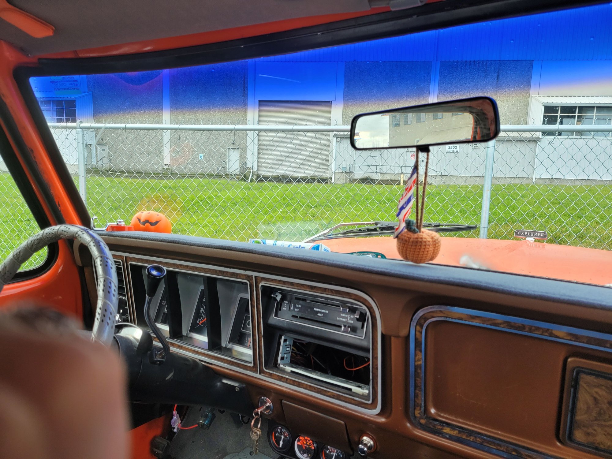

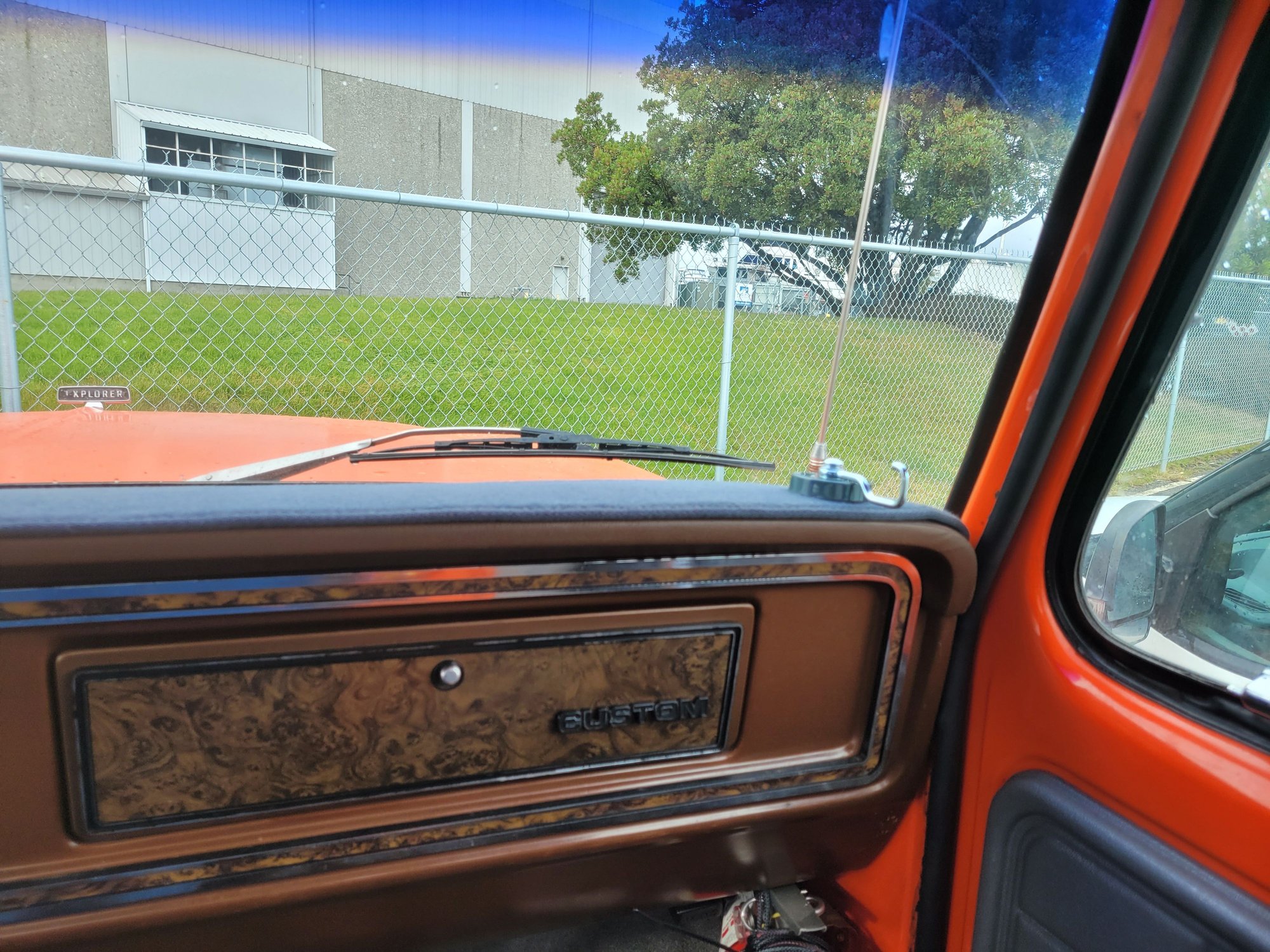

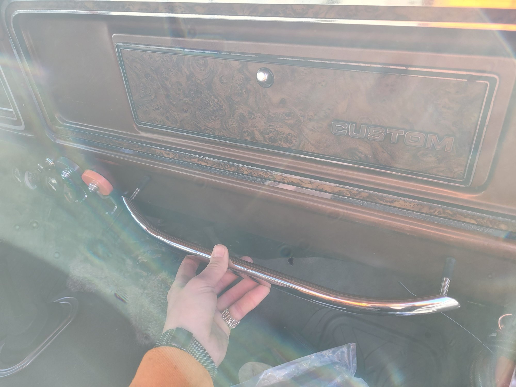

So here is where my brain is at. Took some measurements and a gander at the hardware at the marine store.
Use orange and grey magnets for photo references.
Picture 1. Ideal spot would be here but the glove box door is going to be obstructed unless you had an offset the length of the door so that is a no go.
Picture 2. Not much better due to the bezel trim and the bar may be too big on the raised area under the trim. Would have to cut or remove trim. Don't think this will work either.
Picture 3. Only issue here is grab bar would be angled down slightly but the readily available 24" at my local marine store would probably fit here really nicely. I may purchase the 18" and the 24" so see which I like better and return the one not used.
Pictures 4&5. Max usable dash length roughly 57" I believe. Ideally the bar would have low rise/offset and span 90% of the dash. May have to search online, make my own or search the boat junkyard.
Pictures 6,7&8. Hardware at the store for ideas and reference.

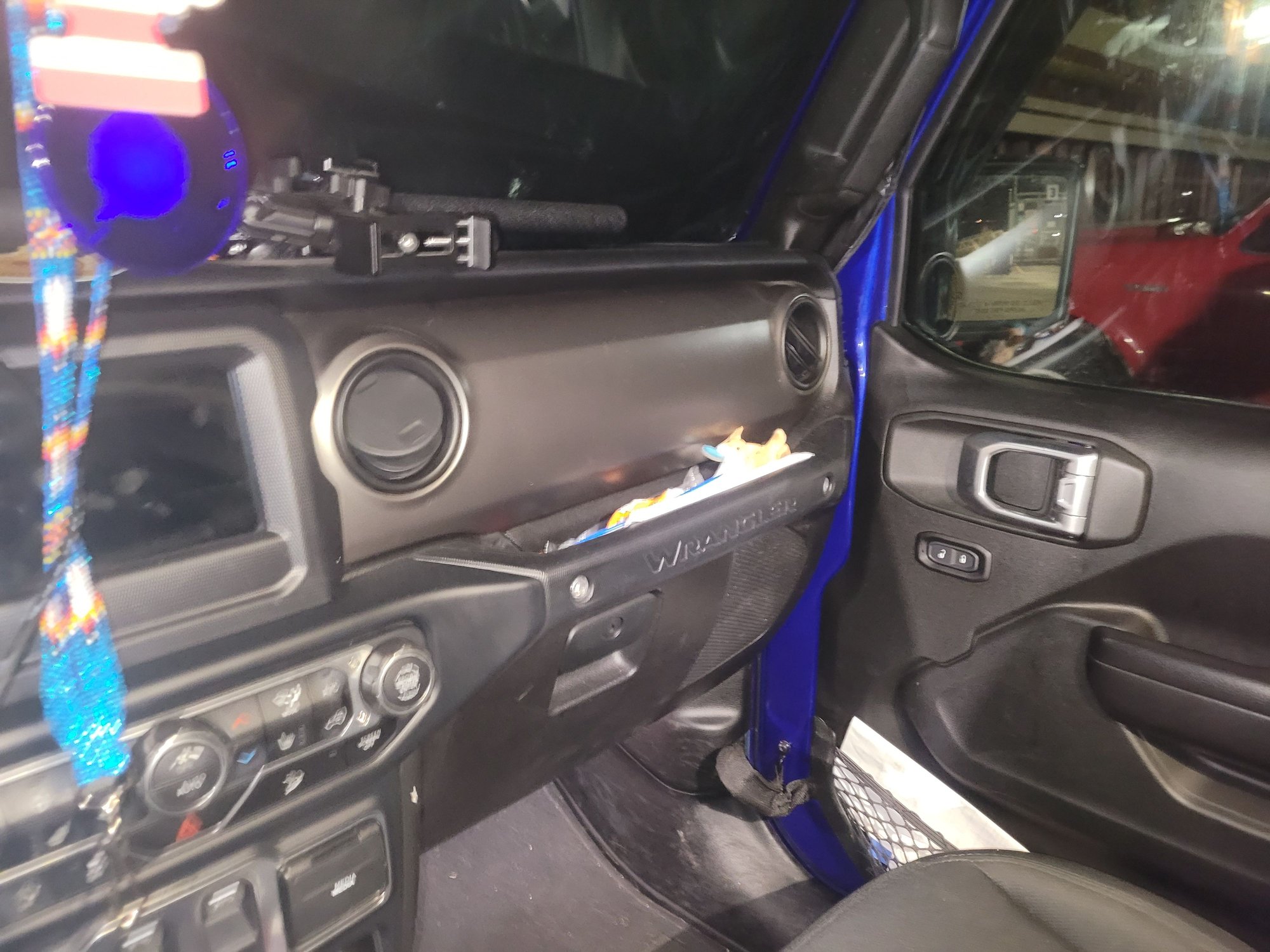

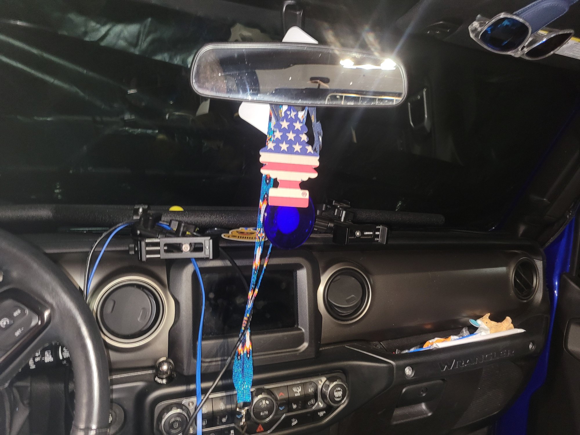

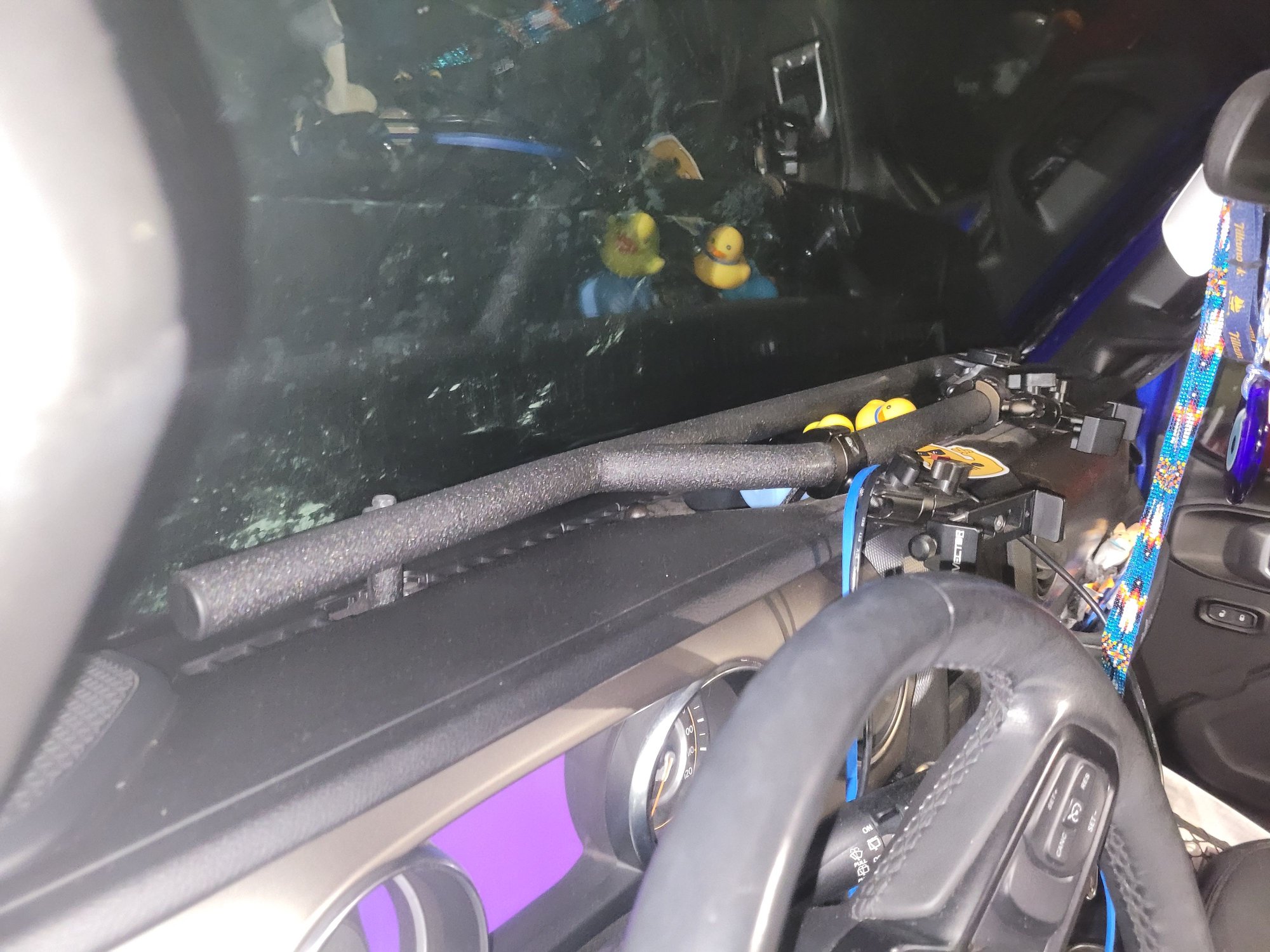

Sorry for the bad lighting and clutter but the pictures show the setup in our Jeep.
The jeep came with the glove box handle from the factory which we have found useful.
Last year my wife bought that premade bar that bolts into the dash easy peasy. I wish she got it years ago because it has been handy for our phones, Garmin 64 and gopro. We are considering getting the insta360 camera next.

After talking with the wife and my buddy in order to keep it asethetically pleasing and the lines correct we have deceided 18" center on glove box button.
I will probably wait till next weekend to install so my brain can process the information.
We have deceided to forgo the dash bar option as it would be too difficult to find the appropriate bar and would be "Too much".

Interior handle placement looks good, don't forget to reinforce behind the dash.
Do not put handles on the outside of the B pillars, you're just asking for a rust problems at the attachment points and down in the cab corners.
B pillar handles do look good though...
Yup mending braces behind the dash. Will take me an hour of measuring and paranoia and then probably 10 minutes to install. 👨‍🔧
