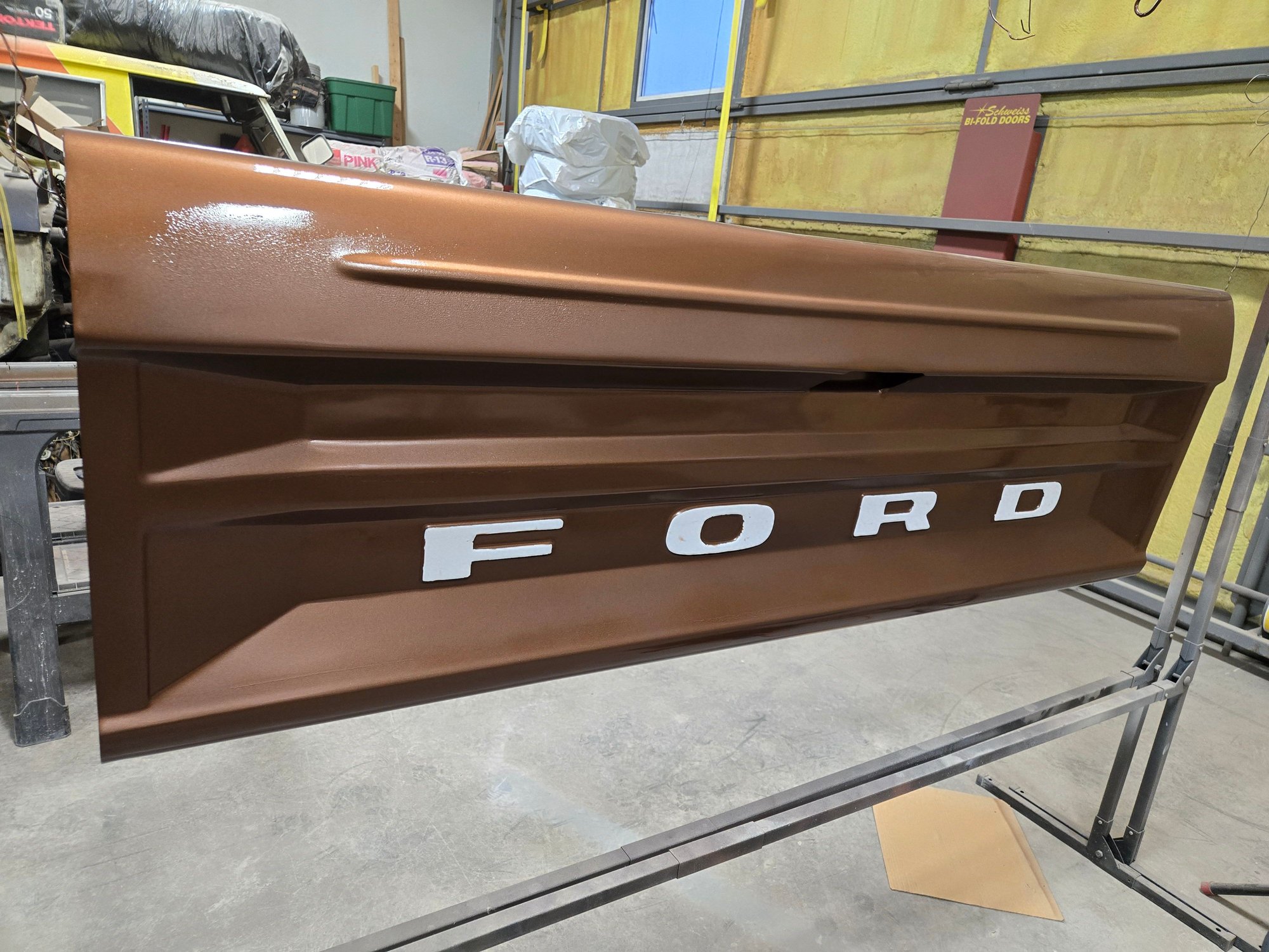

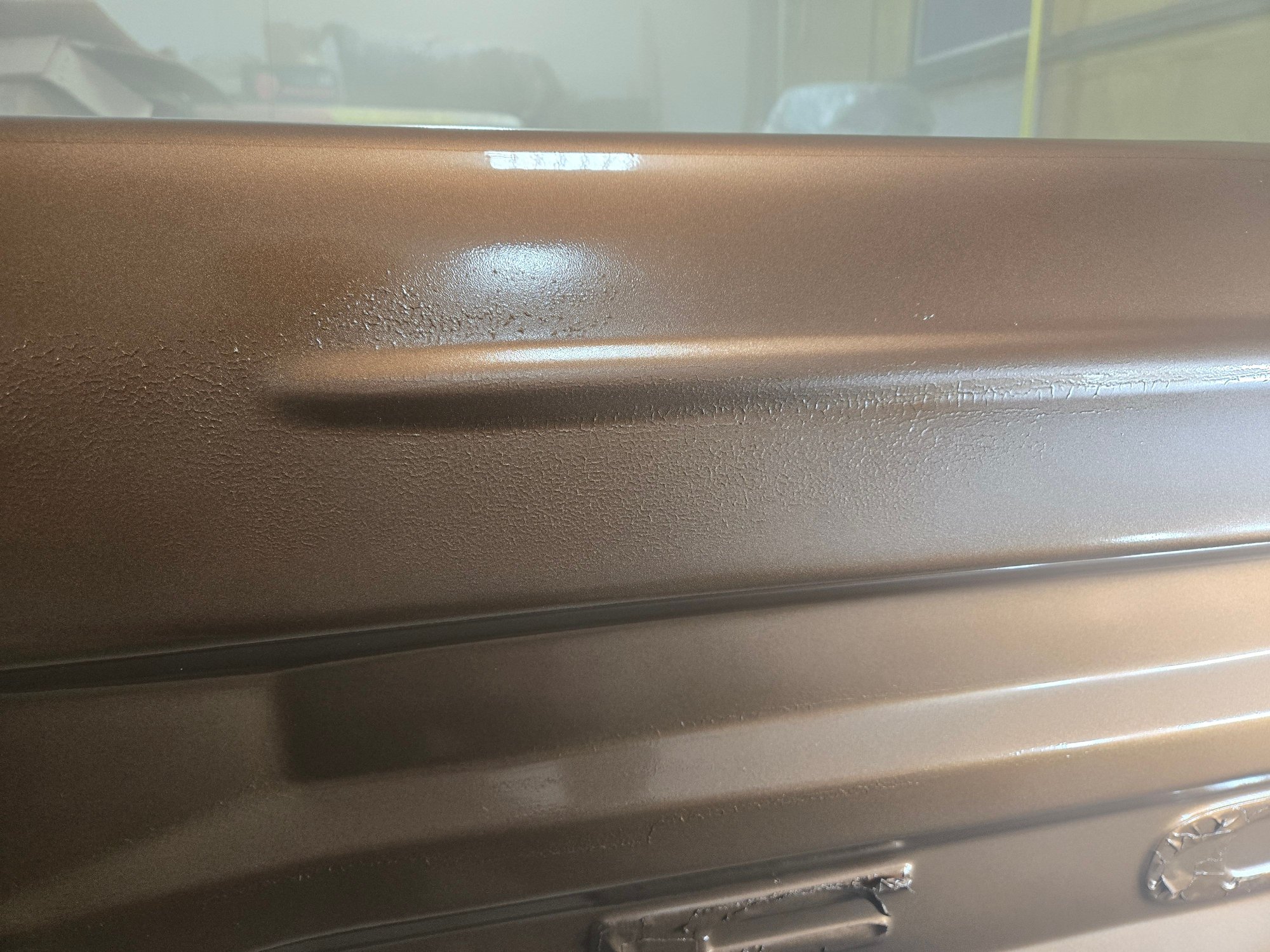

I am not sure what I've done wrong on my tailgate. Originally I painted it with the ginger glow Omni base about 6 months ago, then it sat awhile while I tried to figure out how to paint the ford letters. Finally decided to sand the ford letters down a little and then sprayed a white omni 2 part epoxy on the letters. So far so good. I taped the letters and then sprayed the omni base on the whole tailgate. The paint started popping or peeling up where it was originally painted. So I let it dry, and sanded down the whole thing (except for the letter area, which was good where the omni epoxy was. Everything looked good, I clean really well with silicone and wax remover and tack cloths. And it did the same thing.
I was spraying the bed at the same time, and have no problems there, so it don't think it is the paint mixing or combination of epoxy and base layers.
This is the omni base, sprayed iver older omni base, it is not laying down nice
This is the omni base, sprayed over older omni base. Ignore the color difference, that was due to the white epoxy under, and i didn't do enough coats of color as it started peeling.
Secomd attempt, and it is still peeling up.
I'm guessing that i have some contaminant on there, but what it is and how do i get rid of it?  I fairly bummed out, as this was the last piece i had to paint, and now im out of my base color, so I'll have to buy more just for the tailgate.....

That condition of your paint is the existing paint "reflowing". Trying to turn into a liquid again in a sense. Let me ask a few questions and I think I can help you with an answer.
_ Originally painted the tailgate with Omni base you state 6 months ago. Is that a base coat /clear coat? Meaning 2 stage (a ginger base coat color THEN clear coat)?
- Letters sanded & painted white (6 months later ,no problem). Did you paint MORE than the letters with the white? As you say there is "white" on the rest of the tailgate that hasn't been covered yet with the new, final ginger glow paint if I understand correctly.
- If you did cover the entire tailgate with the white while painting the letters, then eventually masking the letters,THEN your final painting of color; the white is "reflowing" from the new top final gingerr coat.
-If this is the case .The reason is the coat that is wrinkling/reflowing has not cured. ;

Not fisheye. fisheye is cause by the paint pulling back from silicone or another contaminant. this is wrinkle paint and it caused by a chemical reaction lifting the material under it. same as spraying lacquer over enamel.

Absolutely NOT fish eye. Do not chase a fish eye repair. Where the original paint has "lifted " like that, it is a sanding back down, USUALLY a SEALER in light coats, longer wait times between coats and eventually , after setting/curing for a day or two, start with light color coats again. good luck

Thanks for all the advice. At this point I will just take the whole thing back down to the epoxy primer. Do I need to remove any body filler also?
For some of the queations, it is Omni epoxy and base and using ppg DCU2042 clear coat. When it started popping, there was no clear on it yet. I used all the same system, at the exact same time on the bed. Today I got a good look at the bed , and other than a couple dust nibs, it looks great

I think you had some white overspray on the gate from when you sprayed the letters. You can see a what looks like a clean tape line in the wrinkled paint in your first picture. When you sprayed more Omni base on the gate, it reacted with the white epoxy overspray.
I'd strip the gate all the way down & start over. Yes, you may be able to sand to primer & get away with it. But, since you've already had problems, I'd want to start over.
If you decide to spray the letters again, make sure you mask the entire gate so no white can possibly get thru to the base.
