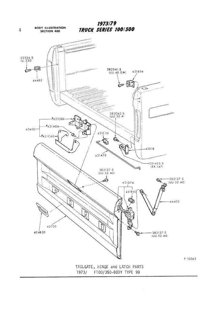

#43018 is what you are looking for, I think repops are out there. If not, remove the bracket, drill out the broke bolt, retap the threads and go from there.

That part shown on the diagram is the actual hinge.i haven’t been able to get the bracket out to attempt to get the bolts free. I’ll see about posting some pictures tomorrow.

Those diagrams are here, along with many more common ones we use alot.. https://www.ford-trucks.com/forums/1...then-some.html Feel free to copy into your very one PC/laptop library.
They came from a Ford Master Parts and Accessories Catalog. Like https://diyrepairmanuals.com/product...YaAt0YEALw_wcB

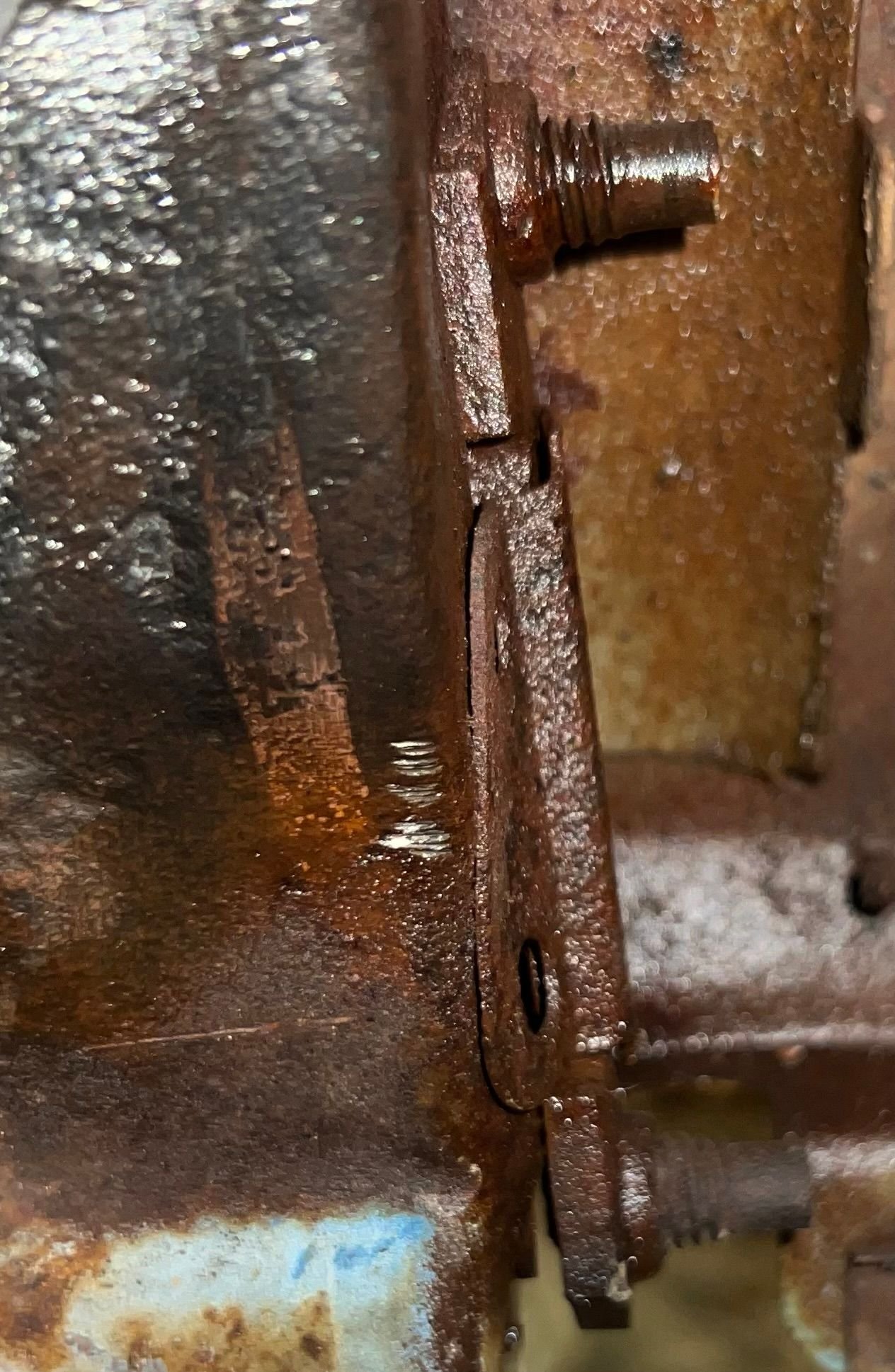

Was just able to get a pic of the bracket that the hinge bolts into. This is looking from the cab side of the bed where the crossmember will be inserted when the bed floor is welded in. Above that bracket is the taillight assembly. You can see the broken bolt at the bottom of the image the other one is rusted and seized. The bracket is held in place by the metal piece that is centered in the bracket. That piece is welded onto the bed. (The picture was taken in that area where the cross member will be sitting when welded in place. I can’t get a saw in there or any tools to dislodge that bracket.)

I bet since the bottom bolt is broke you might try to come up from under and go in between the bracket (that the bolts go thru). with a sturdy pry bar. And try and pry the bottom enough to break loose the middle bracket retaining strap. Probable going to have to rip the head of the seized bolt out. Might end up having to nut and bolt the bracket back on. Tricky spot to work in for sure.

Thanks for the input, I’ll see if I can get to it from below, thinking I might have to drill out the spot welds holding that strap on and move forward from there. I’ll let yall know how progress goes
