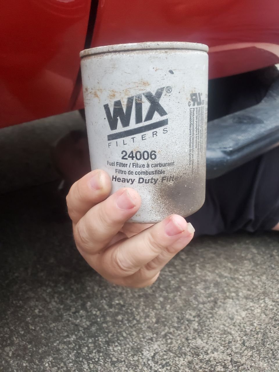

at a minimum,
I would install a big low micron fuel filter.
I am using a big Wix 24006, it is 10 microns, and will flow 15 gallons per minute.
mine was installed 20+ years ago by a Fire Department down in south Texas,
when I checked the fuel bowl, it was as clean as new, the filter element looked new.... and the cap had not been off in years, we had to chisel it off, it would not unscrew.... a big Monkey tightened it up beyond belief.
