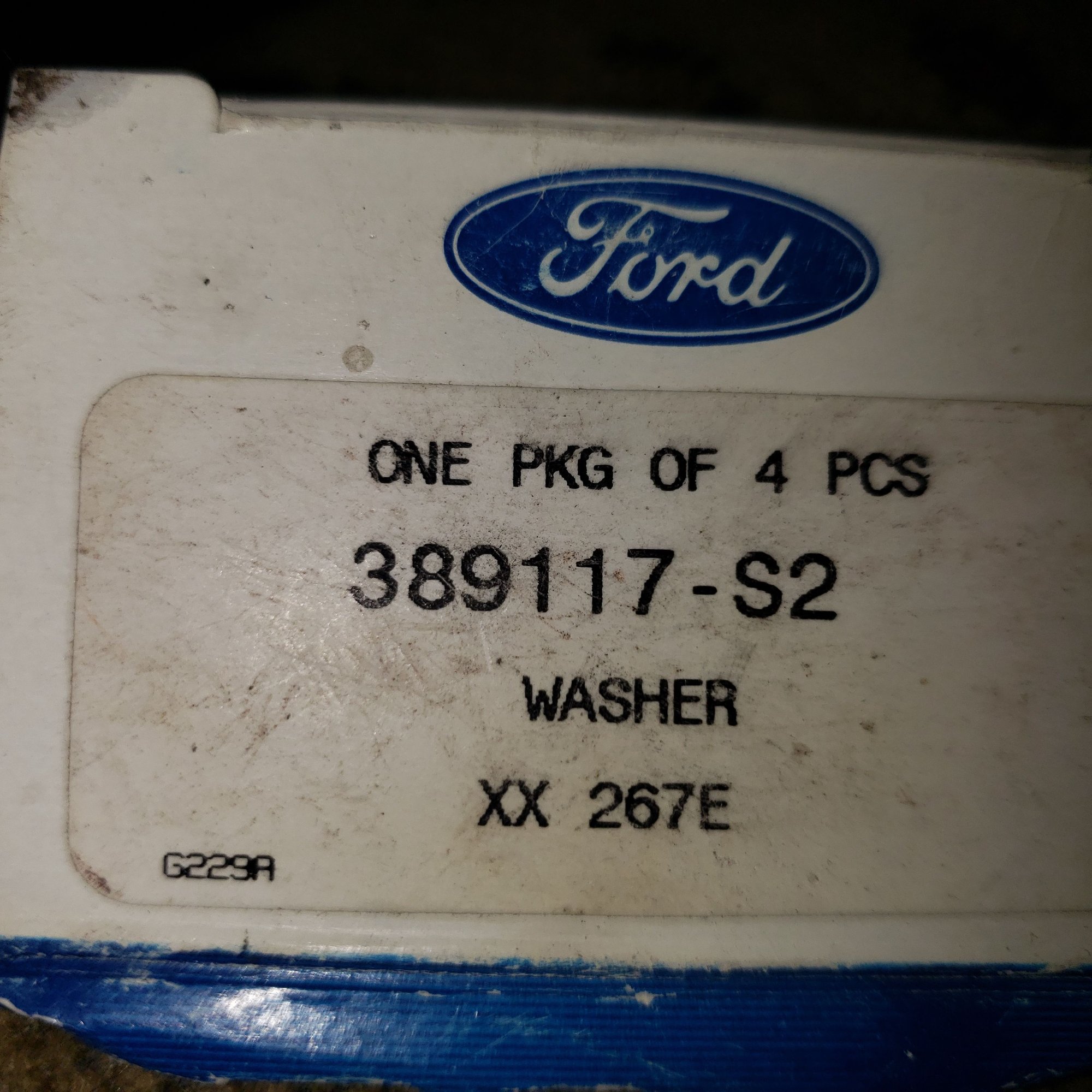

These are the factory Ford big washers
Hard to find these days but Ebay had some last I checked
All they are is 1/4 inch thick plate washers that have a rather large I/D and a rather small O/D
Good luck
