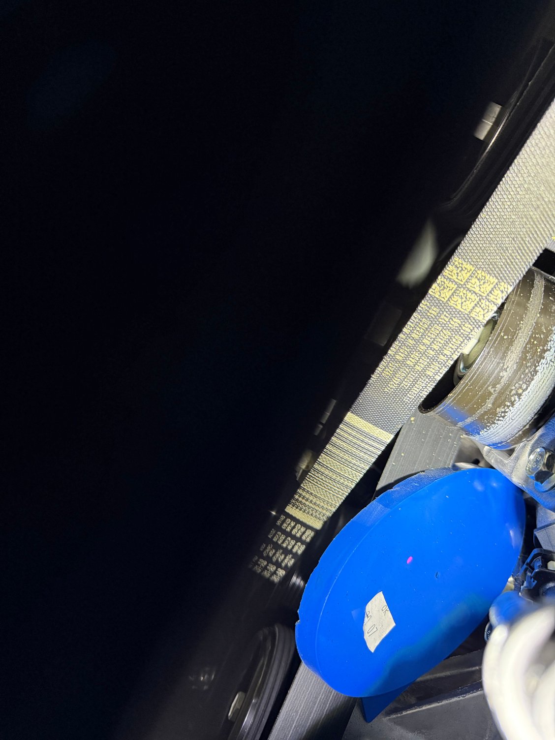

I had this on my brand new 6.7 HO. While driving no smell but at idle a burning smell coming in through the vents at stoplights or sitting in a parking lot.
Took the truck to the dealer and they found a intake manifold cap rubbing against the belt
Looks like it left the factory this way
Picture attached - from this thread, maybe it's not just my truck?
